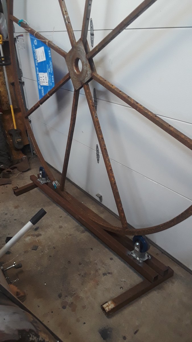

    Gathered up some steel and a couple of casters and started working on the rotisserie today. I need to grab some smaller casters tomorrow and get some wheels under the framework so I can roll the thing around. In this picture, I just have it sitting on some square tubing to elevate it a bit. I will weld some tubing perpendicular on the ends of the base and mount the casters to that. The metal reel spins extremely easy on those blue casters. 20200104_203854.jpg

    I removed 4 of the spokes in the reel ends to facilitate access. Still plenty strong.

    I just built in lots of adjustment. But I did my 47 coupe first. Balance point was much lower than for the 55 wagon. I had to cut where the body bar welds to the hoop off and raise it 12 inches. The coupe sits about 10" higher than the wagon. I'd guess your sedan delivery would mount close to where I did the wagon mounts.

    17" from outside of hoop to the top of the bar that goes across the hoop and the body hooks on to.

    More work on the rotisserie yesterday and today. Ive got the basics done, now I need to get the mounting figured out. I think I will work on getting the body off the frame next. I can then start figuring out how best to mount the body.

    Lucky you. Your hoops are straight. lol Mine were a bit banged up and not straight. Nice.

    I've been working on the project here and there, and have made some progress. Finally rolled it over on the rotisserie today. Thanks again @casper50 for the inspiration! I need to fine tune the adjustments but it should come together nicely!:cool:

    It will make life much easier. Can't do without mine. Once you find the wire reel it's a pretty easy cheap build.
