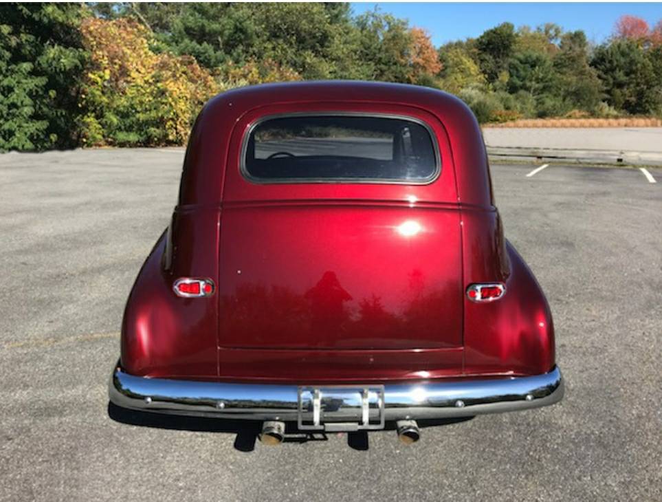

    How about the same-year Chevy sedan/coupe taillights, but turned 90° and mounted higher on the body? Screenshot_20200826-132352_Outlook.jpeg

    ^^^ That's interesting....I have some 52 tail lights in my stash of pulled parts from the parts cars Ive gathered over the past 4.5 years.....

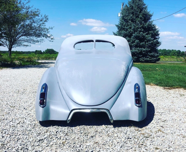

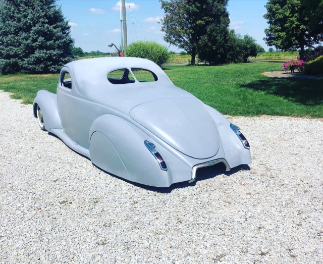

    Those are late 40’s Cadillac DC2DFCD2-D2F8-437D-88A6-416CD6608F68.jpeg 0DC3762D-9704-4D9E-976A-E29C8DF04830.jpeg

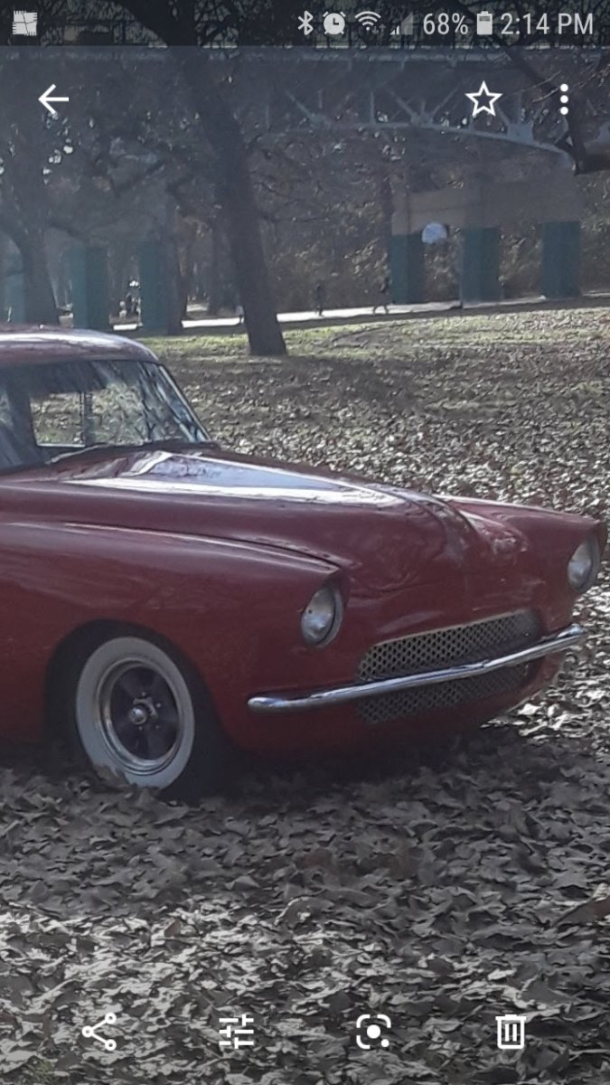

    Just doing some spitballing. I know I'm jumping all over the place but I'm using this as a journal of sorts. I saw this car and really liked the headlight treatment, and the rolled pan under the bumper on this car. It goes along with the smooth look I'm after. I think the guy told me that the bumper was off a Corvair and it seems the headlight treatment was from a Ford Thunderbird. It was about a year ago so I forget to be honest. Screenshot_20200826-141404_Photos.jpg

    To put it in perspective.....

  7. The grill mesh is 58 Ford car. The headlight look 57 Bird but those are Pot Metal and can' be welded in place.
