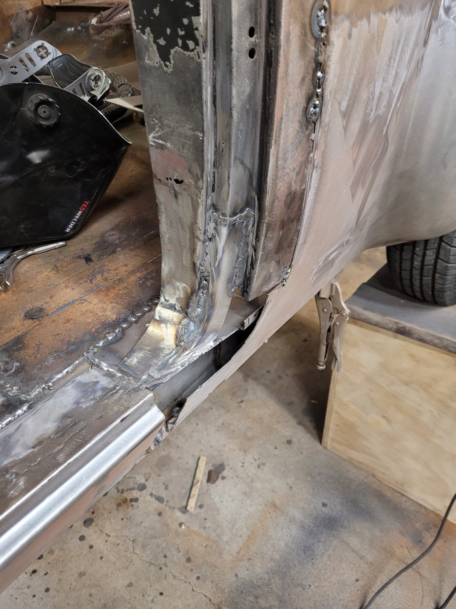

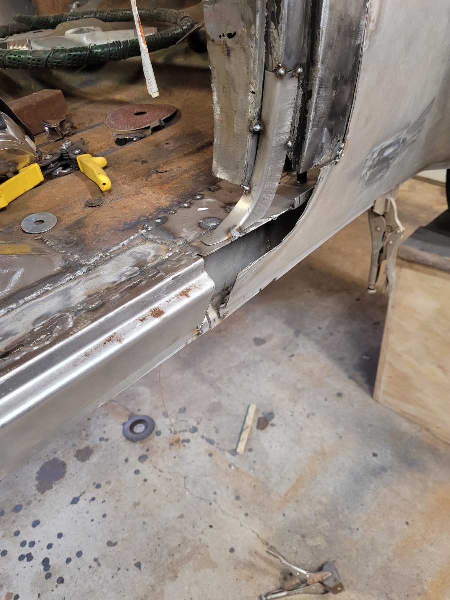

    Working on tieing the door jambs into the floor boards. The door jamb profiles on the new quarters weren't exactly right, and there was so much deterioration at the bottom of the jambs I just decided to make new pieces. Shrinker/stretcher came in handy for this. Really slow tedious work but just about have it looking decent.

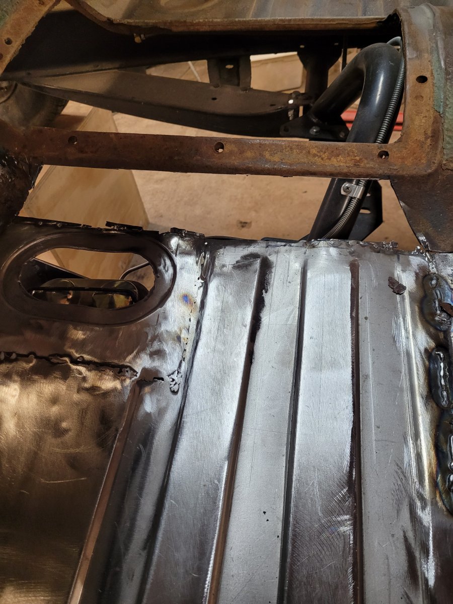

    The drivers floorboard is progressing nicely I think. It was a bit worse than I originally thought but nothing that can't be fixed. I could have ordered a replacement floor pan, but for what it would have cost, I was able to buy a bead roller and motorized it. It does a decent job, and learning a new skill. This car will be far from show quality but it will be solid. The original Sedan Delivery will be a lot better by virtue of the experience I am getting piecing this bucket o' rust back together. I've made some mistakes, let a couple of areas get away from me, but trying to fix them isn't going to get me on the road and they are purely cosmetic.
    20210221_092650.jpg 20210221_092739.jpg 20210221_193747.jpg 20210221_194345.jpg

    Always good to be learning new skills. I’d rather buy tools and make something than buy parts, too.
