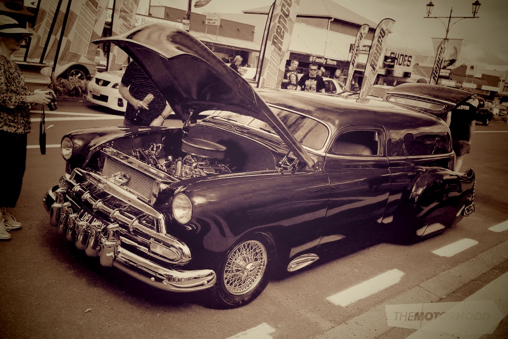

    Here's a later model SD, from Australia for inspiration
    Outback, VANDENPLAS, koolkemp and 2 others like this.
