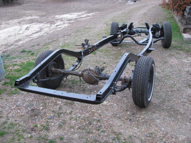

  14. I have to be honest in that I haven't been following along full time latley. Maybe you have already covered this as to the why or how. In this photo I see what looks like exhaust hangers that are mounted sideways. Is this some new Trick system or is there more to it I just don't, see? Exhaust that I'm used to seldom needs lateral control, it's generally about support the weight from giving into Gravity. The warehouse calls them "Exhaust Hangers" for a reason. Also, I see the cables for the E-Brake coming out the backing plate facing the rear and a loop taking it back forward. I already know how that works out when you pull the handle, and the inner wants to get into a strait forward pull. You got something going on there I don't understand? The way I cured my issue was to make a very stable guide to anchor the outer jacket so it actually worked. Curious minds just want to know.
    Dick Stevens likes this.
  15. RMONTY
    Joined: Jan 7, 2016
    Posts: 2,664
    RMONTY
    That picture was taken before I made the guy redo the exhaust. He had it all jacked up. I was really disappointed in the job he did originally. To be honest, I am not sure if that
    "hanger" is still there or not. If it is, it will be removed and proper "hangers" will be installed when I can get to it. On the few shakedown runs we have made with the car, the exhaust just sounded bad***, and didn't fall out in the road. There are other hangers supporting the exhaust.
    As far as the parking brake goes, I haven't gotten that totally sorted out. It is a work in progress. I'm sure once I get some of the hundreds of other things done, I am sure I will get the outer jacket secured to stabilize the cable. Thanks for the heads up!
    drdave and alanp561 like this.
  16. Glad you're making progress. As for E-Brake it looks to me maybe the backing plates (or at least 1) is on the wrong side. If so, maybe just swapping them will help you out in the long run. You can of course keep working with what you have. Here is one way to resolve the cable draw you have going on. This is the system in my 32 and I specifically wanted to use the handle you see and have it mounted as is. To do this the left cable needed to cross over to the right and both be a "direct pull". This is nothing new as for the design and how it works, just adapted to do the job I needed. Ultimately you need both cables to draw the shoes tight at the same time. If the cable jacket can draw at all that won't happen, and you only have one side doing its job.
    The photo above looks simple in itself. To get there I used a piece of heavy wall hydraulic tubing and crossed the left over to the right through it. Ford actually made a version of this in the 60's and I just pirated it and made it work for me. I've done several versions over the years. Hope this helps a little. Keep making progress pal.

    Thanks Mike! Really great explanation of things. Here is a photo of the cable system I used. It's kinda hard to see, and I just had it clamped on at the time. It looks almost like the one you are using.
    As far as the cable coming out of the rear of the backing plate, that is how that rear end came. It is out of an S10 and I don't think I can turn it around facing forward if I remember right. That photo was taken in February of 2017. I will try to snap one next time I crawl under the car. I like the bracket you made to hold the cables. I am sure I can make something similar, but it just hasn't been a priority.

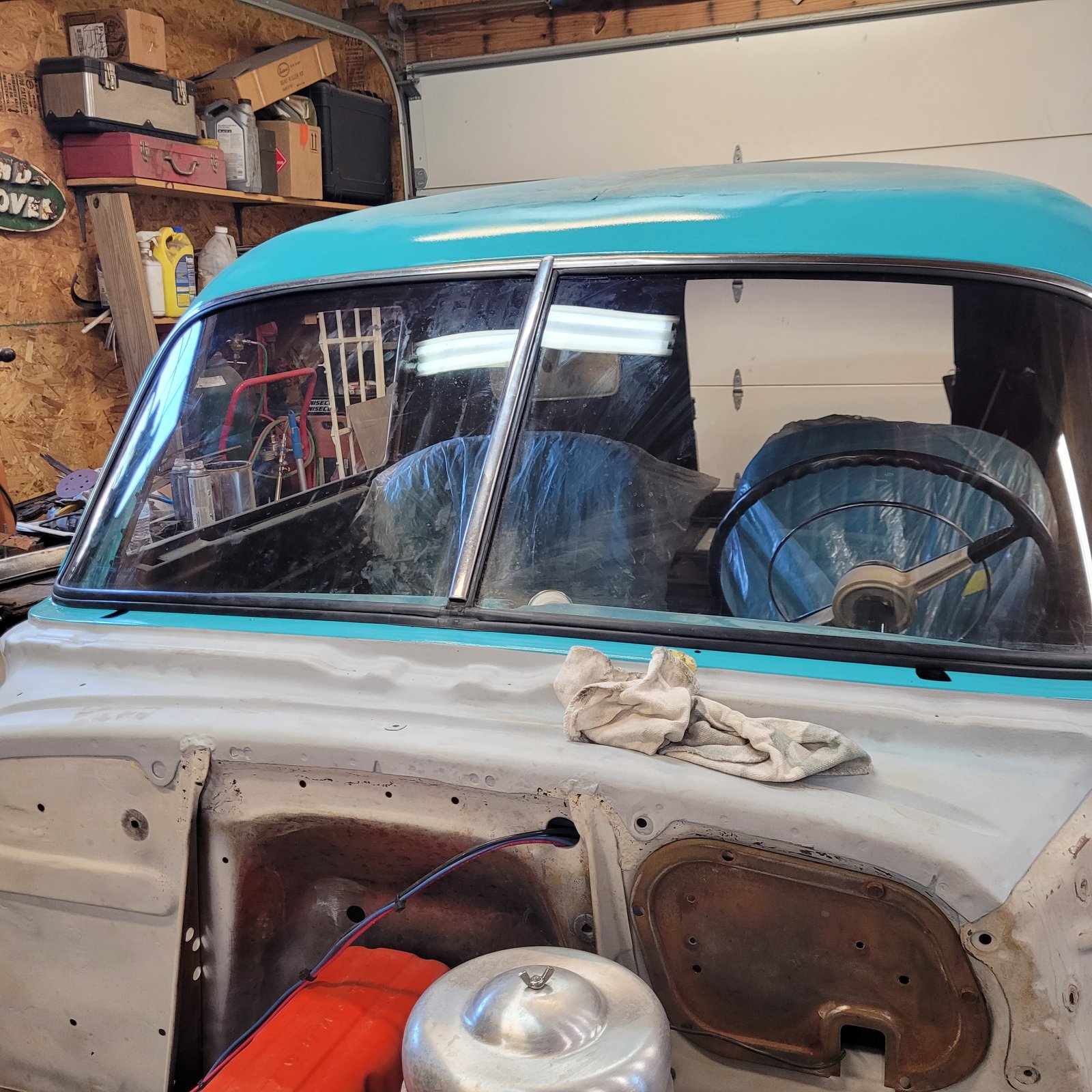

    Trevor and @Lone Star Mopar came over today and helped get my new radiator installed, and then we put in the windshield and stainless trim. Took awhile to get the gasket manipulated over the center bar of the windshield but when we did, the stainless trim layed down and everything sort of (it was a *****!) went into place. Windshield looks good! Starting to work on the door gl*** and vent windows next.
    Thanks for the help guys!

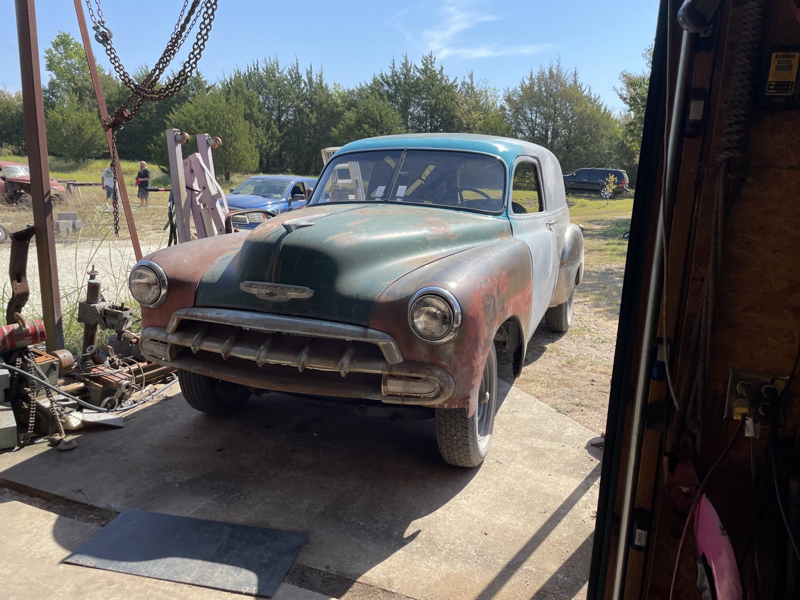

    I have been stalled out several times and overwhelmed more than several times but it is starting to pay off. The little 5 or 6 mile trip we took on Sunday was the christening run of the old car. No bottle of champagne to break over the hood, because I spent too much on parts and couldn't afford the champagne! Oh yeah, the hood isn't on it yet either., there is THAT! The photo that Trevor posted was just a test fit of the hood to see if the new radiator had clearance after we "adjusted" the brace on the bottom side of the hood.

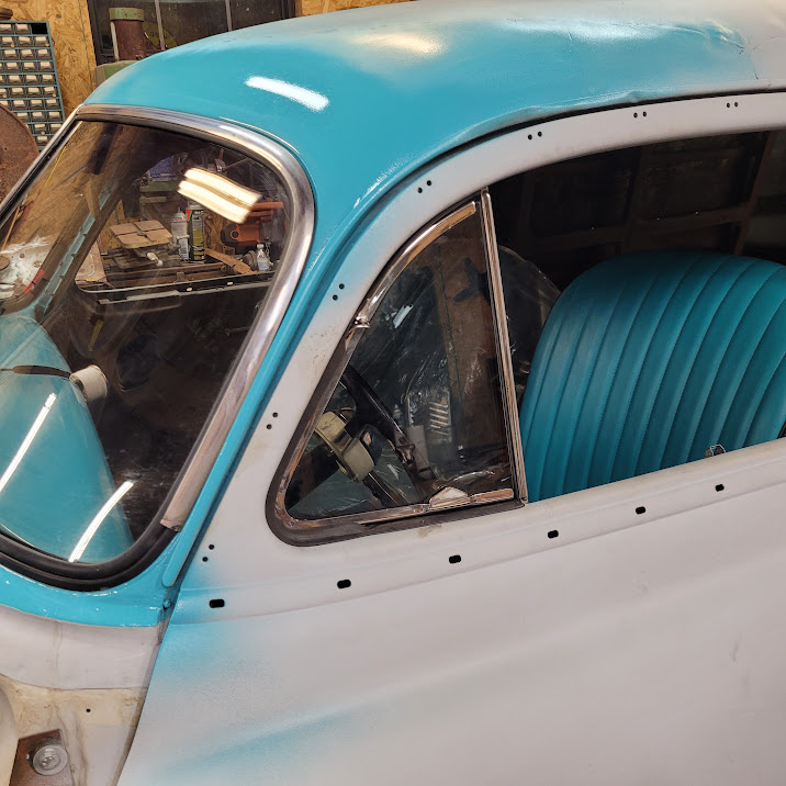

    The windshield is in but it wasn't without running into a couple of issues. Its all been sorted out though! Thanks for the pep talk and advice last weekend, it contributed to the ultimate success of the installation! I am waiting on the door regulators to get finished soaking on the citric acid bath, and then the window gl*** goes in. I already have the vent windows rebuilt with new gaskets and gl***. They turned out nice!
