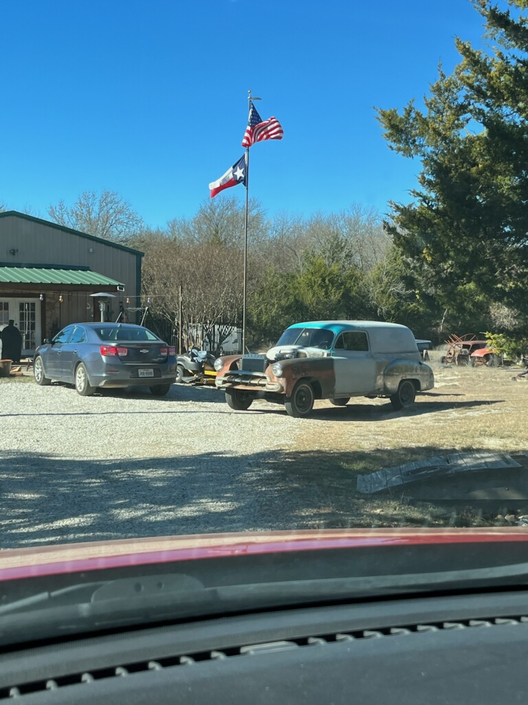

    To preface this post, last weekend Trevor came over and we took the carbs off the car, as it was running ****py, like it didn't want to accelerate. We dis***embled them and blew them out, used some choke and carb cleaner in the p***ages, re-***embled them and went for a drive. She was running like a hopped up sewing machine after we did all that.
    So.....with the new door on the car, I am about to go out on a little cruise, as I am going to start making longer and longer runs with the car to build some confidence in my work. The plan is to take it to the LSRU in April, and I think I am finally going to make the Stray Kat 500 after many years of saying.."Next Year!" imagejpeg_0(34).jpg
    Okie Pete, brEad, Budget36 and 7 others like this.
