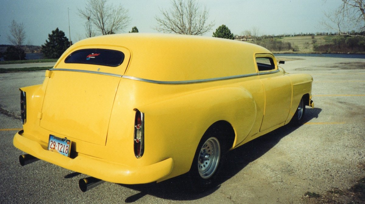

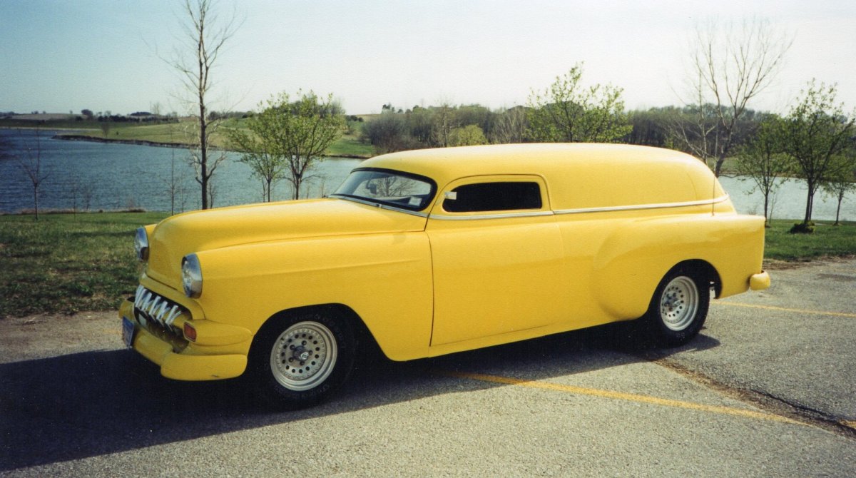

    my former car, 54 Chev sedan delivery, chopped 6", Buick Grand Nat'l V6 turbo drivetrain, 59 Plymouth taillights img020.jpg img019.jpg

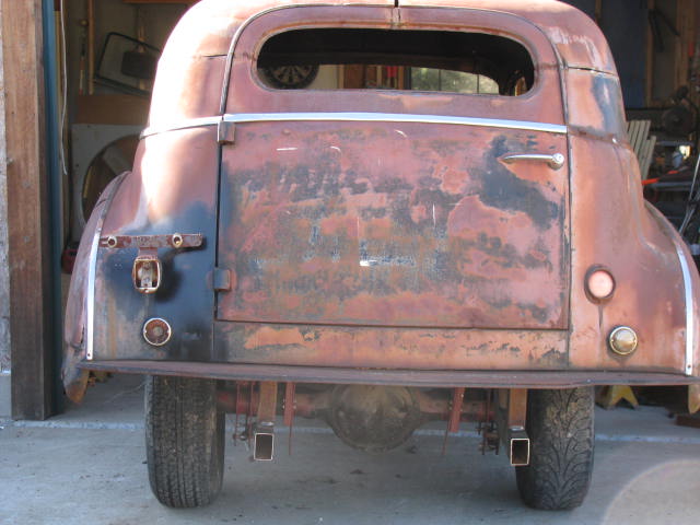

    Got a few things done today. Took the day off from work, worked out in the shop and went and did a side job for some folding money. I did manage to get the delivery body raised off the franken-frame.
    I know it looks weird, but this is just to get the body up above the franken-frame frame rails, as mentioned before, someone before me had "tried" to channel the body over the frame.
    The pic above shows the shortened 9" rear end someone put under the delivery. It's just a shell of a rear end. No ring/pinion, etc. in it. It works fine for moving the car around, which I can do by myself since I am working alone.
    I should have taken some pictures of the gap on the rear door before I cut the body loose from franken-frame, but the rear door would not nearly come close to closing. At least now its almost normal.
    Here is a pic of what is left of the original floorboard just tacked back in to try to get the proper width started. Baby steps...

  4. RMONTY
    Joined: Jan 7, 2016
    Posts: 2,679
    RMONTY
    That was a nice looking ride.....sorry to hear she burned down! I think I read somewhere that it did....?

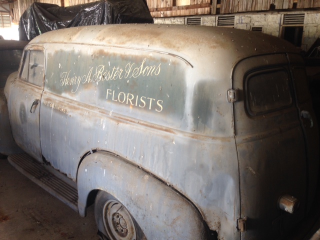

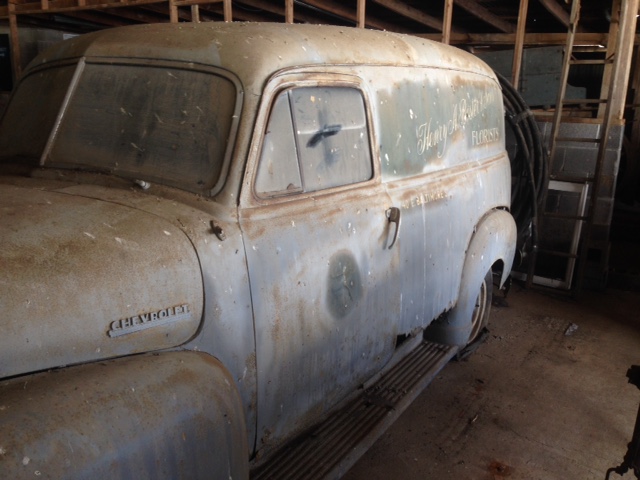

    Not sure what I am doing wrong here...I posted a similar vehicle seeking a value and don't get near the responses.
    If you missed it, I am considering this vehicle...what do you guys think?! This is the worst side...and it has a ***le.
  8. RMONTY
    Joined: Jan 7, 2016
    Posts: 2,679
    RMONTY
    Looks like a cool ol' truck to me! What year is it? Does it run? Is it pretty much complete mechanically? What are your plans for it? Looks like it has a split door in the rear?
    Thanks for posting the pics Dave!

  12. PatinaDave
    Joined: Jan 20, 2016
    Posts: 29
    PatinaDave
    It is a 51 Chevy...put in barn in '84 so thats the last year it ran...yes, split door in the rear...does that add to its value?
    I haven't made up my mind if I am buying it...but it seems to rare/special to p*** up.
  13. PatinaDave; What your dealing with is a Panel Truck not a Sedan Delivery. All Panel trucks have split or Dual back doors and are built on a Truck platform. They are not Rare at all. They were the commercial work horse of the times. A Sedan Delivery is built on a P***enger Car platform and all of them had a single back door. Far less of them built.
    The Wizzard
    verde742 likes this.

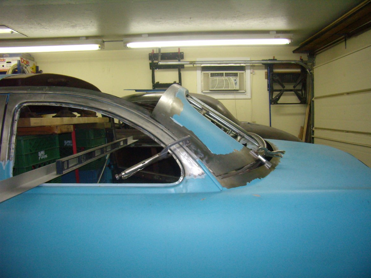

    1- I would first get the body mounted to the '52 frame, measure many times and places, square it up, brace it, make sure it is stable. Make sure all doors fit and open and close decently.
    2- Plan on using the '52 windshield frame, maybe the cowl and firewall too. Your pics of the delivery windshield frame suggest it's kinda cobbled, I doubt you'll get gl*** to fit it.

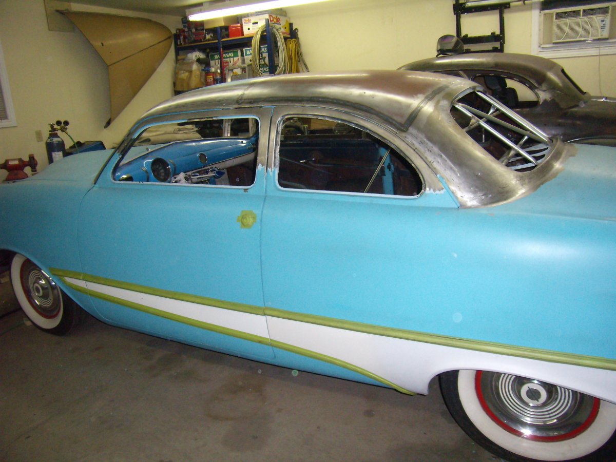

    3- I've attached some pics of a system I've used numerous times to support a top skin while mocking up/cutting/stretching/ tacking when doing a chop. A few simple screw jacks mounted atop a pile of milk crates/ planks/ whatever allows you to support the top skin and adjust the curvature till it looks right. The car pictured is a '49 Ford coupe that I chopped a couple years back, the rear half of the top skin is from a '50 four door donor. I this approach would help you get your delivery top back into shape. Good luck.

  16. 911 steve
    Joined: Nov 29, 2012
    Posts: 681
    911 steve
    from nebraska
    yes, fire in engine compartment. not too bad, but enough to total it. blessing in disguise. it gave me enough money to buy my real true love, a 40 ford sedan. the delivery has been rebuilt, I hear its somewhere in northern Iowa

    That is a great approach it looks like. I like the idea of being able to support the roof with the jacks and the wood. I might incorporate some of this strategy when the time comes! I appreciate the input halfdozen...
