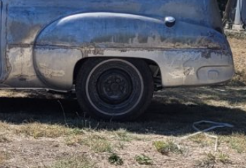

    Trying to get the stance right and I think we did. Trevor and Saul came over this morning and we installed a 2" lowering block kit on the rear. I'm a couple of weeks away from getting the green light from the foot surgeon but I am trying to do what I can to get closer to making some extended shake down runs. 20240526_144023.jpg 20240818_114034.jpg

    Stance is MUCH better now.

    Yes but just using steel wheels...nothing special on the wheels that i can see. I want something wider, but not sure how much taller i want to go if any, or if i have to. We installed some lowering blocks a few months ago on the rear.

    The tires you have on it are basically 8” wide and 27” tall. I’m thinking the height seems about right and betting that you can’t get much more than a 9” tire under there. A 235/70/15 would get you a 9.25” wide tire that is 28” tall. That could maybe work?
  24. RMONTY
    Joined: Jan 7, 2016
    Posts: 2,664
    RMONTY
    THAT is exactly what I was thinking, not knowing much about all this.....
