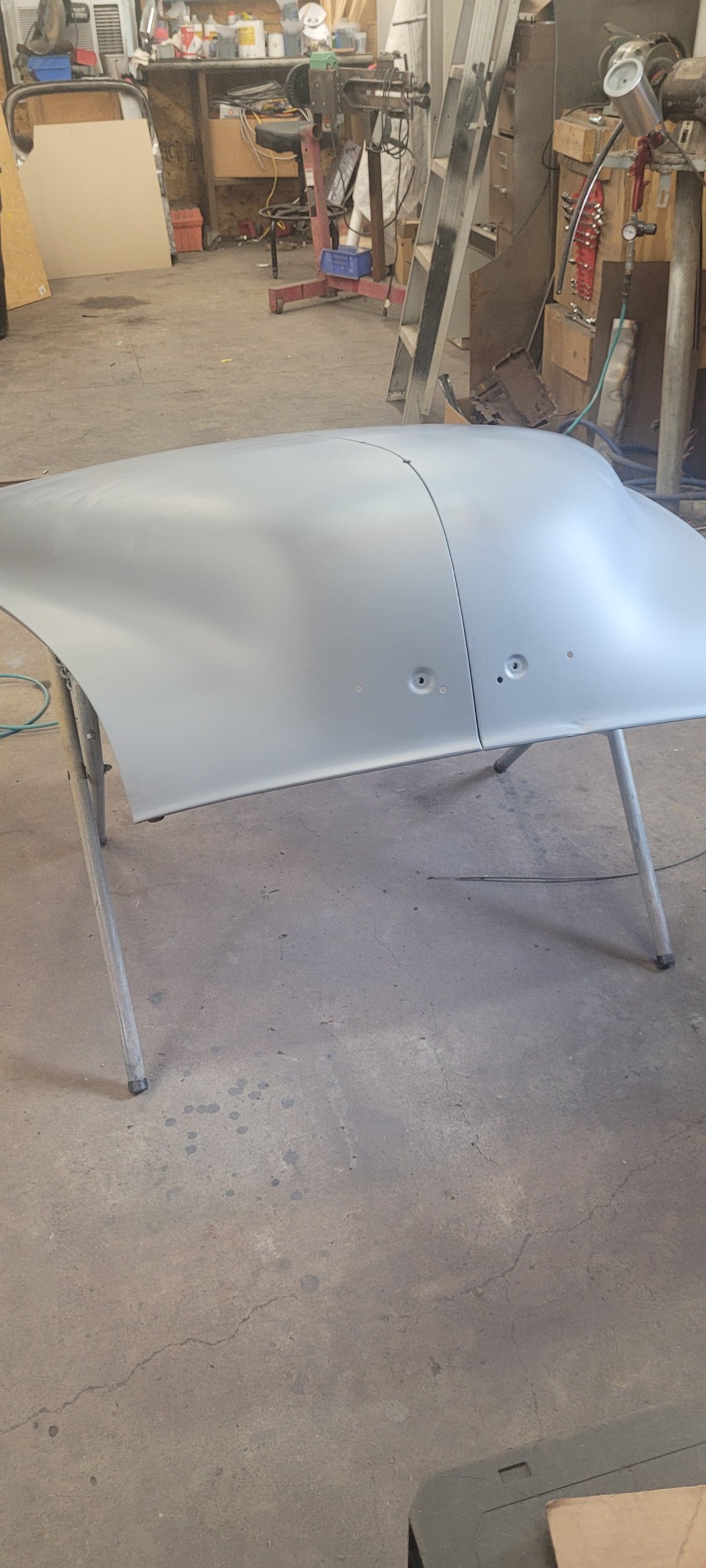

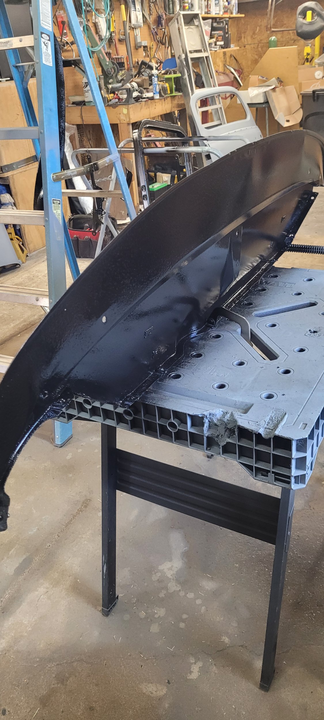

    Mixed up some epoxy primer today and took care of a few items. Got lots more to do! Learning how to adjust the gun for how I like it. There is more to this painting stuff than meets the eye. ;) 20250622_110334.jpg 20250622_110345.jpg 20250622_110834.jpg 20250622_110844.jpg 20250622_111324.jpg 20250622_135328.jpg 20250622_135402.jpg 20250622_135436.jpg 20250622_145710.jpg

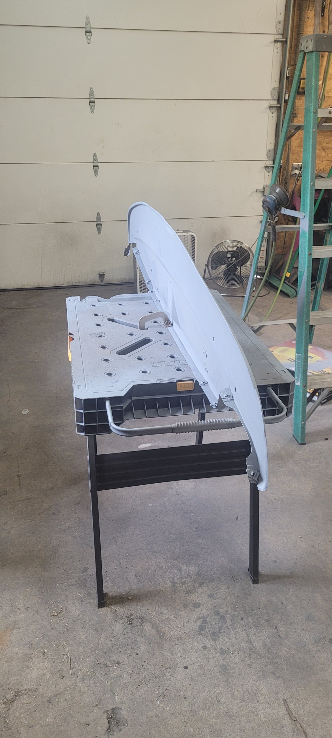

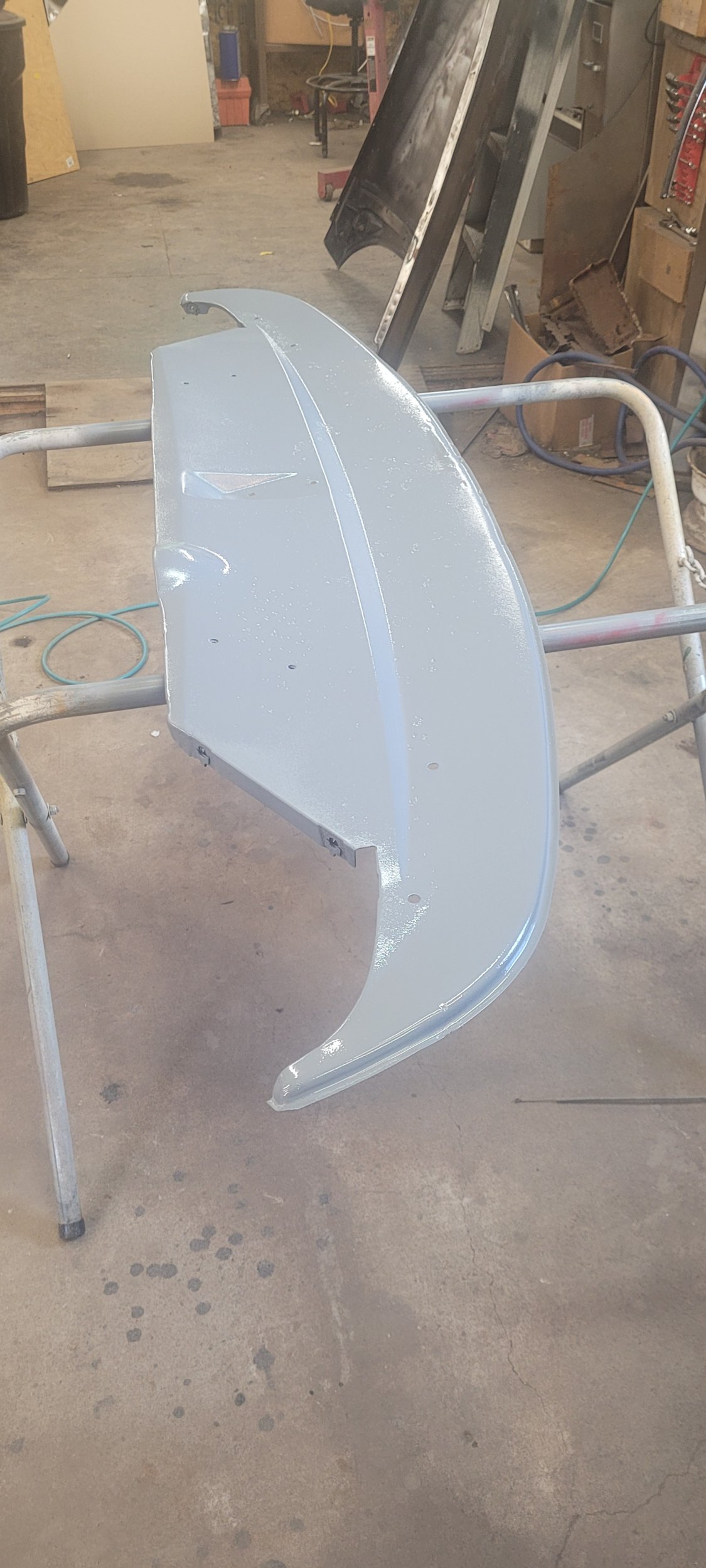

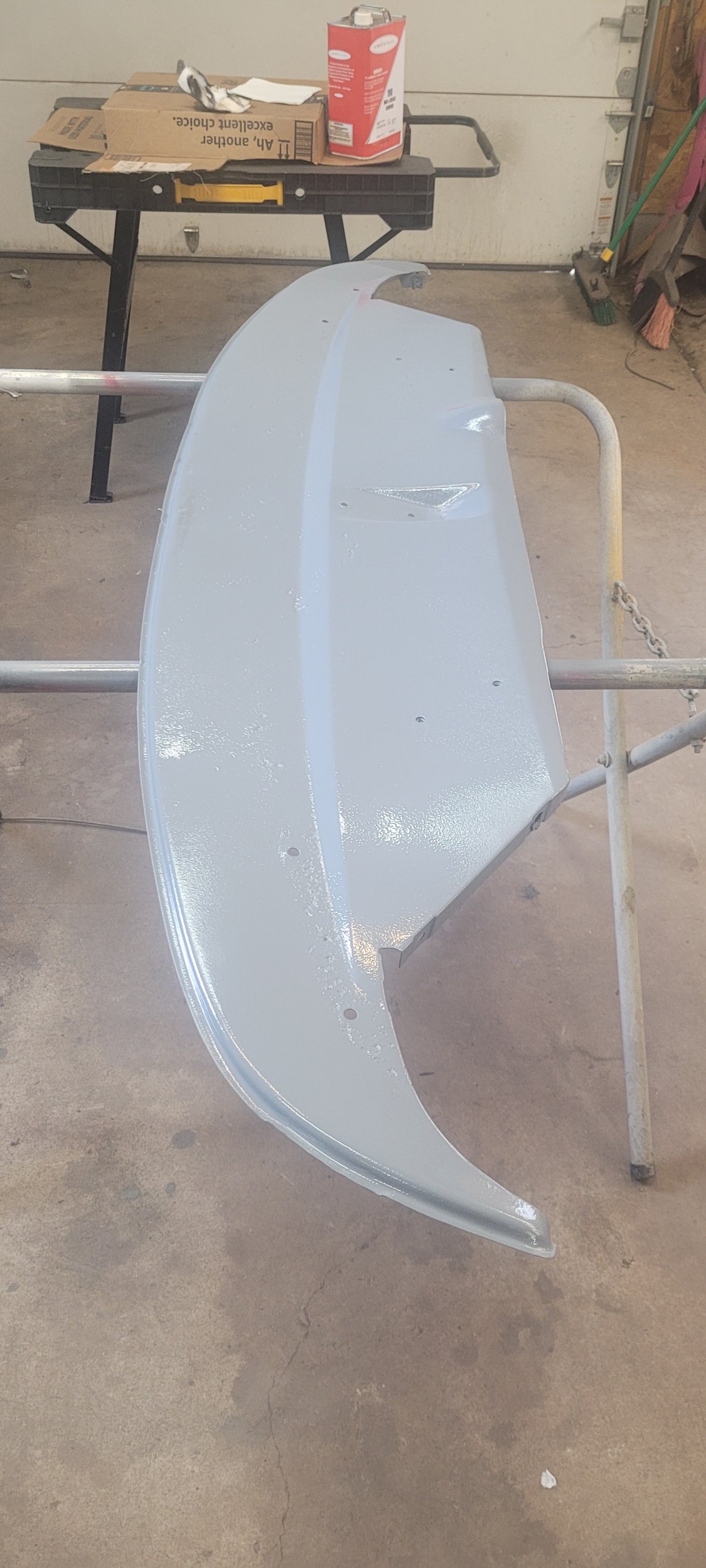

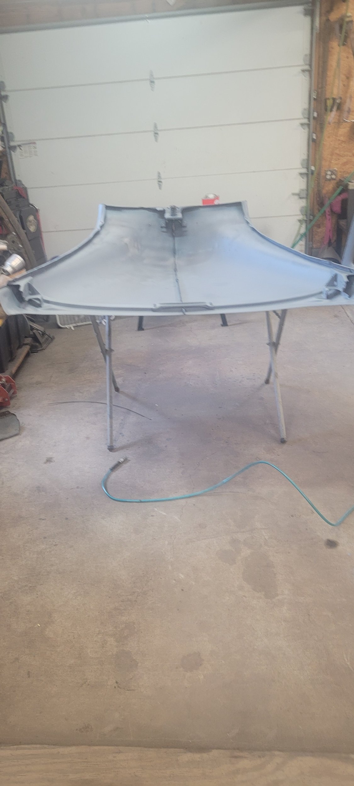

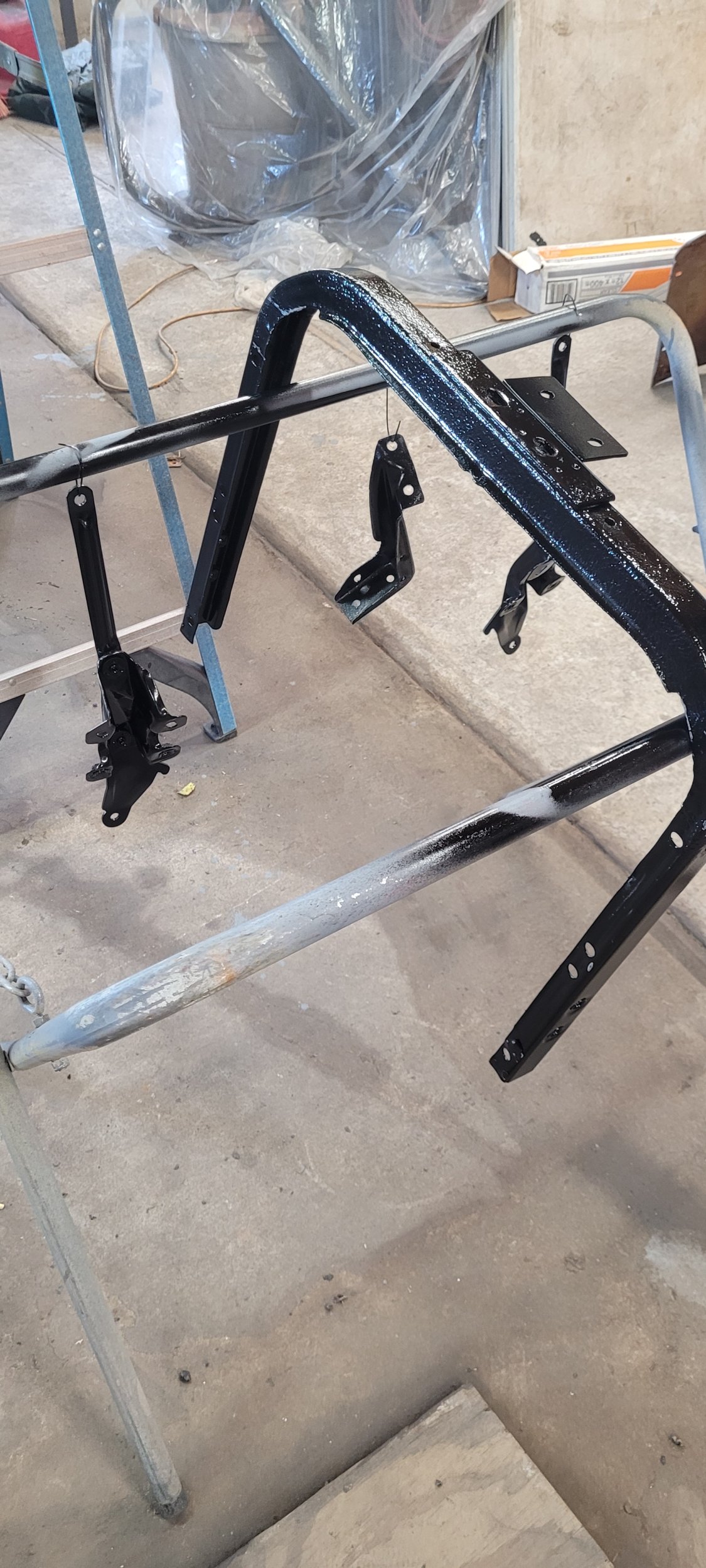

    Trevor and Saul showed up so we put Saul to work painting. Me and Trevor stayed out of his way
    He did a great job on all these little parts.

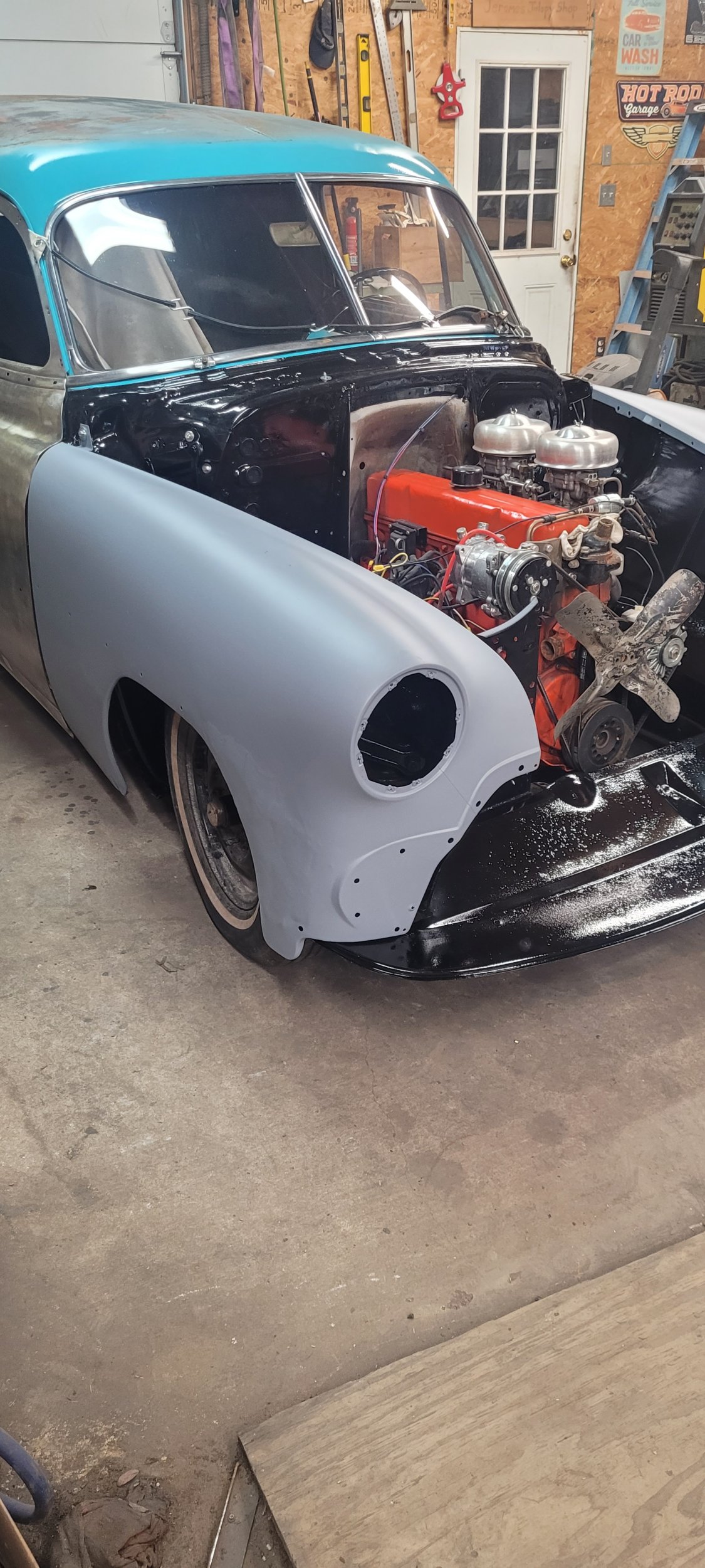

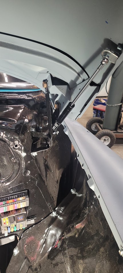

    Trevor and Saul came by today and we did a little work on the Sedan Delivery today. Trying to get all the bare metal covered so I don't have to keep dealing with rust. We shot some primer and also got the window put in the rear door. That was a bit challenging for a couple of rookies but we made it happen.
    Almost forgot about the gas struts I installed on the hood instead of trying to get the springs on. A couple of weekends ago Trevor and I tried using a tool I made years ago to remove the springs to put them back on, and the spring broke when we tried stretching it out with the floor jack to install the tool. It could have been disastrous, breaking like that. Trevor suggested putting the gas struts on, I searched it on the innerwebs and damned if there wasn't a video for putting gas struts on a 51 Chevy. $25 bucks on Amazon later, and it was a done deal. Very east installation. All it required was drilling a few holes in incon****uous places.

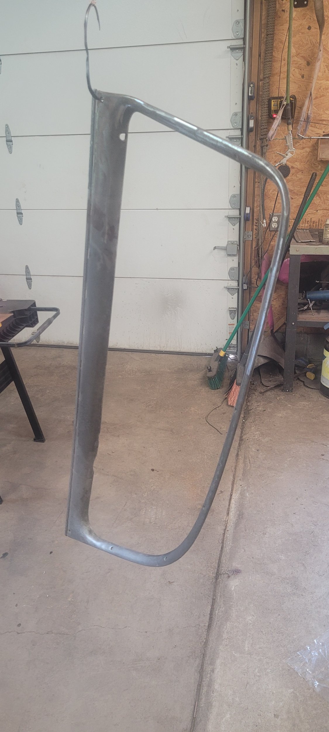

    One thing about the stainless on the rear window. I don't know if it is because the rubber seal is different or what, but the little piece that connects the 2 halves together just barely covers the ends and if it slides just a 1/8" either way it won't cover both ends. I'm going to use a small dab of silicone under it to hold it in place. I actually need to order some black urethane sealer for the window channels so I will probably use a dab of that. I'd hate to lose that little piece.

    That's exactly what I want to "glue" the window channels/tracks in with. Not to glue the gl*** in. This is the channel/tracks in the door frame tha is along the opening that the gl*** rides in. I probably am not describing it very well. Here is a couple of pics of what I'm talking about. 20251006_081744.jpg 20251006_081809.jpg
