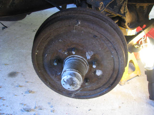

    I am going to go through the entire brake system. I have had brake failure before, and I will not chance it. When I was in high school., I worked at a Mobil gas station, full serve. It was summer and I went in @ 6 am when the station opened. Had a 1970 LeMans Sport (damn I wish I still had that car!). I went whipping into the parking lot, hit the brakes, the pedal went to the floor and the big old front grill of the car ended up in the owners office. He was sitting in there drinking coffee, and needless to say, he was a bit surprised. He was a hotrodder, and didn't get too pissed. He came out asking WTH happened. We checked out the damage to the building and the car, and the car was just fine, a few scratches on the bumper/grill but nothing too bad. He was leasing the building, so he said "pull that car into the bay and fix the 'effing brakes! And don't tell ANYONE what happened or that you ran through the building!!". He helped me go all the way through the brake system, and called the landlord and told him someone tried to run through the building the night before. All Good!
    So yeah....after finding that nail, I will be checking the entire brake system out thoroughly for sure! I have to dis***emble the p***engers side to do the kingpin as well, so I will just repeat the process on that side as well.

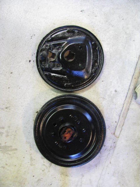

  6. RMONTY
    Joined: Jan 7, 2016
    Posts: 2,679
    RMONTY
    The front end is back together. New Kingpins and bushings on both sides. Front brakes gone through and work amazingly well for not being power brakes. Took her for a spin earlier and actually got up on the highway and aired her out a bit.....60 mph was fast enough, not knowing what all could be wrong with the car and not having any history. I only have a 1.5 gallon gas can tie-wrapped behind the grill in front, and can't get too far from home with only that much fuel.
    There seems to be an issue where it doesn't want to turn as sharp to the left as it does to the right. I am going to look into that next.
    All in all, pleased with the results so far!

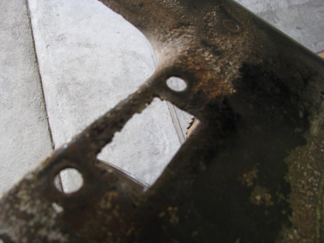

    RMONTY

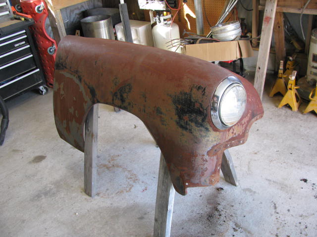

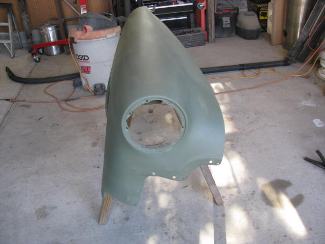

    Not much going on....just some sheetmetal work.....got one fender fixed up a little...needs a bit more work....but there is a long way to go before final paint....lots of bruises along the way I'm sure..At least it wont rust anymore!
    brEad and Peanut 1959 like this.
  30. RMONTY
    Joined: Jan 7, 2016
    Posts: 2,679
    RMONTY

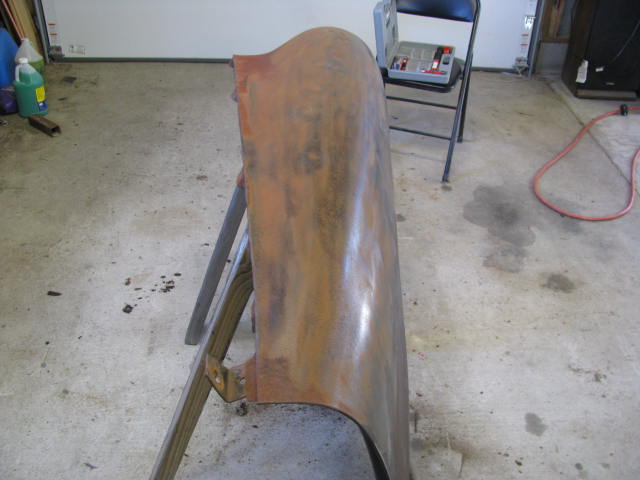

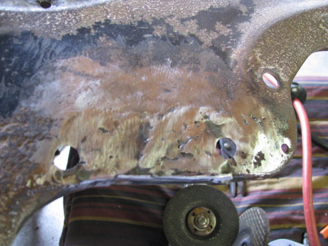

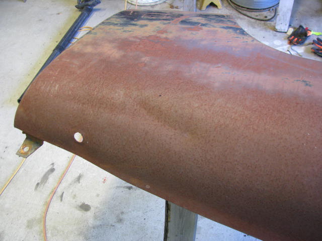

    Now for the driver's side....it is a tad bit rougher than the p***enger's side...
