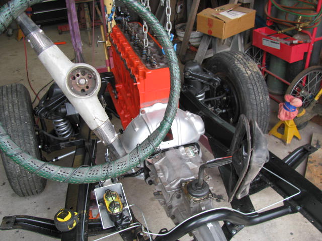

    Finally have a roller! I feel like I am finally making some progress!

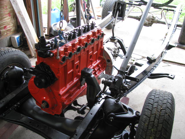

    Making some good forward progress. Trying to get as much done as I can before the end of next month. Going to be out of commission for about 6 weeks as it's time to get the ol' right shoulder rebuilt....All I lack really to fire the engine up is some headers.....I hope to have those in here in a couple of weeks or so and I will fire the engine and do the break-in. IMG_6927.JPG IMG_6930.jpg IMG_6933.jpg IMG_6934.jpg IMG_6935.jpg IMG_6936.jpg

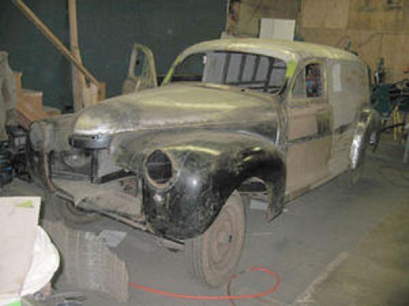

    Here's a little inspiration.

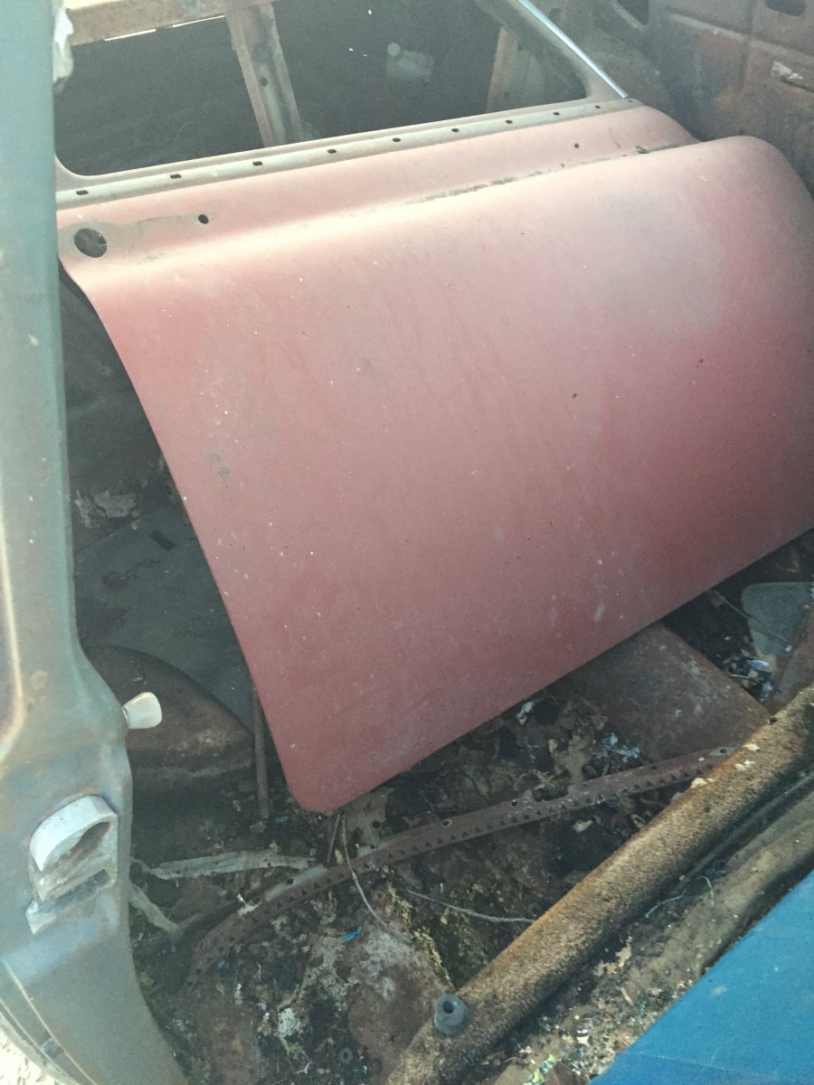

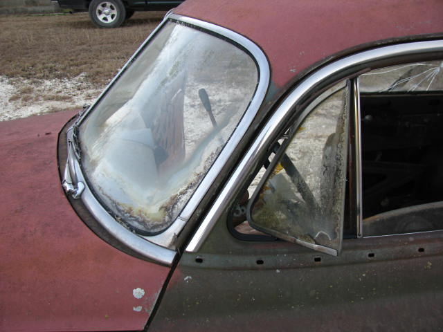

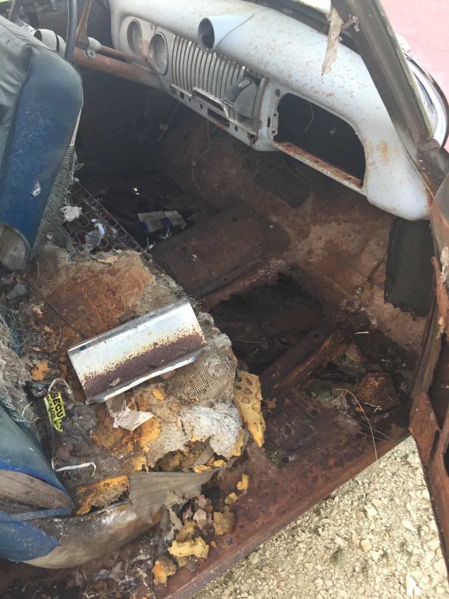

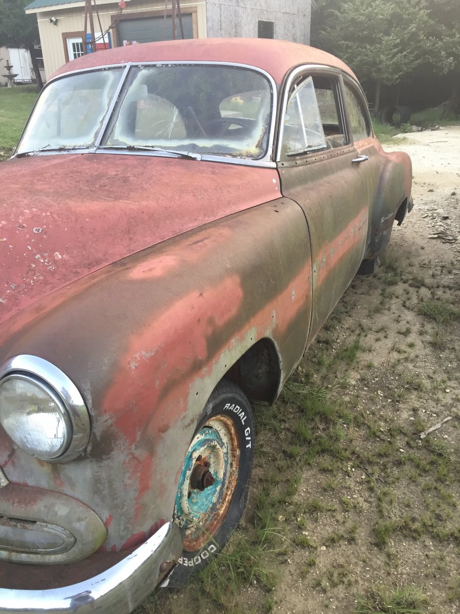

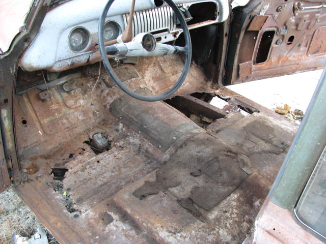

    IMG_0269.JPG IMG_0270.JPG IMG_0272.JPG IMG_0273.JPG IMG_0274.JPG IMG_0275.JPG So through some bargaining I ended up with this....free gratis. Lots of good outer sheet metal and roached out floors. Would it be a sin to cut up the 2 door for the Sedan Delivery? Graft the back of the SD to the 2 DR and build some floor panels? It looks do-able. All there is is 2 ol piles of rust. Why not cut em up?

  16. I think that would be an excellent idea. Change the quarters at the B post factory seam. Add some length in the top with One seam and reset the back door angle to stock while doing it. That's a win win deal all the way around. If I remember correct the Sedan doors are 2" longer so I'd add that in the wheel base to take advantage of the longer doors and not shorten the quarters.
    The Wizzard
    chryslerfan55 and drdave like this.

    Looks like the delivery floorpan is the same as the cars at least up to the rear seat area? So maybe fix the sedan floors and rockers while it's still in one piece on the original chassis and you've got something factory to work from.

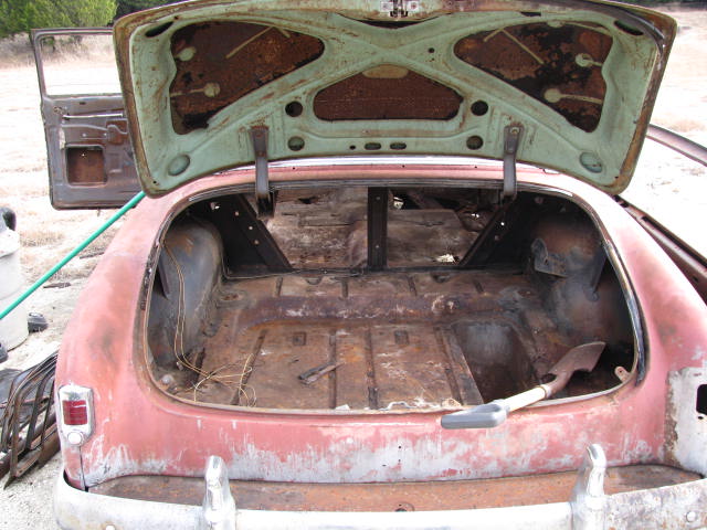

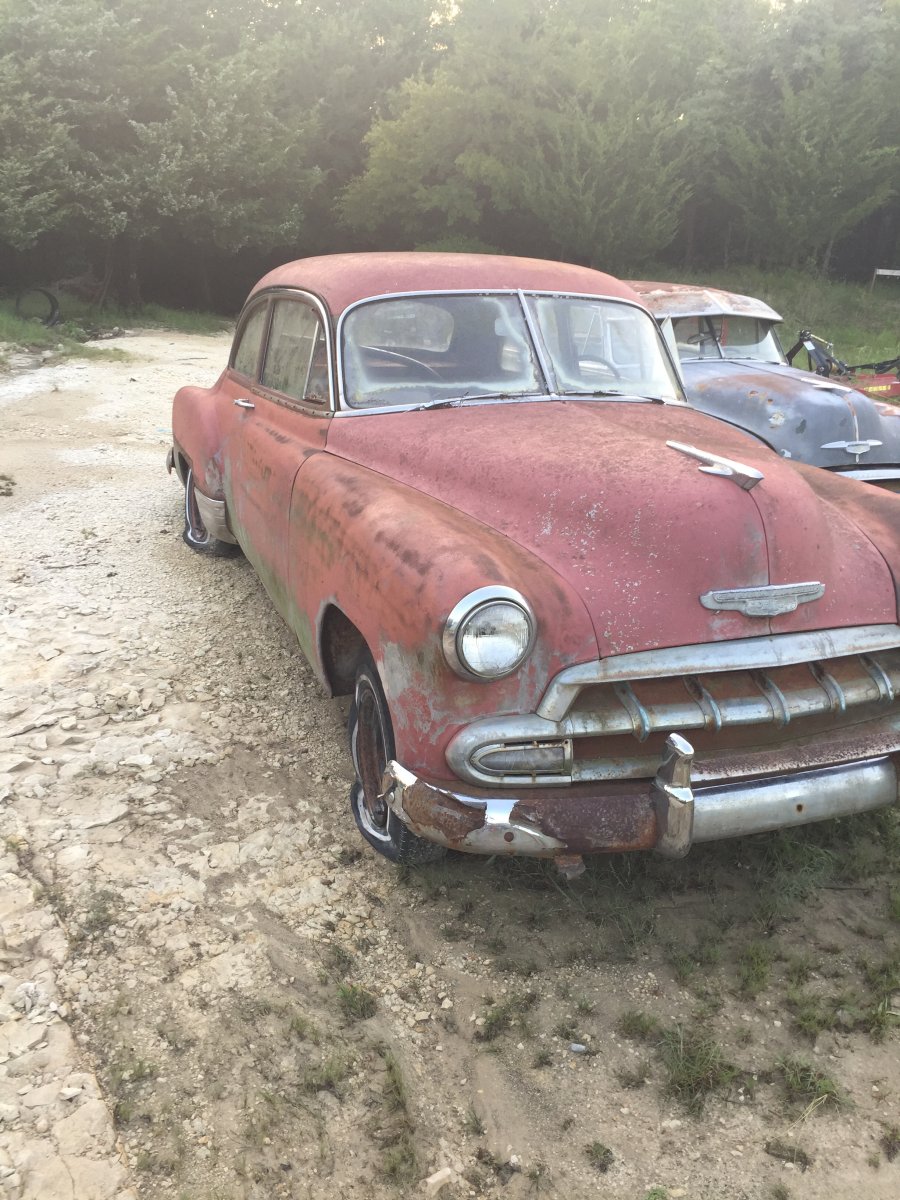

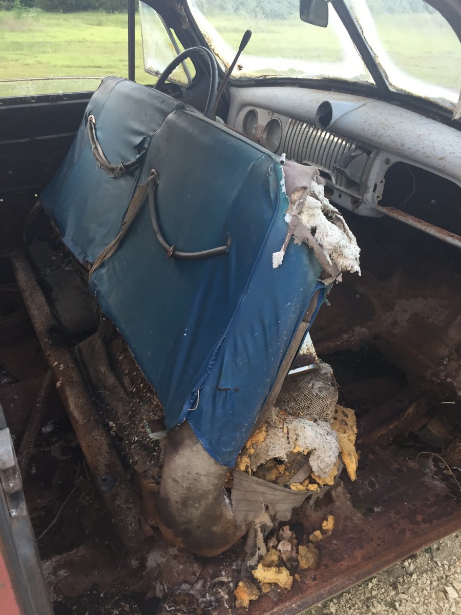

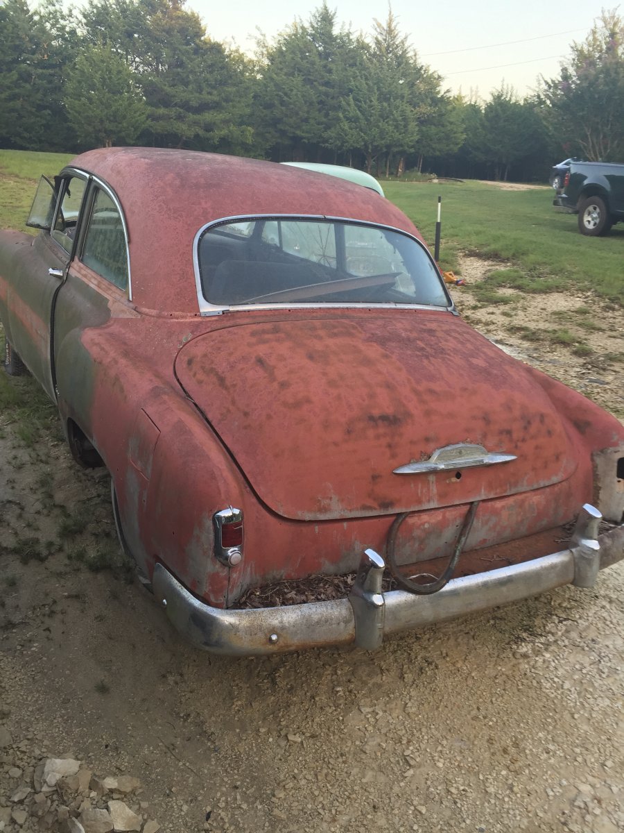

    Been putting in some work on my project. I got the 2 door donor cleaned out a bit. Found all the window garnishes and some other stuff in the trunk along with a cat skeleton. :eek: I talked to the lady I got the car from and asked her if she lost a cat and she said yes, about 10 years ago. I asked her if she wanted it back and she declined. Here are a couple of pics.....none of the cat though.... 2 DR Pass Side.jpg IMG_7030.JPG IMG_7031.JPG IMG_7034.JPG IMG_7035.JPG IMG_7036.JPG IMG_7037.JPG IMG_7038.JPG IMG_7046.JPG
