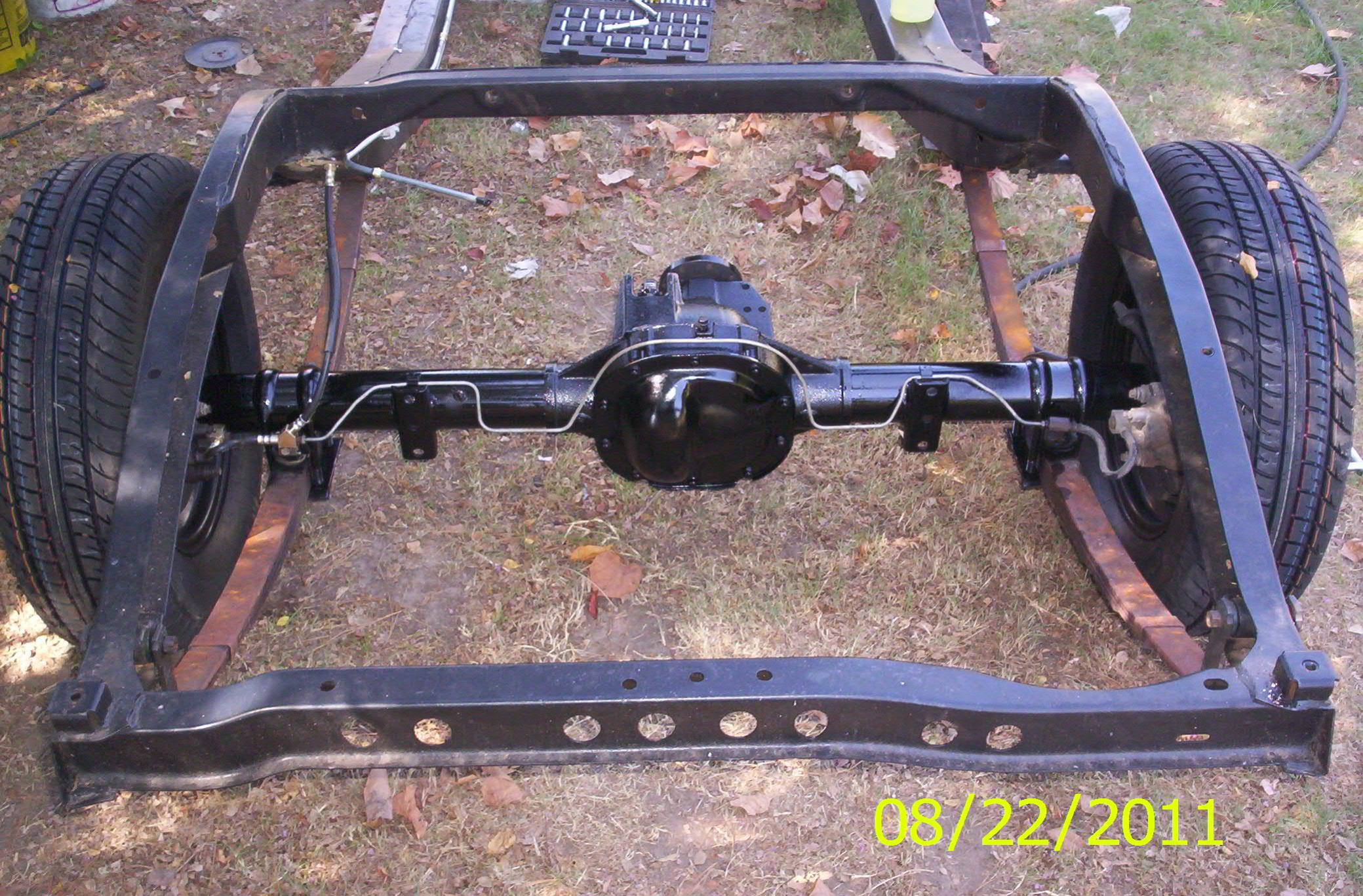

    Another HOT day here...
    A few more pictures of the front with Cavalear rack mounted along with the modified tie rods and arms.
    All brake lines have been installed along with the fuel line.
    New tires on the original rims.
    Need to clean up the front swaybar and get it mounted.

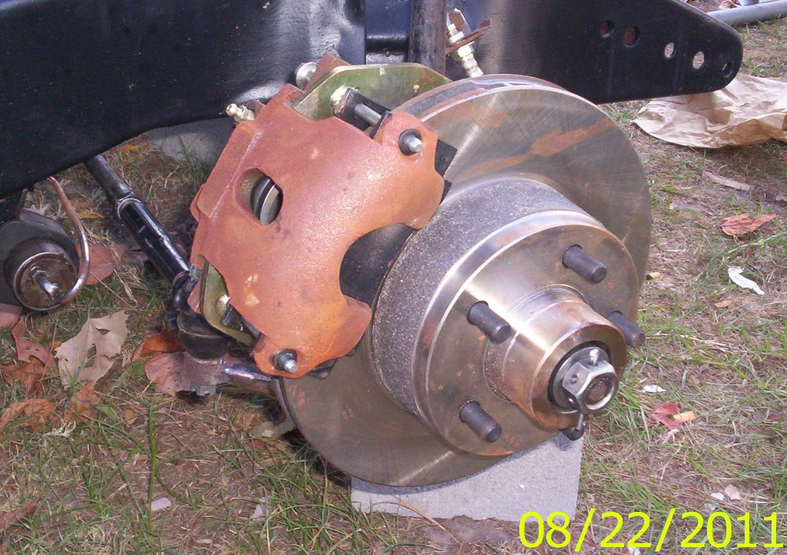

    Here's the rotors and calipers on Scarebird's disc brake conversion...Need 2 copper washers for the brake line to caliper seal.
    Location of the 2 lines from the prop. valve that will go to the M/C, straight up the new location of the firewall...

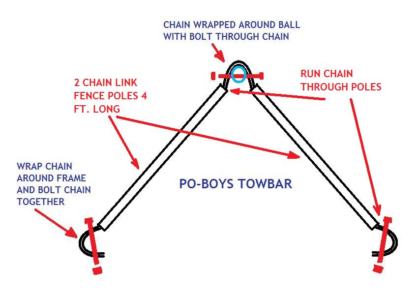

    Here is a drawing of how I made a tow bar from 3 bolts, chain, and chain link fence pipe.
    Worked just fine as long as you drive slow.

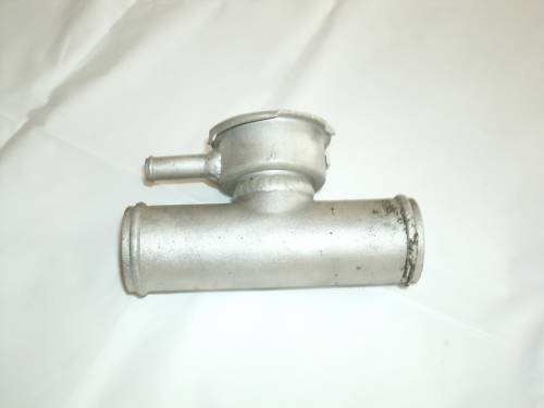

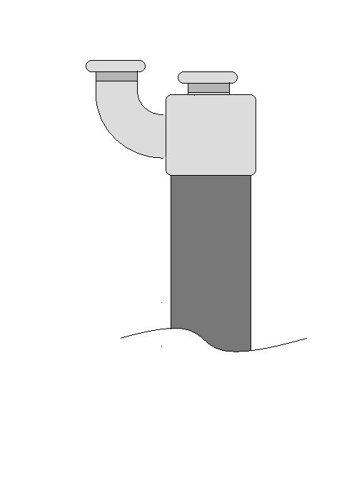

    I did order a new aluminum 3 row radiator for a 66 Mustang for the 429 engine and may be able to use the original fan instead of the electric.
    The rad. will fit inside my radiator frame and if I mount it to the front of the frame I can use the original fan.
    Only thing...The radiator cap will be under the sheetmetal "nose" section.
    My fix is to buy an inline radiator fill that attaches to the upper radiator hose. (picture below)
    Or...remove the filler neck and add in an aluminum 90 deg. mandrel welded into the side of the upper tank and add the filler neck. (drawing below)
