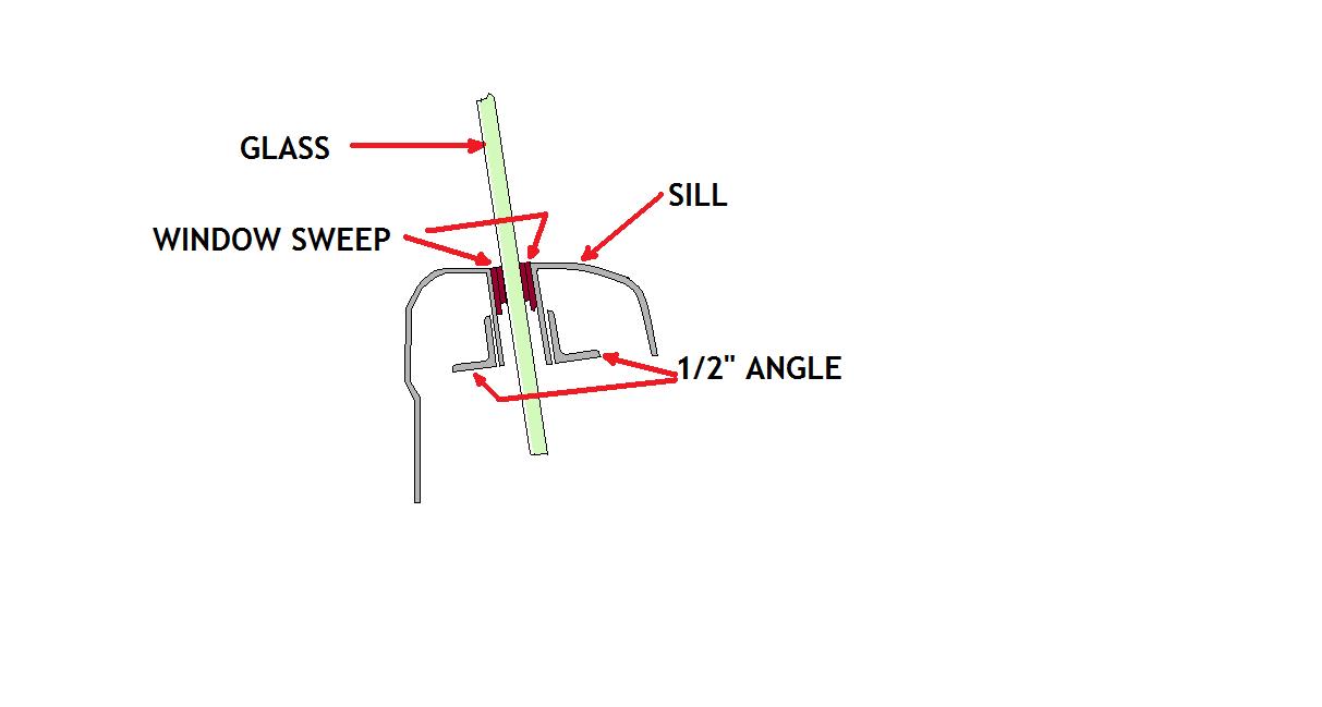

    Due to the limited area the gl*** will be contacting the run channel when raising and lowering the window will flop in and outwards...
    I have drawn up a picture describing my fix for this.
    I will put extension guides attached to the bottom channel extending downward.
    The window guides need to be extended lower into the door.
    Hope this is understandable...

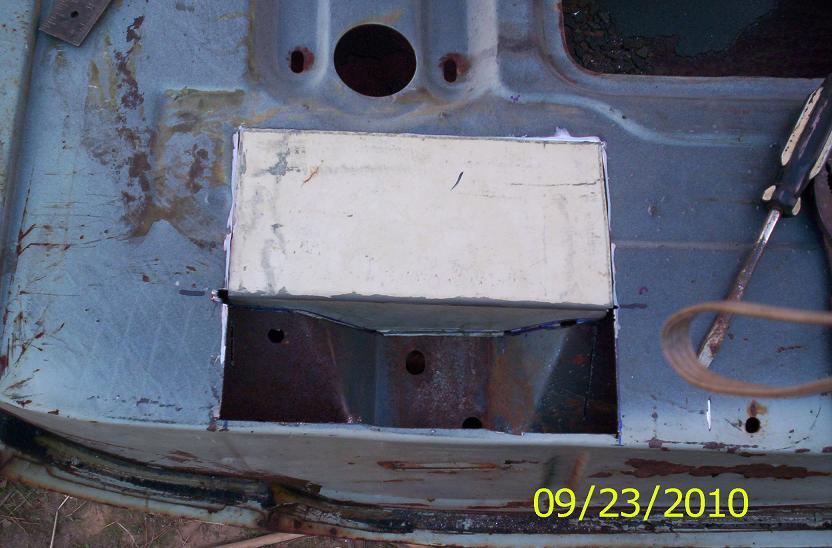

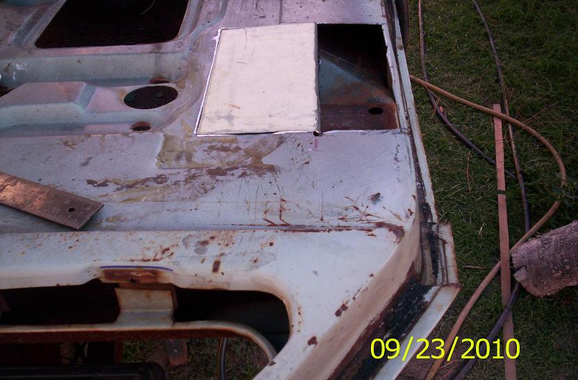

    While waiting on door materials, I cleaned up the inner fenders.
    Right is finished... left needs paint
    Welded up all the wiring clip and battery box holes on the left. (battery will go in the trunk)
    Trans dipstick and tube has been shortened...

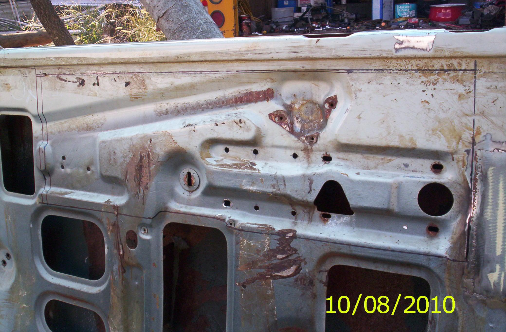

    After installing the Grand Am window regulator I found out that it sets too deep into the door towards the door skin by 3/4"
    The inside door skin has depressions 5/8" deep.
    I will have to cut out all the upper portion of this in order to get the regulator to line up with the window plane.
    I ordered 2 18ga. pieces to fill the door p**** back in.

    Today I got one of the outside sills welded in...
    The 1/2" channel made it very rigid.
    Now I just need to figgure out how I'm going to pop rivet the window wipes in place when the time comes.
    May use some 440 or 6-32 flathead screws with nuts.

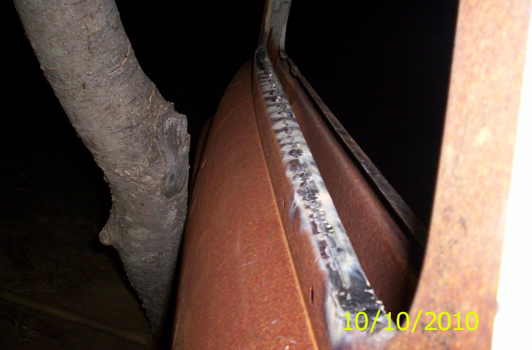

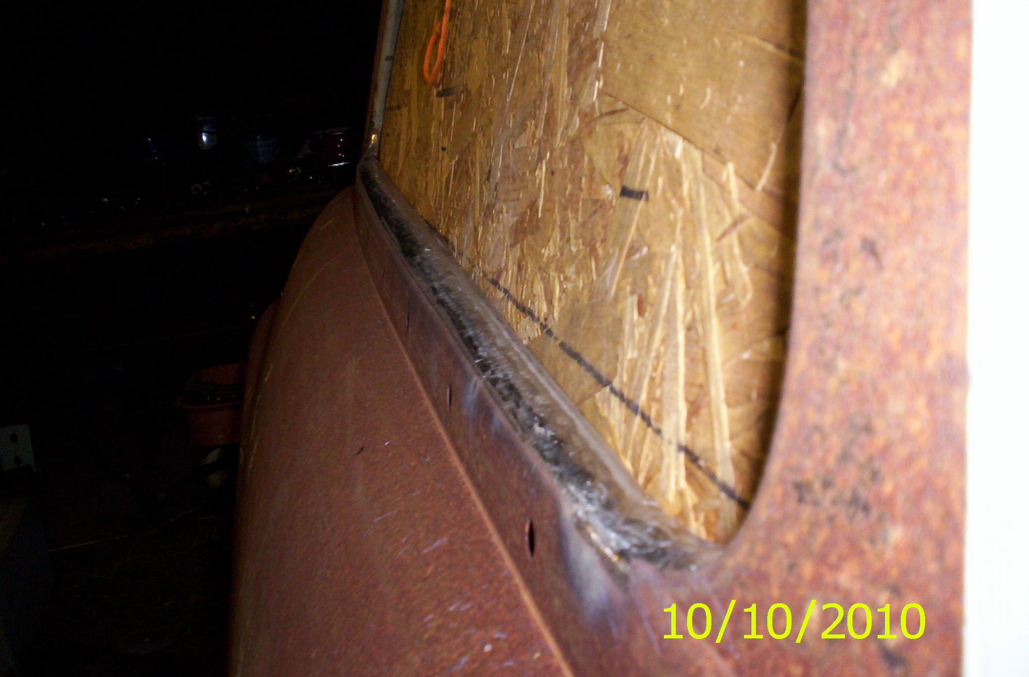

    After completing the welding on the sill I re-installed the window pattern.
    Looking up you can see where I will have to fill in for a straight plane.
    I will do the p***enger door tomorrow...
    I am using a Clarke 125EN with .030 flux core.
    Lots of splatter with flux core but easy to clean up with a flap disc.
