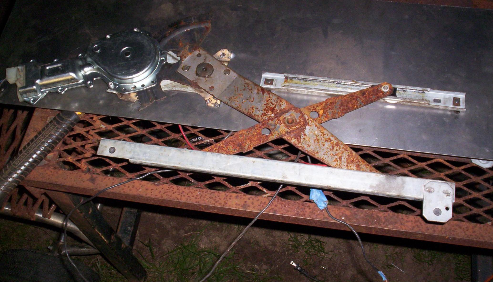

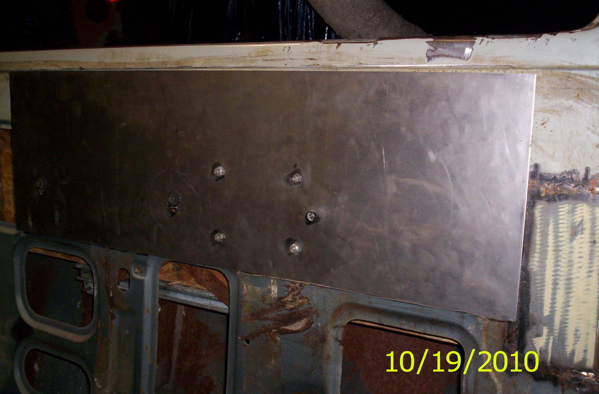

    The steel came in today so I mounted one of the regulators on it and dry-fit it to the door.
    I have desided to remove the inner sill and pop rivit the outer belt in place after painting and then make another pair of inner sills from the same steel and 1/2" angle as used on the outers.
