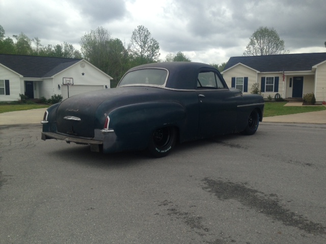

  22. Hows the Wayfarer coming along?
    Here's a few pics of my 50 Coupe, gotta love them MoPar's!

    Here picture one, The new windshield...
    Picture two is the rear window...This brought me much mental pressure as I would hate to break this one!!!
    Third is the stock grill with 2 universal amber lights for turn signals and parking lights and headlights
    Fourth is the tail lights are working...
    Fifth is the under hood wiring...Solenoid, fan relay, and the oo ga. cable to the battery in the trunk.
    Ground from battery goes straight down through the body to the frame...
    Picked up from the frame to a transmission bolt, from the frame to the fender well with a bolt on the solenoid...
    Splits off here through the firewall and to the grounding lug mounted on the brake pedal bracket...Then to each component...
    One ground goes to the fuse panel which has a grounding bar...
