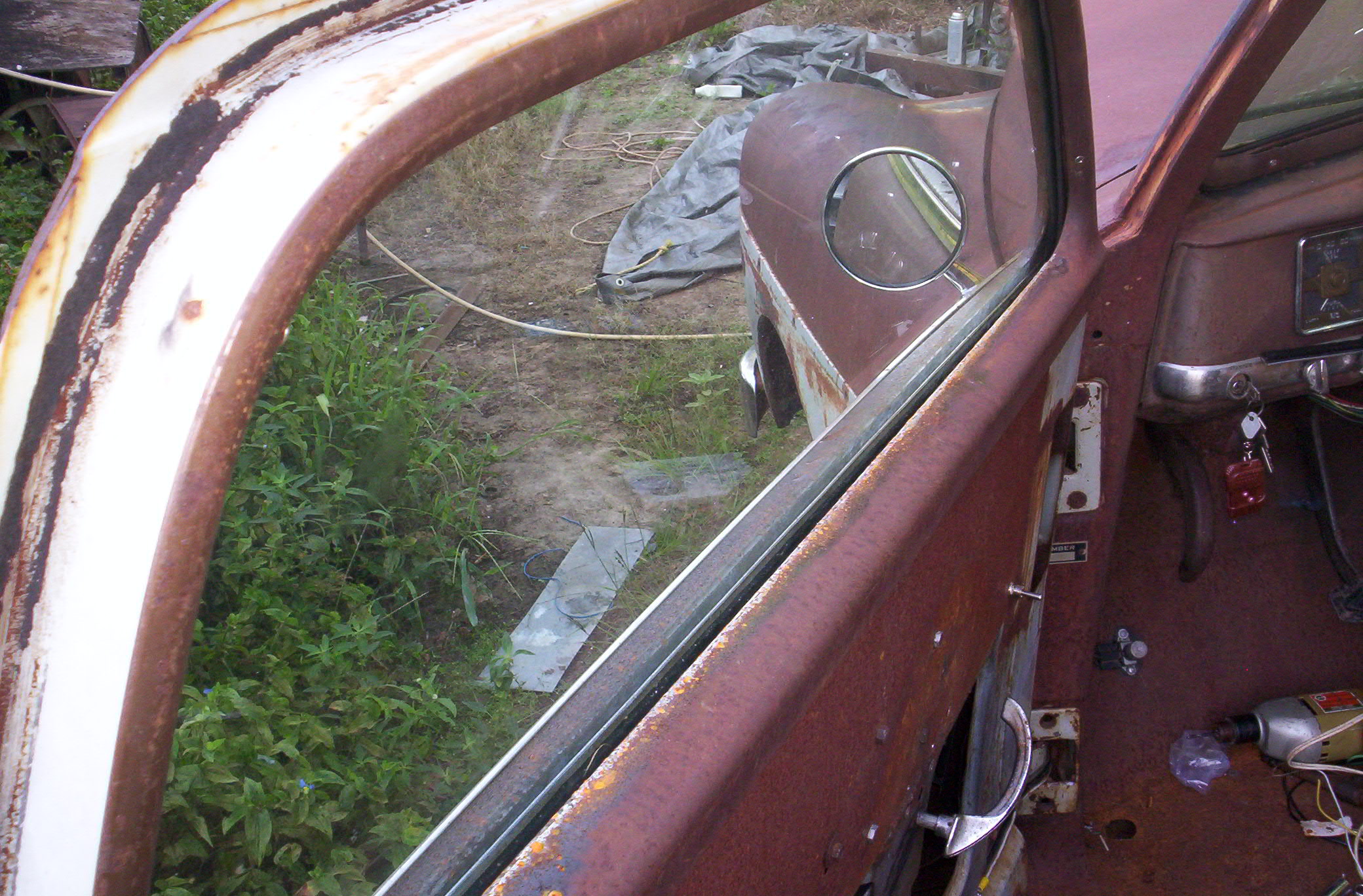

    First picture is the lever to open the door if the electrics go out...
    Second picture is the GM starter solenoid with a plate over it to use as a door popper...This one is for the passenger door which I may not use...
    Next two is the inside and outside of the door obviously...

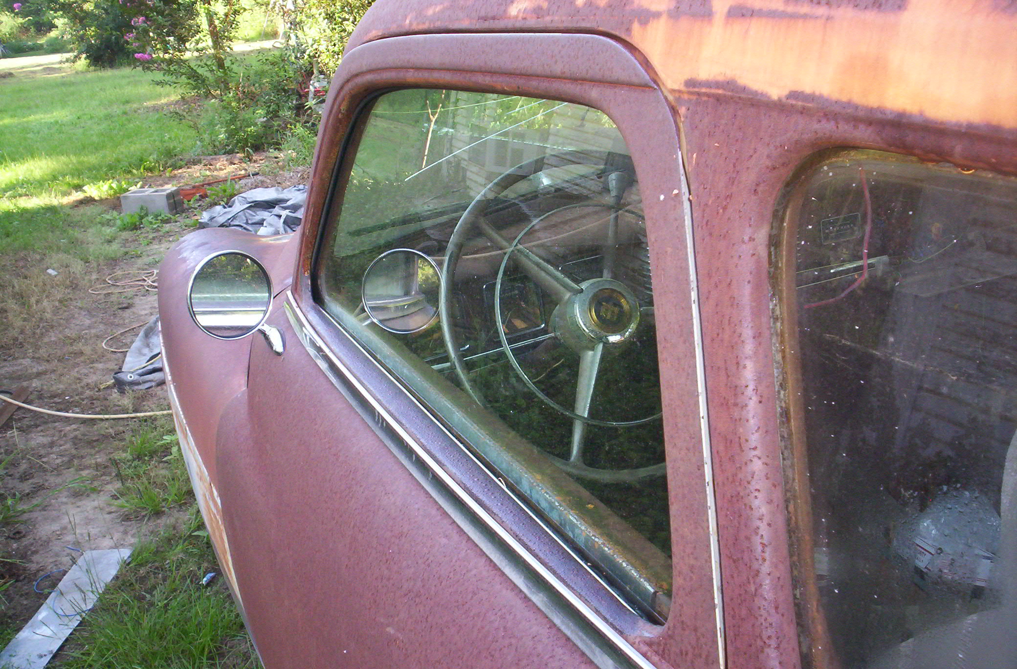

    Fifth picture...DOOH! busted windshield

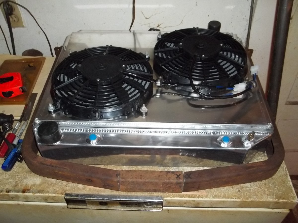

    Received a new 4 row Champion radiator for a 70 Challenger with shroud and dual 12" fans...
    I pulled the front clip to get to it...
    Will have to widen the core support 2-1/2: for that radiator...
    The inner finder support brackets to core support will have to be modified for the wider core support...
    I have the core support with the extra U channel cut and champfered ready to weld up as soon as it warms up outside today...
    I'll have to cut the drivers side trans line and re-flare the end and extend the drivers side...
    Lower radiator hose is too short so another 80 E-350 lower hose will have to be remade to fit...
    The upper is close but another will be cut to fit...
