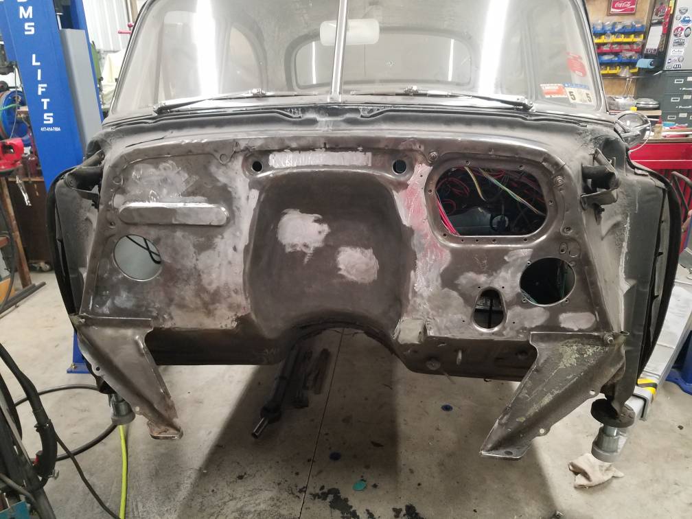

    Will those shortys headers work with your steering conversion? I'm not sure about your setup, but the stock steering will not clear those on the driver's side.
    The work looks great! You will have to remove the fins on the firewall (or at least a portion) and probably clearance your front body mount sheet metal for the V8 as well. Don't go too crazy on the mounts, the previous owner of my car got carried away.

    Here's mine for an example. The body mounts don't need this much clearance, but the damage was already done. I just cleaned them up.
    The firewall fins were just chopped straight back above the V8, but it was crude, so I just removed them. 20191127_145335.jpeg

  28. RMONTY
    Joined: Jan 7, 2016
    Posts: 2,664
    RMONTY
    Wow! That is extreme, isnt it?

  29. Nostrebor
    Joined: Jun 25, 2014
    Posts: 1,333
    Nostrebor
    It works fine. It is a big departure from stock though! You can trim into the first web and leave the inner mount and have enough clearance for most any exhaust issue.
