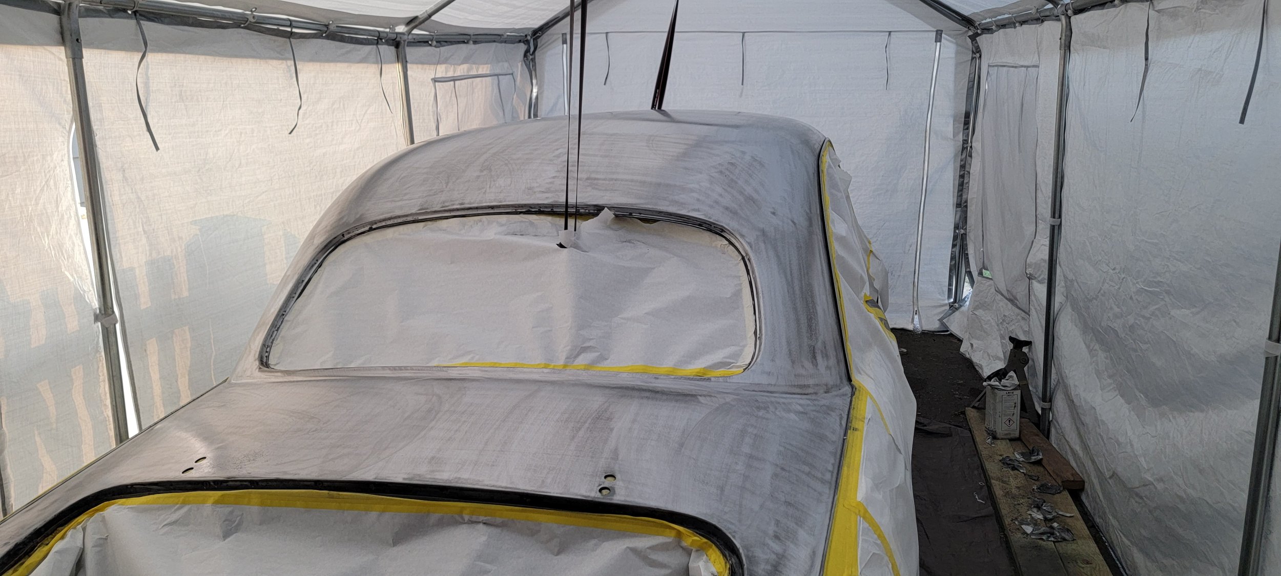

    I chased a few spots blocked the epoxy with 180 and spyayed a coat of high build primer.
    Blocked the high build with 180 quickly followed by guide coat and blocked with 320.
    I only intended to epoxy the car and spray the jambs especially since it was windy and raining but I got carried away and ended up spraying the roof and 1/4s as well. It is a solid dark blue Aston Martin color from the 50s (3 coats single stage color, 3 coats with color/clear mix) The car was then tucked away for the winter.

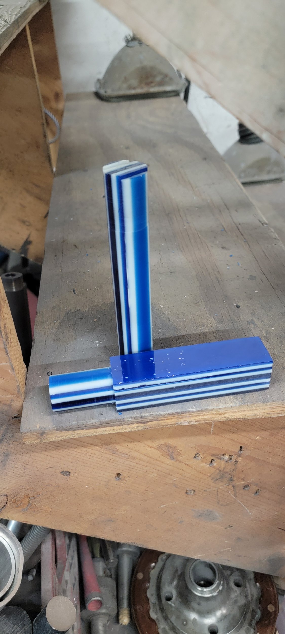

    I pulled the dash out of storage.
    Made a frame to hold it. I stripped it and painted it with a Dodge color called Cool Vanilla.
    I also decided a nice touch would be custom knobs made of laminated plexigl***. Further I added a 2" tach where the clock would be.
    The knobs required layered plexigl*** clamped ever 2 pieces. This was made int a block. The block was then milled square. The ***embly was then placed in a 4 jaw chuck and a round end turned on it. I could then place it in a collet chuck and turn the rest of the piece.
    Once round the knobs could be turned from that blank.
    The dash is currently out for pinstripe.

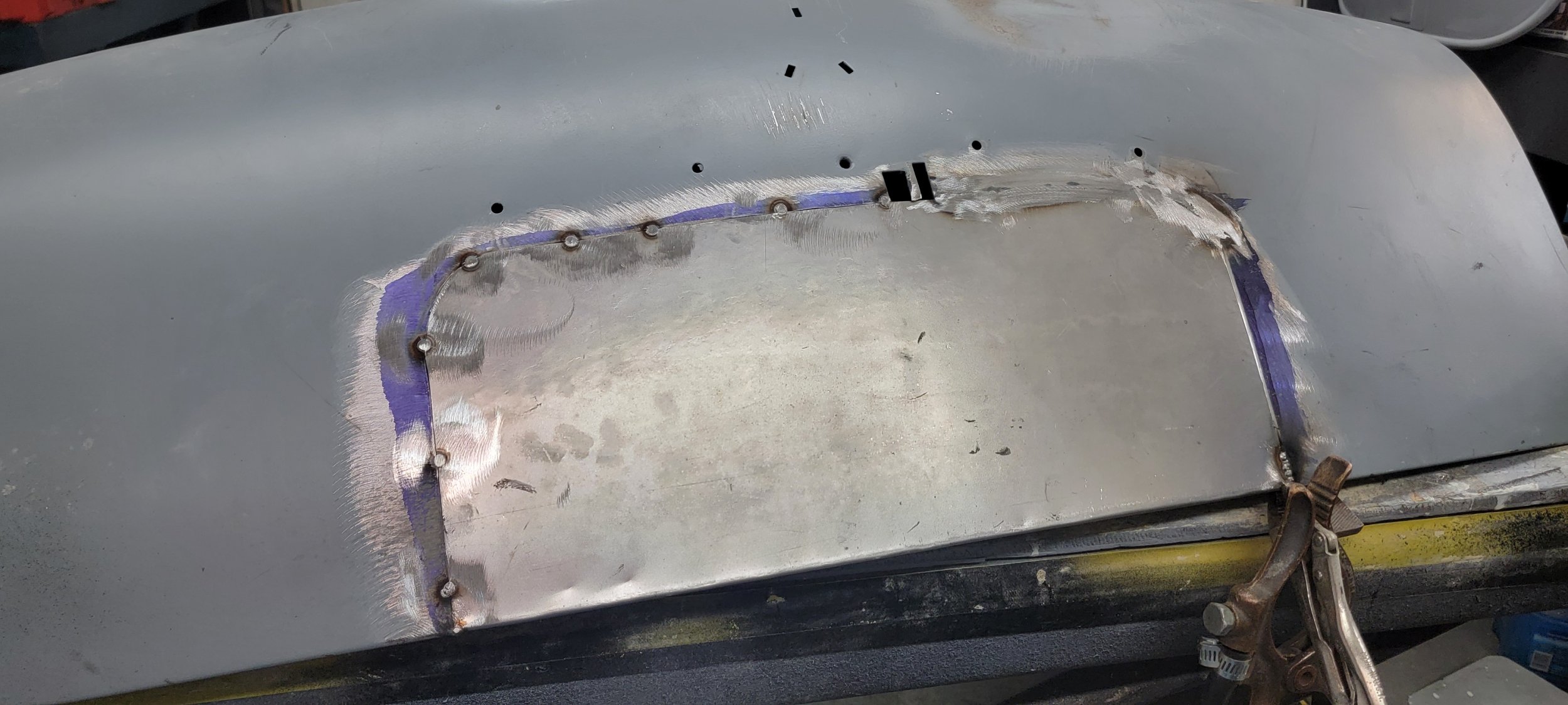

    With the dash done the only other panel I has was the trunk.
    I decided to shave it.
    Under the primer I of course found rust.
  10. SinisterSleds
    Joined: May 6, 2012
    Posts: 102
    SinisterSleds
    from MA
    I delt with the rust by treating it with ospho.
    Cut out the inner so I could metal finish the license plate fill patch and painted epoxy on the trunk. 20250330_123356.jpg 20250331_163424.jpg

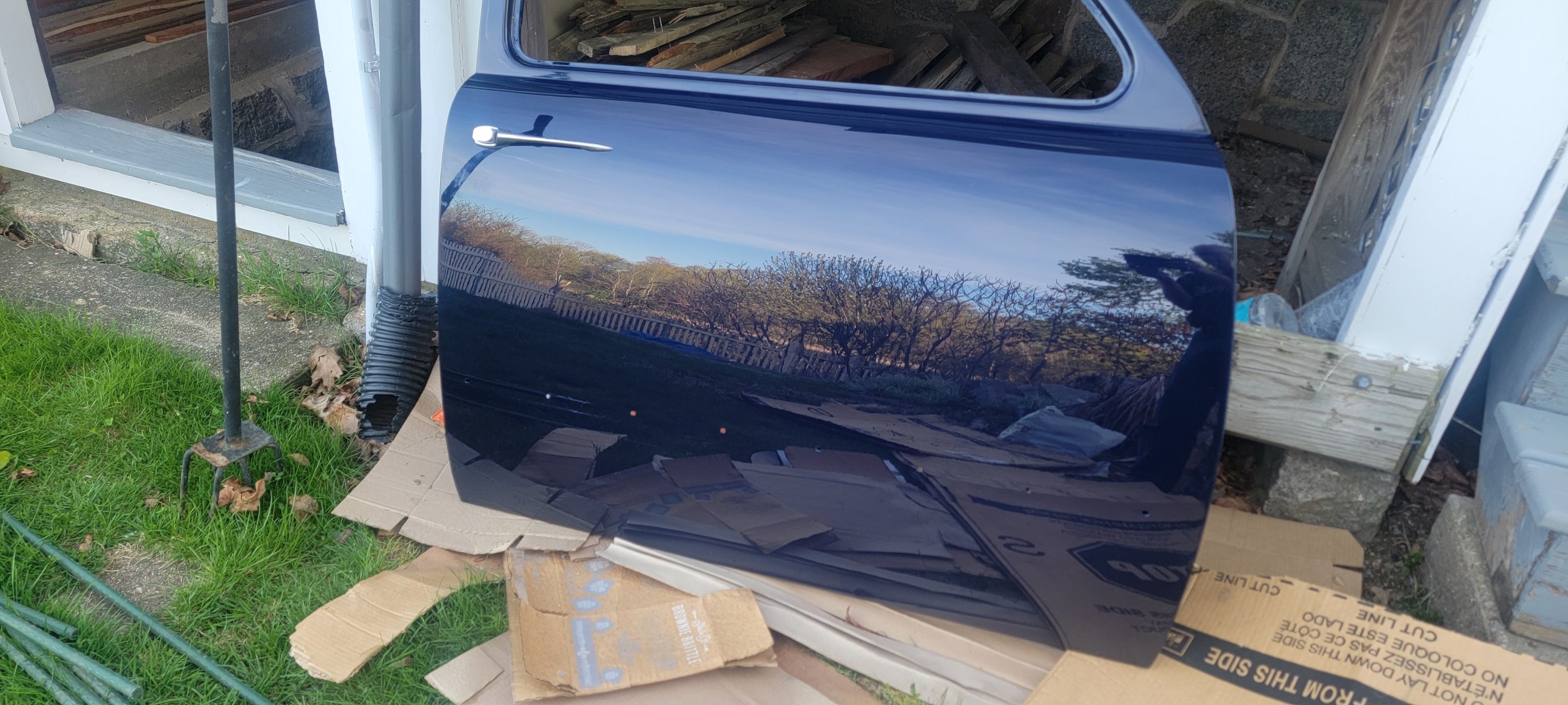

    Next on the chopping block was the doors.
    Shaved the lock and added Fiat door handles. The door handles required fabricating a new ush ****on and means of actuation the latch. I will modify the latch later. 20250427_061144.jpg

    Someone could complain if they wanted but I'm not redoing work I don't have to. I'd like a 4-5 speed, but I'm not going through the effort on this build, the set up is the set up. If I really like the car and my wife agreed (she is a bit afraid of the 390, 4 speed AMX) I can always swap in a 4 speed later but Im building something she is willing to jump in and drive.
    Sealed the doors with epoxy after blocking the high build on Monday night, painted them yesterday. Quick buff this AM and installed the door handle. Then modified the latch. I'll take it home tonight.
