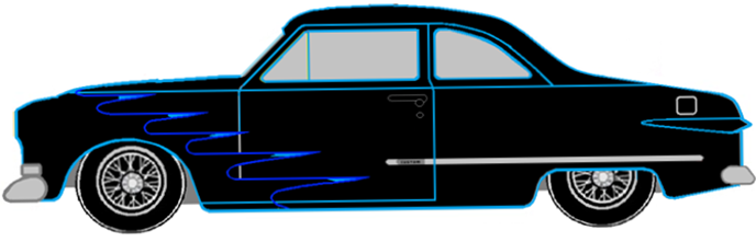

    Hello,
    My wife and I in our 20s and were looking to find a project similar, in various stages of build points. What ever we purchased, a full project or repair to the build, it had to be able to store my new 8 foot long speed surfboard design. The problem for us was, yes, it can be stuffed in the open trunk. But, it stuck out too far. Measured, it could go sideways inside with the rear seat opening to the trunk clear. Now, the nose could go between the bucket seats.
    For us, it was a step away from a station wagon or older Ford Sedan Style hot rod. But the owner did modify the motor with multiple carbs and sounded nice upon start up when we saw it in an old dirty garage. We made him an offer, he flatly refused . My wife looked at him and was amazed he was so unruly and not nice. The offer was about 50 dollars less than his price, as we only brought cash.
    So, we walked out and our plans for the 50 Ford Coupe was history. But, it always stayed in our minds as a nice body style and would fit the new shorter surfboard. (Locked inside, if and when we left the car alone.)
    Jnaki
    At the time, we did not have any more money and the owner was being a hardball. So, we left to look at another hot rod that was nearby a few miles into the industrial area. But, ever since, we always wondered what that 50 Ford Coupe would have looked like if we had bought it and continued our modifications, as we were able to get some funds.
    Recently, I drew a modified version of what the 50 Ford Coupe would look like if we had continued with the purchase.
    A new SBC motor, 4 speed and a lowered rake stance with custom wheels + A/C. (perhaps even some scallop pinstriping…) Now, that would provide space for the shorter surfboard and have a place to lock our photo equipment sight unseen, on our long road trips all over the place. There would still be room for a tent and camping stuff, too. YRMV

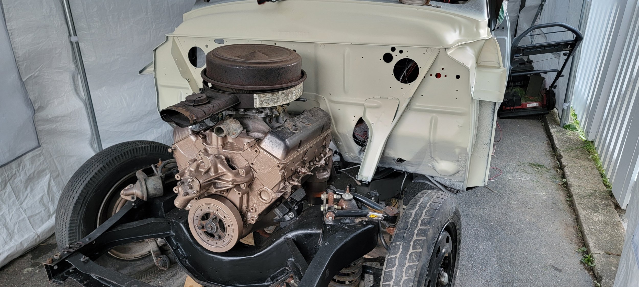

  17. Another p***enger manifold that may work is a 55/56 265 manifold. I have them on the 350 in my 53 bel air
    anthony myrick likes this.

  21. I used 2 rights (p***enger side) the left has an alternator provision that I don’t need. Plus these were free and all the guy had :)
    The 265 ports are smaller but I fixed that with a die grinder.
  22. Like @anthony myrick said. Left and right castings are near identical aside from a factory left having a generator mount. I'm running a set of 55 manifolds on my 53 Chevy
    SinisterSleds and anthony myrick like this.

  25. Hold on. I'll show how it fits on my 53 Chevy. Lot harder for than a shoebox.
  26. Closer to the frame on a 53 Chevy plus I had to work around the goofy stock steering. Be a breeze in a shoebox IMG_20250506_183350_HDR.jpg
