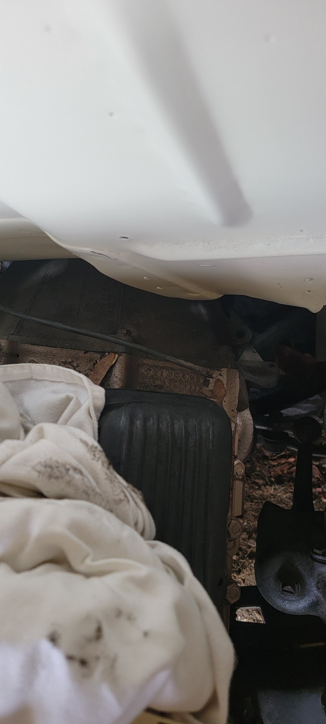

    Looking at the engine placement and problems fitting a left manifold my neighbor suggested the motor could be moved back. This might add some more room to clear the manifold. So that has been added to the list.
    Should be able to come back a couple inches. At this point I almost want to do away with the Jamco parts and just sub-frame it as I keep on running into more problems. One of the drawbacks to taking over someone else's project.

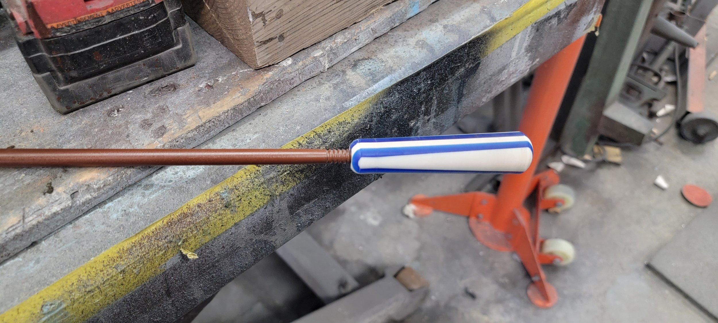

    On a positive note I turned up a shifter knob which I will epoxy on once the lever is painted.

  7. Regardless of manifold fit id have to move that engine back if it were my car. While access to bell housing bolts is nice you should never be able to easily see the full casting number lol

    Agreed. It was not my initial intention as I was not looking to make extra work for myself however the current location (set by someone else) is causing too many problems.
    I milled one of the stock manifolds I hoped would work at a slight angle which allowed it to almost fit. Once the engine moves back that manifold may work.

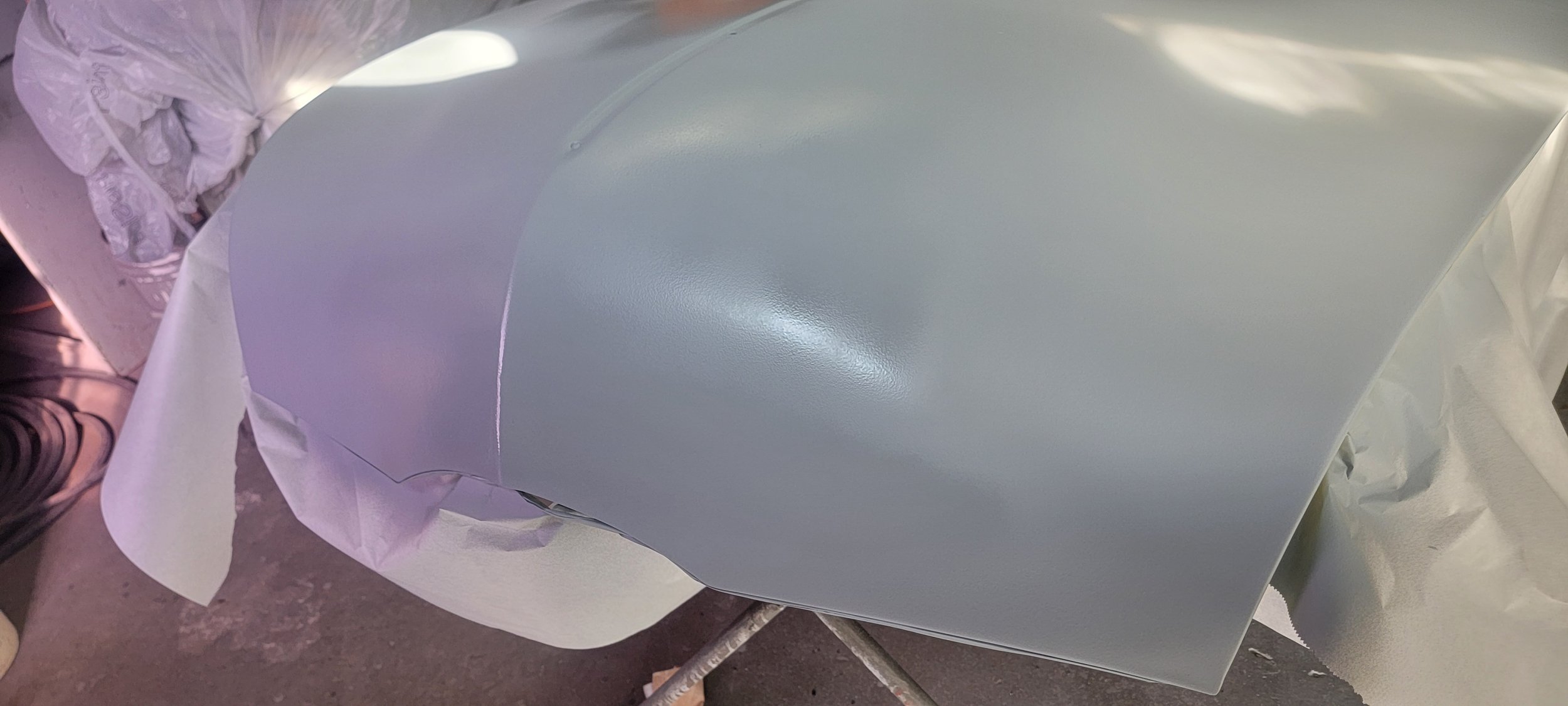

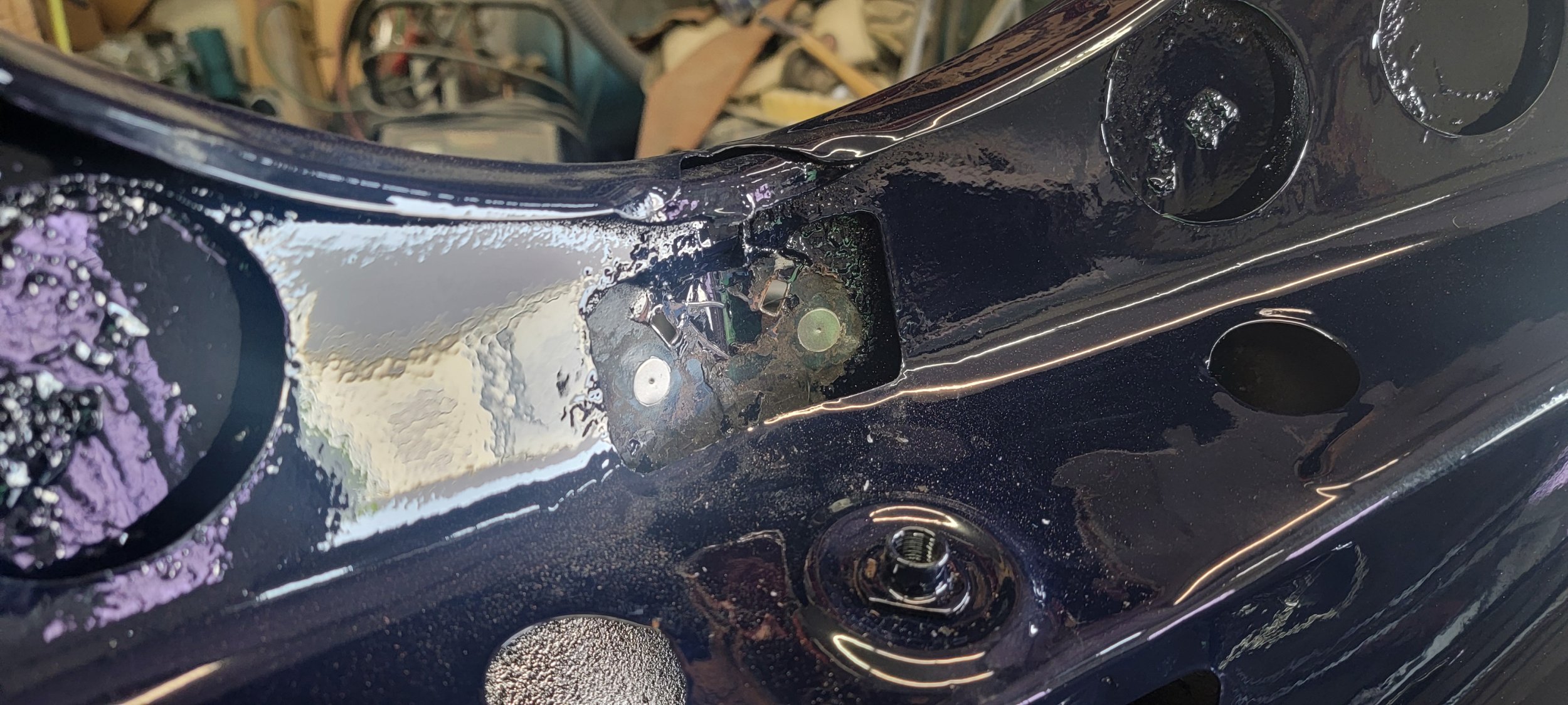

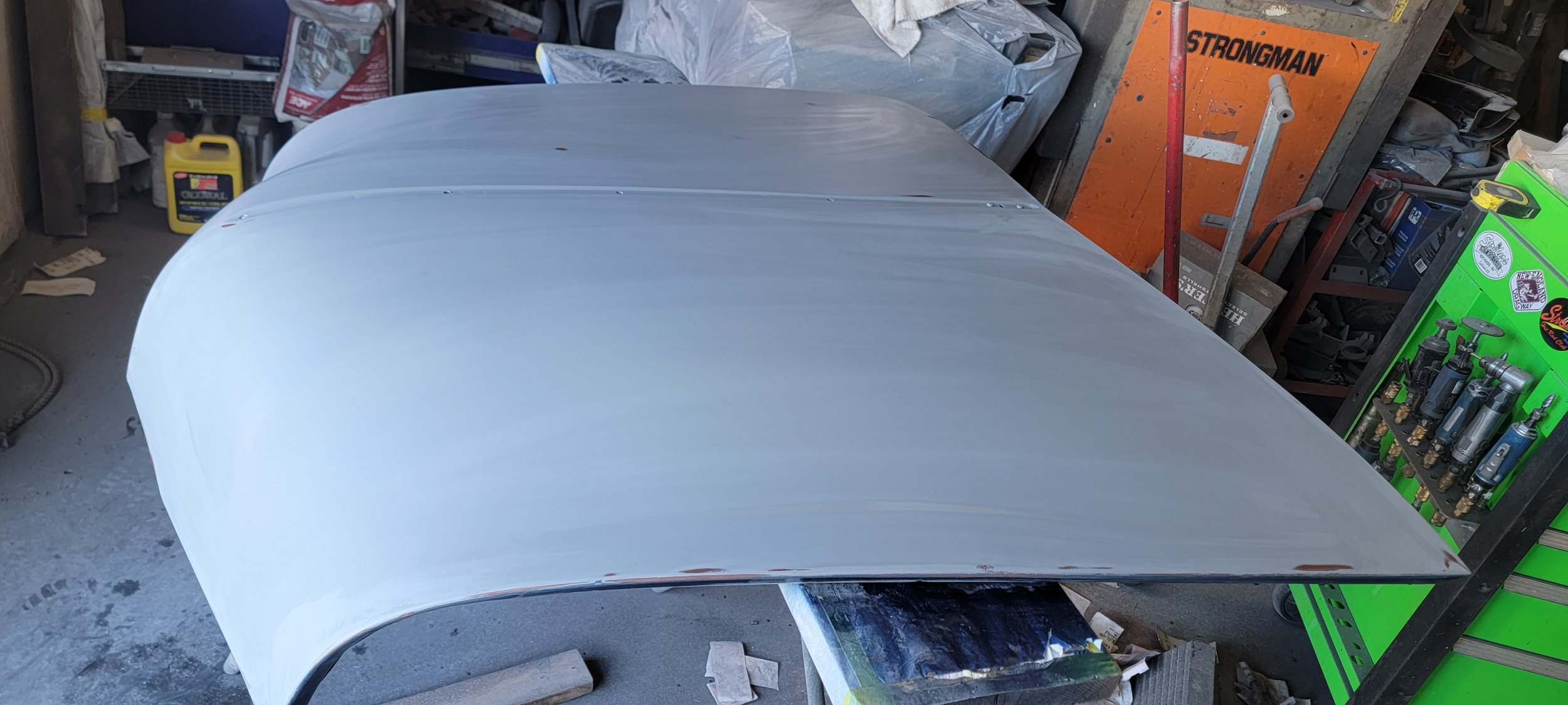

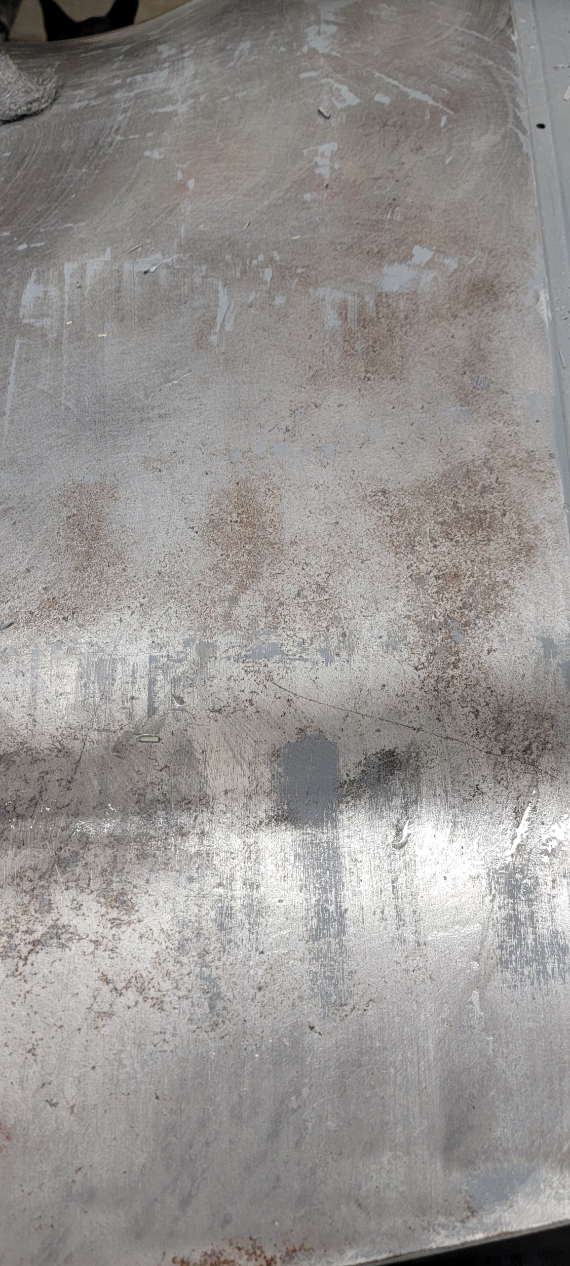

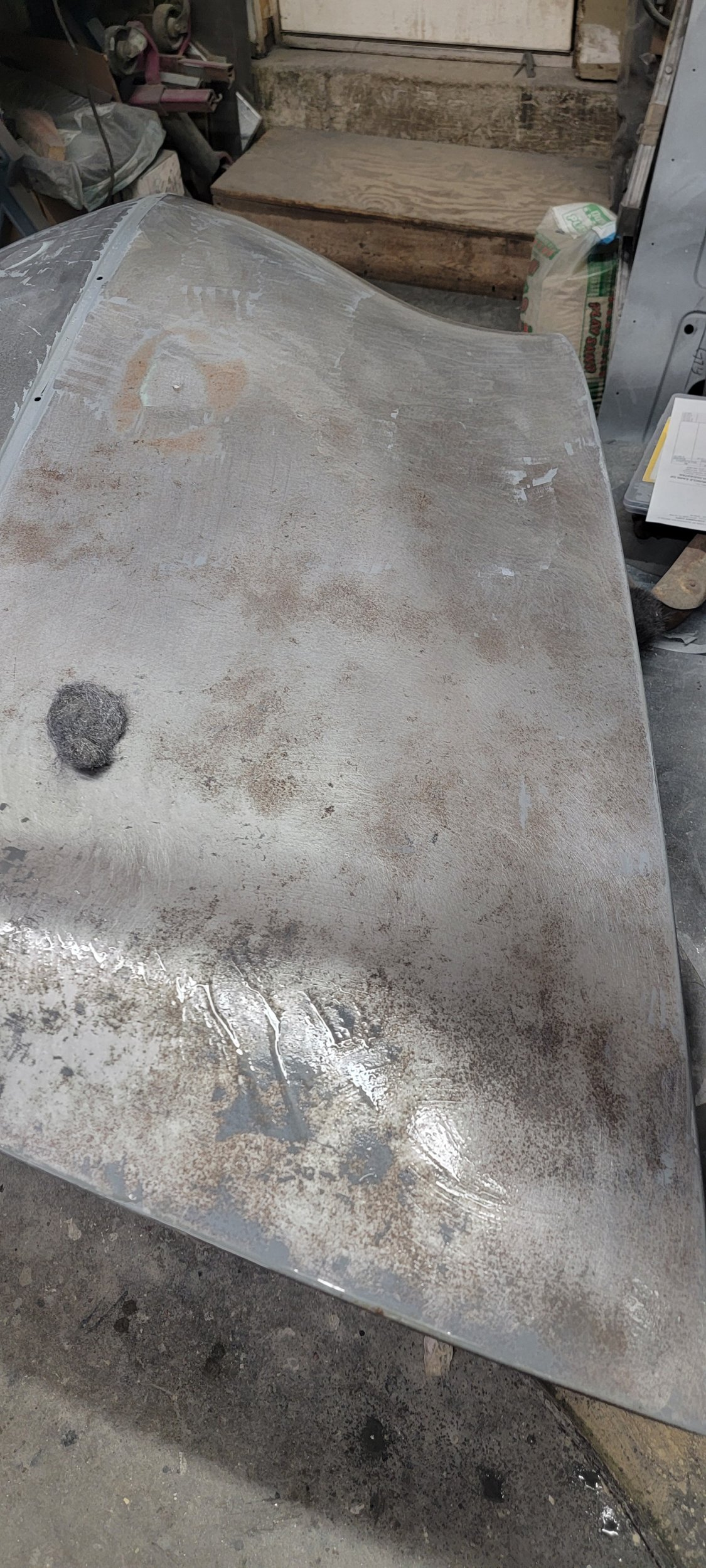

    Spent an hour on the hood this AM.
    Pic #1 as expected I found some pitted rust under the epoxy.
    Pic#2 Stripped 1/2 hood and it did not look terrible.
    Pics 3 & 4 are the 1st and second applications of Ospho and the rust it is pulling out of the pits showing how much more rust there was.
    This is why shops do not like to work over someone else's work. If i worked over the primer it would have been a time bomb.
    20250525_070743.jpg 20250525_081955.jpg 20250525_082234.jpg 20250525_082236.jpg

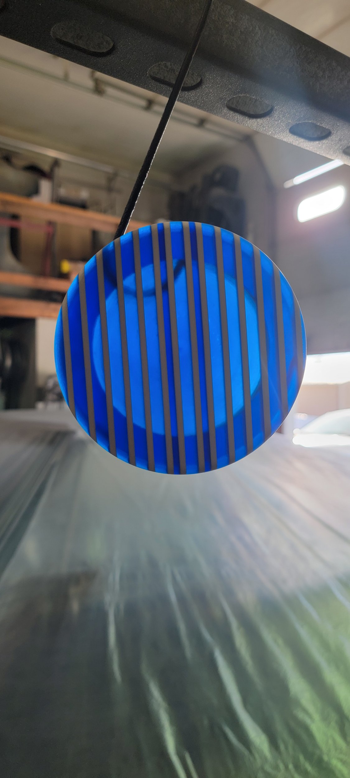

    3rd coat of Ospho
    Finished up the steering wheel.
    Jury is still out. Not really happy with the results of the wrap. 1st attempt and definitely something I doubt I would do again.

    4th and 5th coats of Ospho, a little spot grinding and the rust is gone.
    I'll do the other side next. Then sand the inside with 320. This will be followed by graining the outside with a fiber disk. Epoxy the whole hood and paint the inside.

    20250529_080302.jpg Other half of the hood. Rust pops right out with ospho a

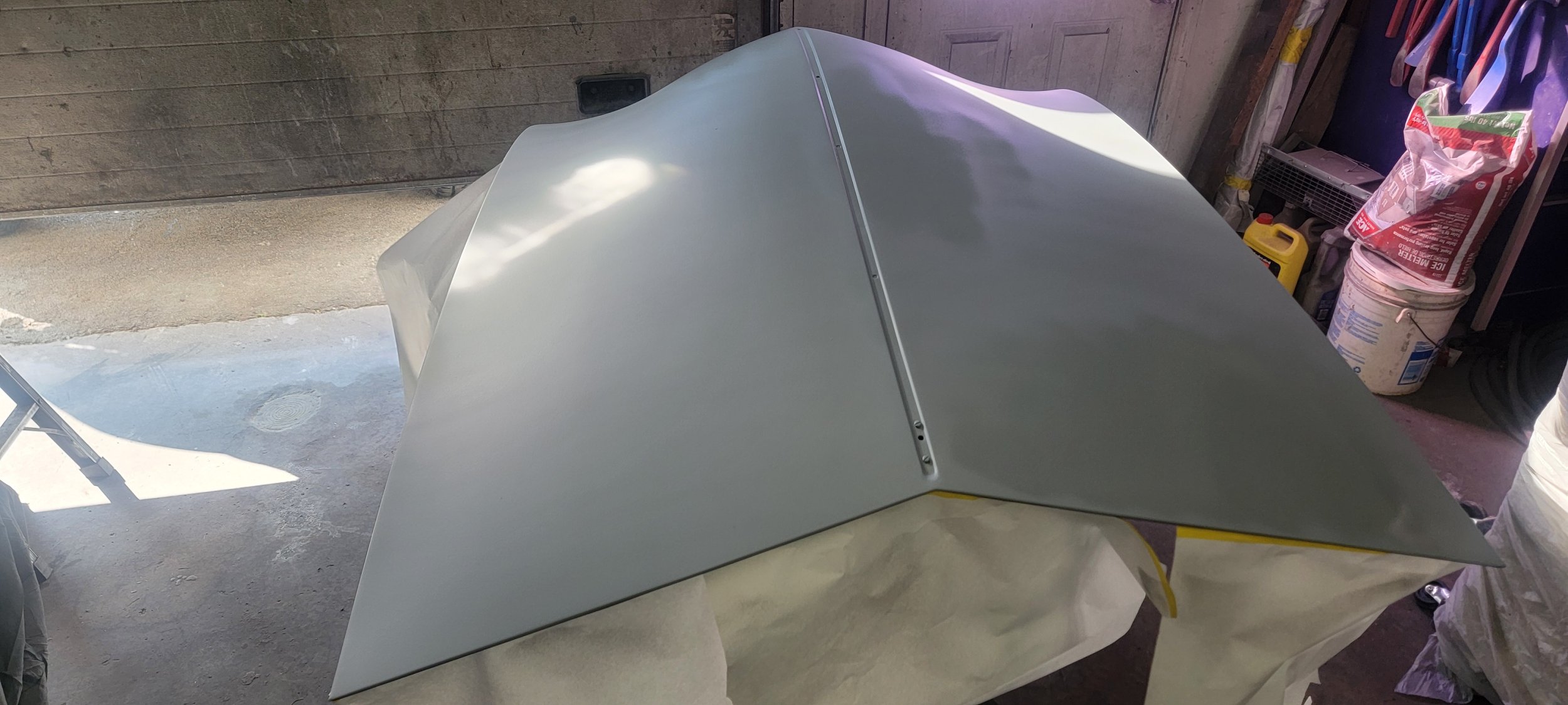

    Couple hrs this AM and the hood is ready for epoxy.
    Went over it with ospho and steel wool. Then chased rust spots with a squared off drill and ospho.
    Cleaned with water
    Dried
    P*** with clean and strip disk on the rotary / graining tool.
    Chased the edges with a Roloc fiber disk.
    Removed one accessible dent.
    I'll mix epoxy and spray it later today.
    Tomorrow I will prep the inside and spray epoxy and the color.
    Now back to my brother's project.
    Alternator in an 86 Lotus ‍.
    3 coats of epoxy later.

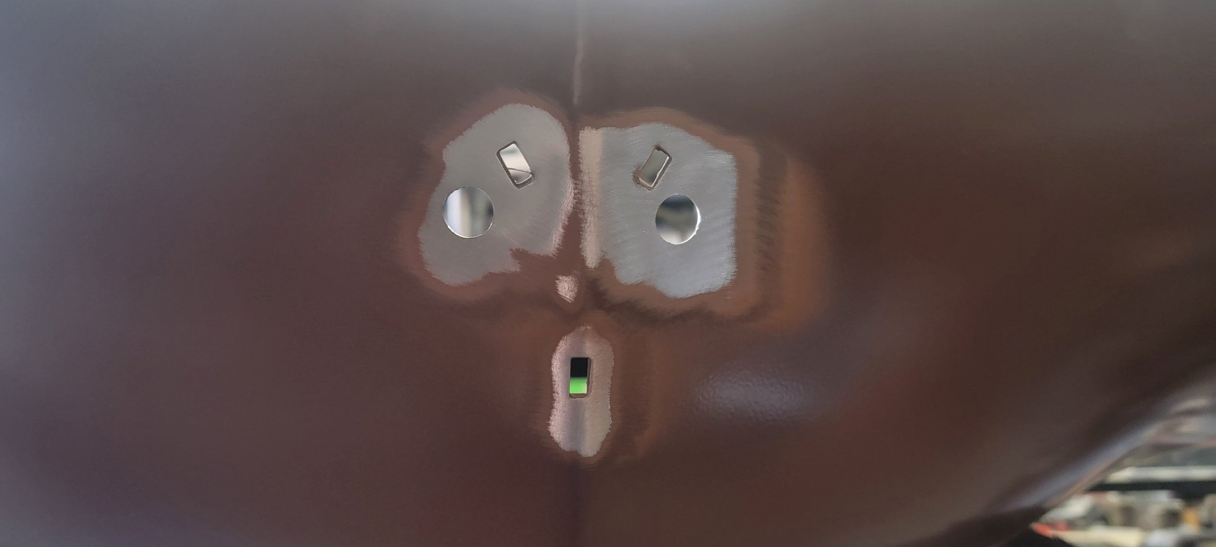

    Welded up the emblem holes
    20250601_072416.jpg 20250601_072834.jpg 20250601_072848.jpg 20250601_072857.jpg 20250601_073642.jpg

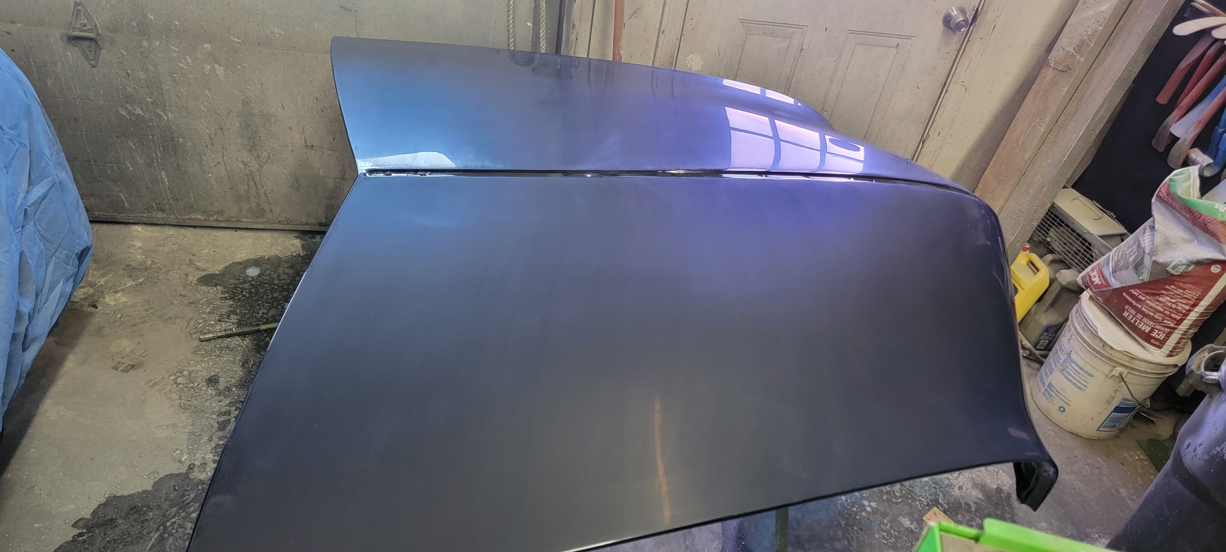

    Outback, Tim, Lepus and 6 others like this.
  23. SinisterSleds
    Joined: May 6, 2012
    Posts: 102
    SinisterSleds
    from MA
    Epoxy nibb sanded

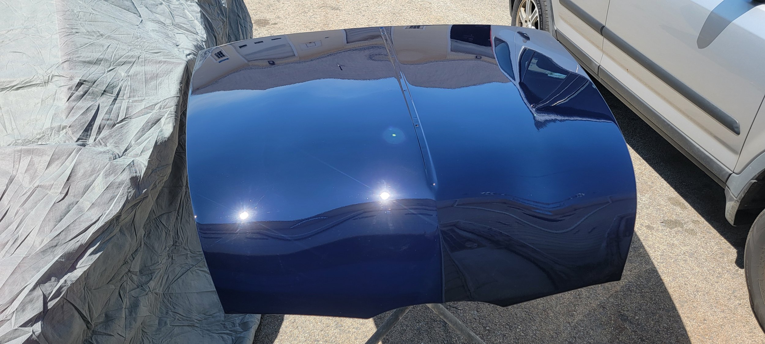

    Color going on today.
    Hood came out well.
    I'll give it a quick wetsand tomorrow and Thursday.
    This means the only large pices that need paint are the front fenders. As the plan is to do some frenched headlights and not knowing the door, fender and hood gaps. Along with wanting to move the engine back further body work will be on hold.
    Next is to get a headliner, find some coupe headliner bows the install the headliner, buff the body, and install the doors and windows then it should be weather tight.
    Tossed it outside for the bake cycle.
    Outback, dwollam, ffr1222k and 13 others like this.

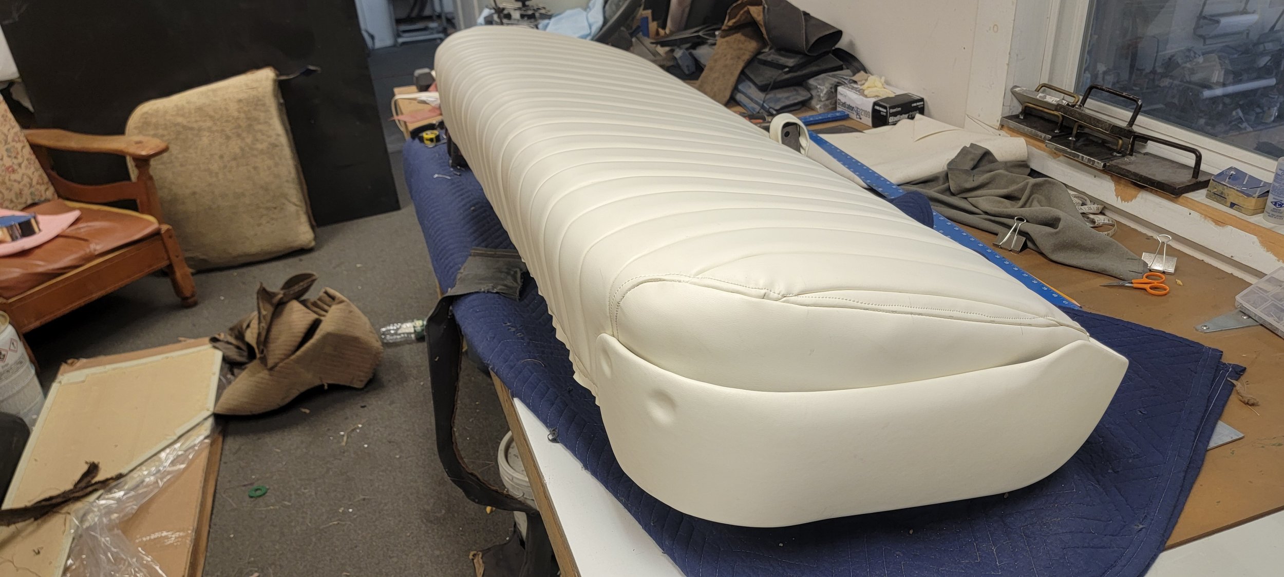

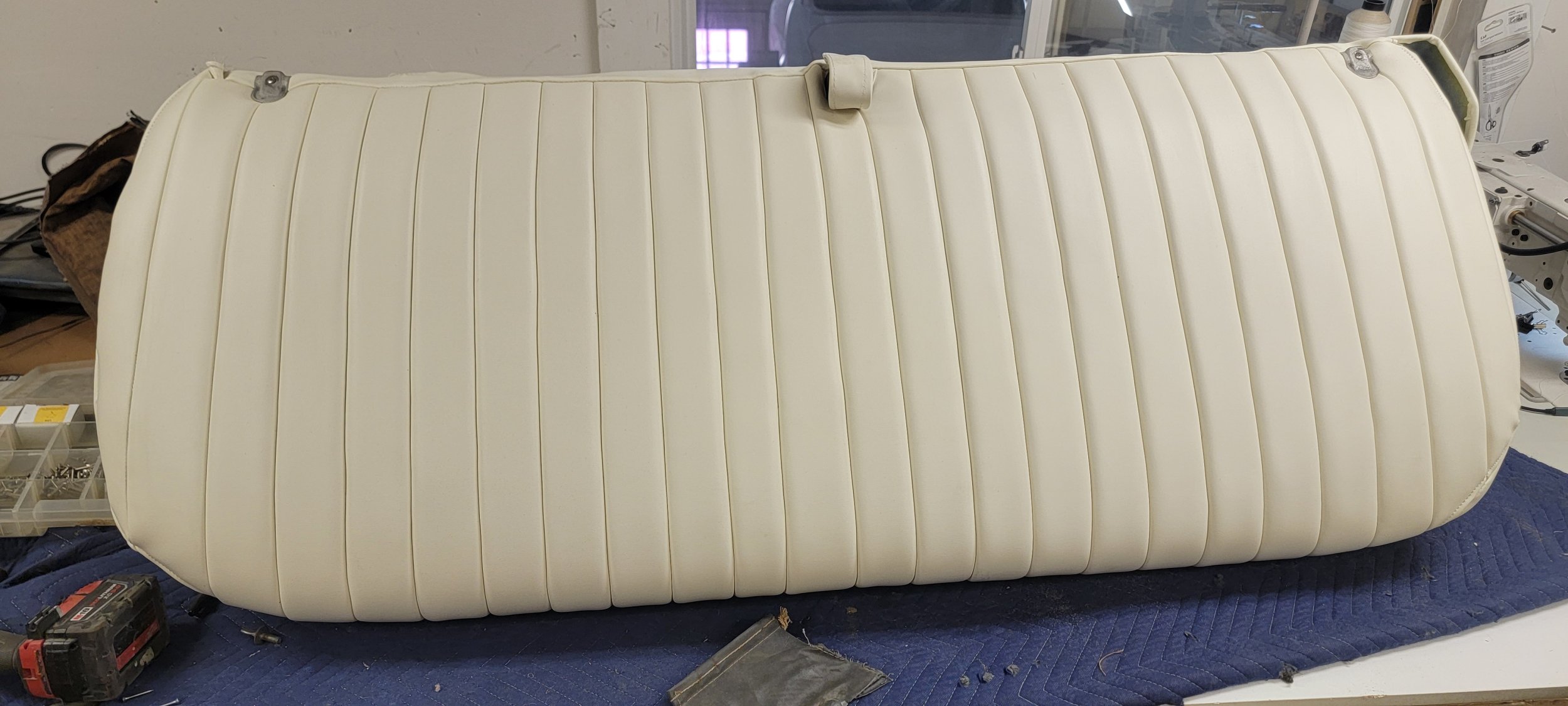

    Been a busy summer. Car is somewhat inaccessible so the body work has ground to a hault.
    Spent labor day trying my hand at upholstrey. I'm fairly happy with the results thus far. Only one mistake on the bottom.
    I wrapped the end covers in vinyl as well.
    I will start the backs over the next couple days.
    3" pleats (end up around 2.5" wide) I was going to do 2.5 but it looked too busy.
  30. patsurf
    Joined: Jan 18, 2018
    Posts: 3,387
    patsurf
    that is your FIRST try?:cool:
