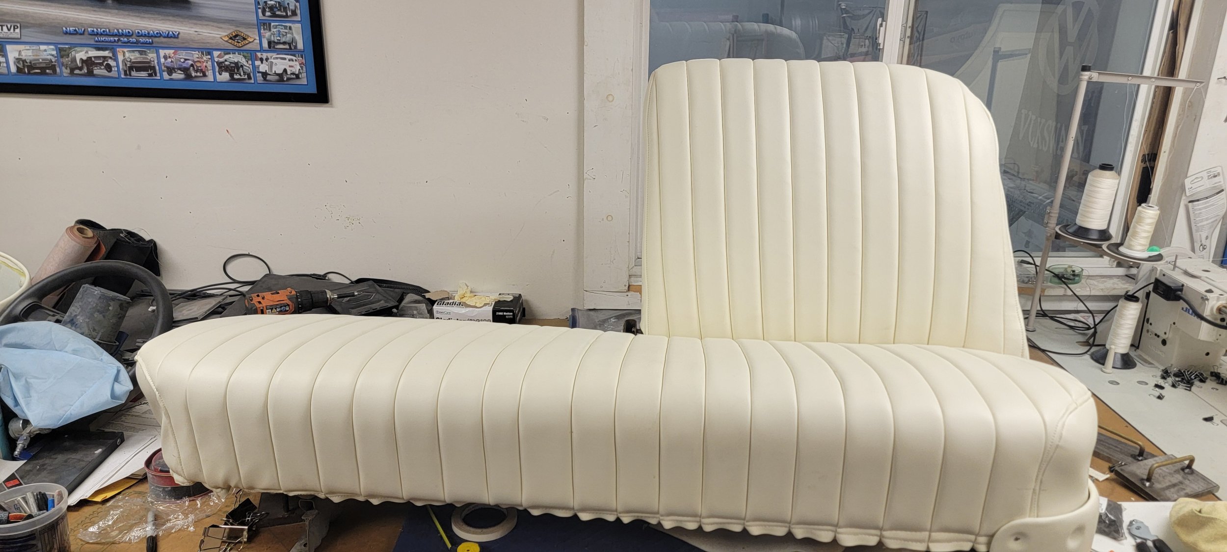

    Yes. Been around it but not really done it. I missed on one of the pleats so 2 are off (one narrow and one wide that taper) but was able to hide the mistake around the front. My top s***ch is a little off. I wish I had shrunk the pattern (existing seat cover cut apart) by 1/2" rather than adding 1/2". I will adjust the patterns for the seat backs when I make those.

    Left of center 1st and second pleats. It's a curse, I'm very critical of my own work, never happy and only see the imperfections.

    As you should be.;) As long as you know. It is hard to see until you point it out.:( Nevertheless, once installed in the car and some one sitting on it while cruising.:cool: Who will ever know besides you? :rolleyes:

    An hr or 2 a day can make a big difference. In this case I spent about 3 hrs (2 this AM before work and took a 1hr lunch)
    Pushed along the driver's side seat back.
    I have to put a flap on the bottom tomorrow AM and I should be able to install it. Im pretty happy. Narrowed all the patterns by 1/2" all the way around to make up for the additional stretch of this vinyl vs original cloth. 20250904_191341.jpg Happy with the pleat alignment back to bottom. Wrinkles should come out with a little steam or when the cover is stretched tight.
    Oh! And it's really comfortable.

    Left side installed. Im a little disappointed with the slight inboard taper of the back pleats. I will lay out the next seat back a little differently and hope to correct that issue.

    It does appear that way, but it may be an optical illusion. Mockup the other side and see if it looks worse or better.

    I adjusted on the other side. Hopefully it will come out better. It's a learning process. As long as i can identify the problem and adjust the process it will be fine. It may just be the way the cover stretches over the old frame and stuffing.
