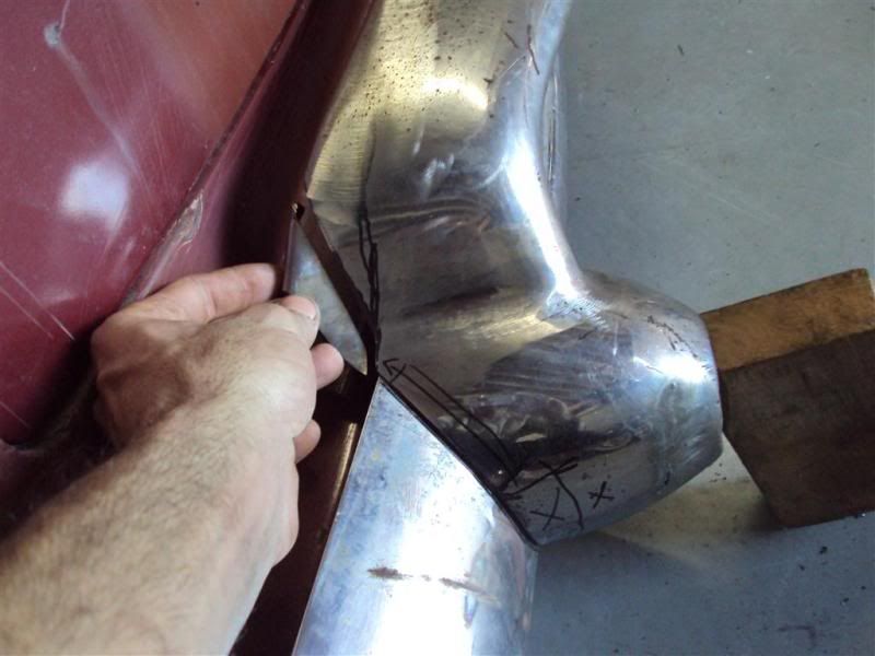

    no not going to weld the guard cause i think the local chrome shop will kill me when they try and plate it. so it will be bolted on. ill use the stock 2 bolt locations on the guard (i torched them off) will weld a new nut then drill two holes on the bumper to line up, also using the pipe (see pics below) i plan to make a second mount behind the bumper.

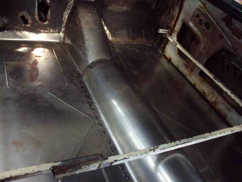

    the floor work is shaping up nicely. worked on the transmission cover and tunnel. hand formed 18 gauge sheet-metal using only wood blocks, a hammer and an oxygen tank...
    used one of my oxygen tanks to form the tunnel and hand hammered the 2 lips:
    so the front part is about done. going to move to the trunk next.

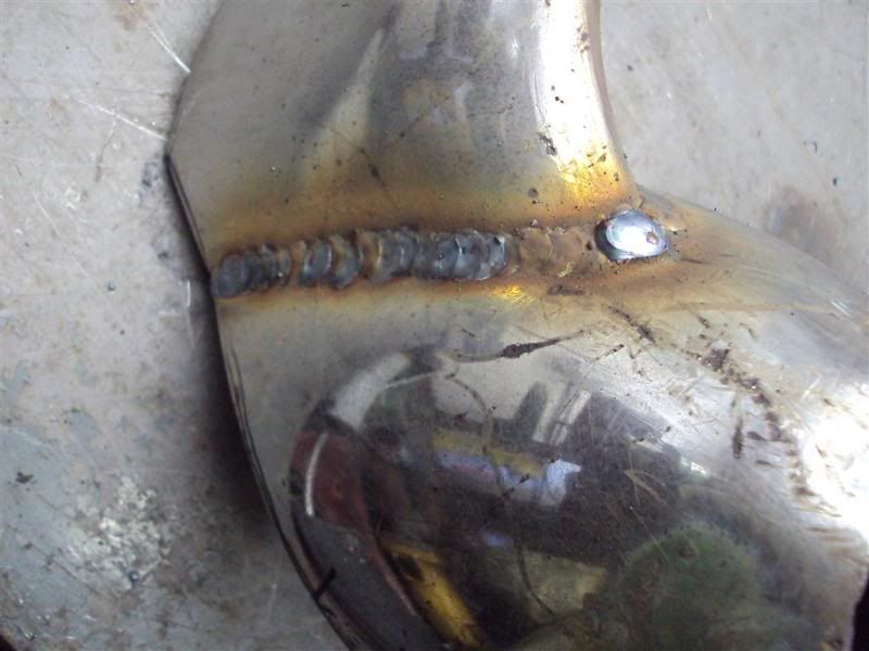

    welded the bullets to the top bar:
    blended the welds:

    got a 6" long 3" outside diameter thick wall pipe, trimmed the bullets to weld it up:
    cut the bumper using a torch to allow the new pipes to slip in:
    hard to see here, but the pipes are welded and blended to the Kaiser bullets for a smooth finish. later exhaust pipes will simply slip into the large pipes about 1" so they are not visible:

    today i was able to wrap up the floor work upto the notch. the notch sheet-metal is ready to go as soon as i put a few bends in it.

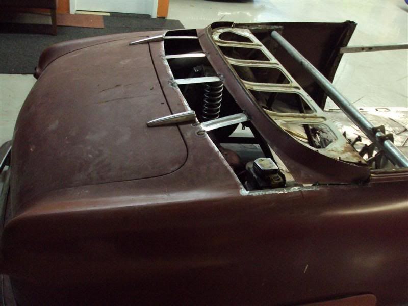

    while doing my daily research (basically looking at the pics of the shoebox Paul Bragg worked on) noticed a b-pillar lower brace, so i improvised and made my own. knowing that when the roof comes off there would be tons of work to do, figured the roof should come off tonight.
    tomorrow and sunday plan to chop the front windshield, think 4" will suffice, and going to cut out the rear package tray so that i can move it forward. this will elongate the trunk and give the profile the appearance of a real convertible.

    cut out the rear package tray. moved it forward 6" then another inch for a total of 7. after ****yzing countless profile pics of Carson / Gaylord top shoeboxes i think this will put the new roof where it needs to be:

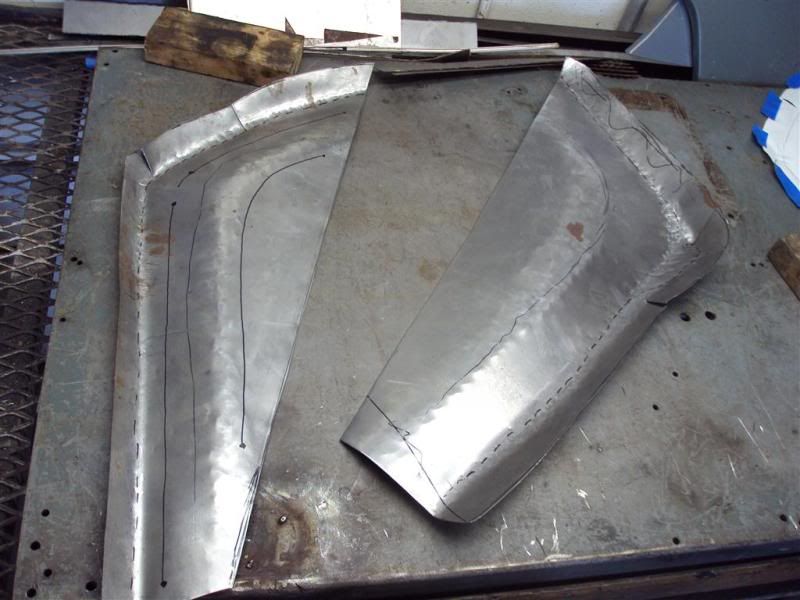

    Sunday progress...

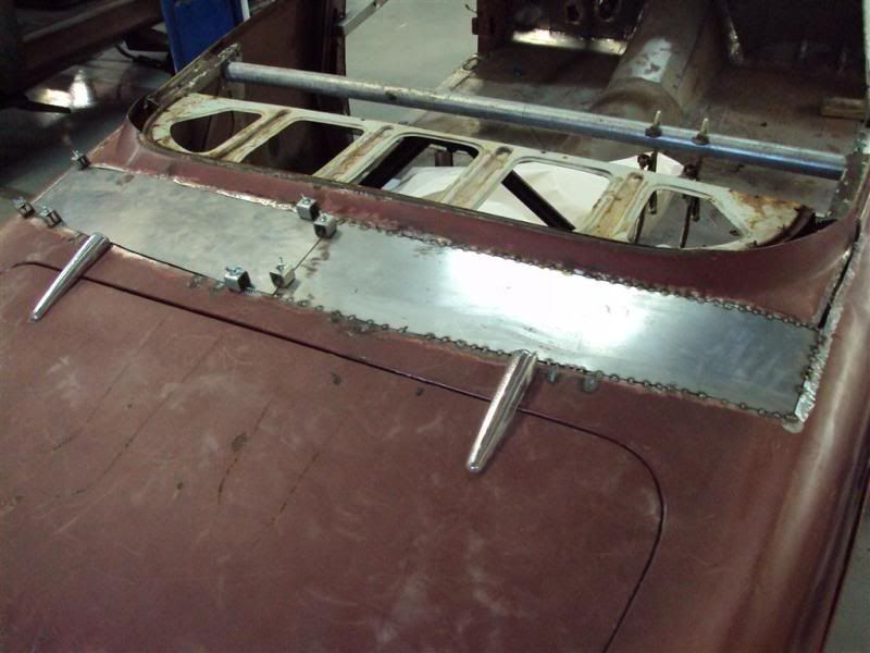

    not too much to show for today, took the Buick out for a nice cruise with my pal. then once he headed off i stuck to the shop and pushed forward on the package tray work.
    started off by making a paper template:
    followed by splitting it into 2 and making them out of 18 gauge, worked one side at a time:
    then worked the driver side:
    in the end the 7" gap is filled. everything lined up nicely and its all tacked in place:

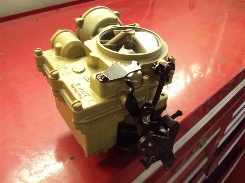

    after the acid bath, the carb got cleaned, detailed and rebuilt:

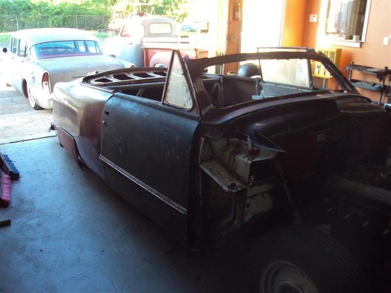

    hoped in my shop truck this morning and drove North for a good 2 hours, what for? Vert doors!
    got back to the shop and placed them on the car, they will need some adjusting to look at home but they are worth the effort.

    yeah but the vent windows are too tall....haha
  25. Yaril
    Joined: Mar 13, 2006
    Posts: 989
    Yaril
    gimmi a couple days hahaha
