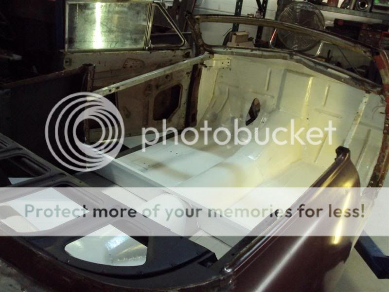

    put her on the lift to see the floor bottoms, look good, just 1 required a little trim and some hammering, all seams will be seam sealed and primered and undercoated.
    i dont have a sheet metal bender and had been waiting for weeks to use one. well i got tired of waiting. the trunk and notch floor had been cut and bead rolled weeks ago, so i took matters into my own hands. used the truck bed to form the notch sheet metal. i must say it came out great!
    so the floor are complete front to back. this week i will finalize some small areas that need m***aging.
    plans are to pull the body off this weekend for the last time. seal the bottom of the body and clean / paint the frame so i can bolt the two once and for all. i will need them as 1 to really work the doors being that now its a vert with more flex its gotta be bolted down for final adjustments.

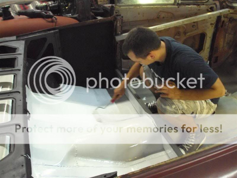

    so i had a couple of pals offer their night to help me with the shoebox. granted they are not car builders, but every bit of help gets the car closer and closer. we put in work till about 2 am.
    Eric came through and wire wheeled the frame rails and rear of the frame. it looks very fresh and clean. all that is left now is the bottom of the frame and some of the front suspension areas. Thanks Eric!

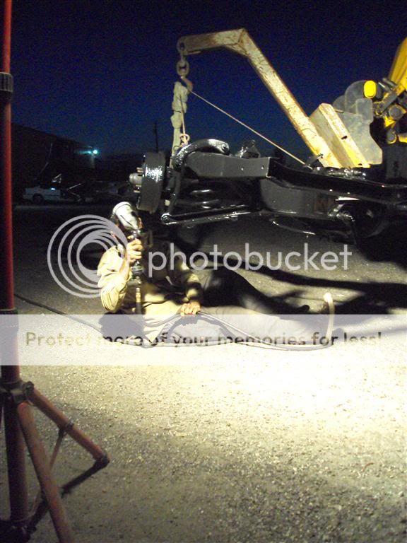

    great weekend! not much to show for it. lots of little things. getting the trunk latch (using a bear-claw universal one) installed, wrapping up some frame welding and finished cleaning the frame for paint.
    lucky for me my pal has construction equipment to hoist my frame up with so i flipped it on the side and was able to wire wheel it real good. also used it to paint the frame.
    while everyone tells me i should be at the beach or take a day off i worked. Sunday night:
    well worth the sacrifice:

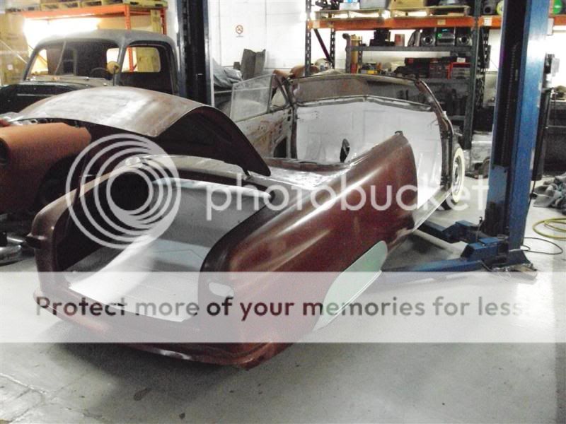

    all new body pads in place to set the body on frame for the last time...
    body and frame together. its a roller once again with all new hardware...
    now progress can be made on the body, hanging the doors properly, framing for the padded top, front fenders ext.
