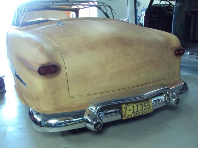

    well Daytona TRR is around the corner. i am focused on making the car run and drive now. most of the work now isnt picture worthy but ive added just a few. have been wrapping up the brakes, steering (the box is over at shoebox Ford thanks Chris!), wiring, fuel lines ext.
    i bought one of these low mount Mr Roadster alternator brackets wishfully thinking it would work on my application. not the case, but a little cutting and welding got it there. had to lengthen the adjusting arm and i added a thick top brace welded to the spacer and adjusting arm. it feels very sturdy. hope it will work.
    here is a shot of the rear, most of the car mocked up.

    so this weekend i took 3 steps back but 5 forward. decided to cut off the last 3 ribs on the roof frame. they just were not working correctly. Paul Bragg was nice enough to help me out in getting much better flow into the back part of the roof.
    before shot, see how its a bit "peeky" for lack of better words. the profile is fine but not the contour.
    after shot, now its got a soft curve going all the way to the crown. everything seems to mend nicer going into the rear tray now.
    then it was time to make the 2 sails so the material wont flap around or have wrinkles.
    glad i kept the old roof around. see i dont have an English wheel so i have to use what i got. simply my cut off wheel and the right shape off the roof will do.
    using the orignal roof skin worked nicely it curves around the back and is sturdy. next step will be some chicken wire!
    so Daytona TRR is 2 weekends away. here is the run down. my steering box should be back this week, then i can wrap up the exhaust manifold and install some exhaust! the driveshaft is ready so ill get the at today and installed. the wiring is about 80% done. brakes need to be blead and adjusted. front end needs the alignment shop. seat is being upholstered this week. gl*** needs to be made. rear shocks need installing. im sure i forgot a million other things. point being, the car WILL be at Daytona! so long as i can have it running the night before at least, then i will load it up and trailer it up. i can not see myself risking the drive in a car i havent put 1 mile on. my "test" drive will be from the hotel parking lot to the track. the car will be in primer / guide coat with trim, bumpers and vent window along with the roof skeleton installed. i hope i can make all this happen in time.
