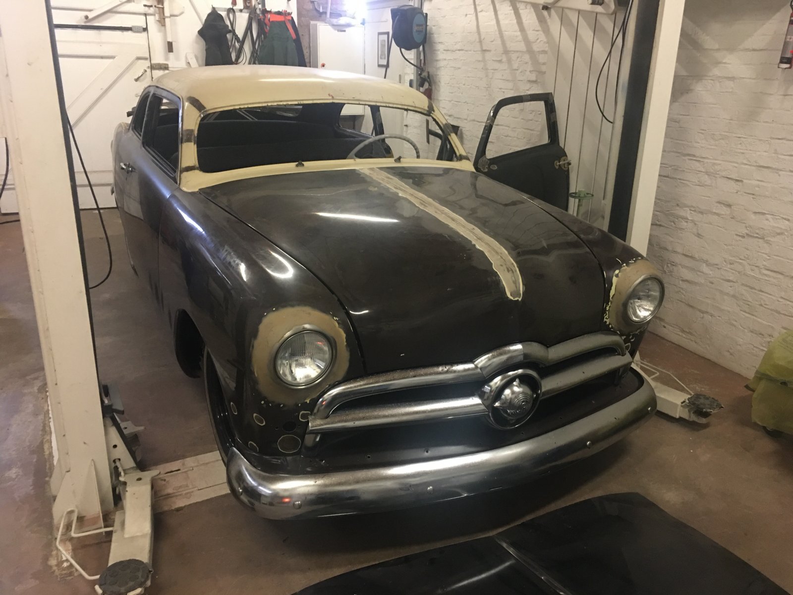

    Moin and hello from northern Germany.
    Let's see if I'm able to do a short project introduction:
    I've seen the car first in 2009 when I brought parts to my media blasting guy Peter. Been deeply impressed, that he was building what I've ever dreamed of and said the well known words: If you ever consider selling it, I'm gonna take it.
    It took me some years to get some minor car projects and major house restoration ready but one afternoon in Feb 2017 I thought, well, what ever happened to the '50 Ford, is it still there?
    So I've called Peter and obviously I had luck because the car was still with him and he was just ready to let it go.
    Very exciting to bring home what I've wanted for such a long time but after parking the shoebox in the shed and checking all the items that came with, normal life came back in form of other tasks being important and urgent and not only an old dream.
    So I've checked 2 or 3 times a year if the little dwarves have made some progress and what I could do to achieve progress beside hoping for miracles.
    I the end I realized it's plain simple, I have to give it a go NOW and don't wait another year because there will be always something other to do and maybe more important.
    So that is what I've got now, a `50 shoebox fordoor converted to a tudor with a decent chop, an 8BA and an overdrive gearbox in a non drivable condition with a lot of work to to. All the chrome parts are very good, I think they are rechromed and '49 style. Wiring is almost not existing, condition of drum brakes unknown and tires to be replaced. But this car does already have historical paperwork being a big advantage in Germany for customized cars.
    What are my plans?
    Hmm, I guess I'll try to get something close to period correct early 50 Kustom style, somehow radical because of the chop but somehow mild because of not shaving door handles and probably leaving the hood unpeaked.
    As I don't know nothing about the flathead, I'll take it out and do an intense check for cracks and if this mill is worth to be restored or if I have to look out for an Y-block maybe.
    Aerostar springs are already here and the rear leaves are going to be flattened a little bit but nothing extreme, the car has to be normal drivable without rubbing tires in fenders or like. Skirts are a must and I think it'll get a little dragging stance.
    Not sure what to tackle first, but I've bought a spare wheel boot bottom from a Saab 9-3. This is going to live in the place where now the gasoline is stored to get rid of the awkward spare wheel in the middle of the trunk. The new tank from a '90 Mercedes is going to sit right on top of the rear axle hump.
    I hope that it is at least of a little interest for you showing up here with another shoebox build, because a lot of you might have seen quite some of them during the years. But I can't imagine another forum to better fit this project and for me it is much appreciated to get some advice.

    Great starting point. Car looks nice. Chop is great and as you said the chrome looks beautiful. Look forward to seeing you get down to business!
    Where you at in Germany? I used to live in St. Moritz and made it to Germany a few times. Spent a while in Hamburg. Didn't get to see enough though, I'll be back some day when my son is older...

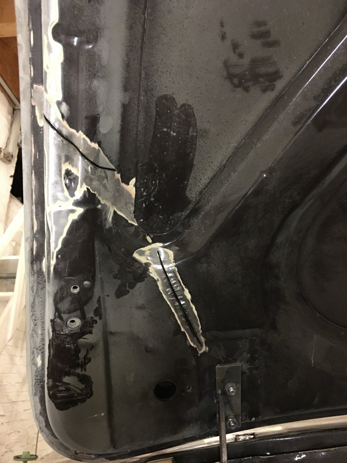

    First thing to tackle is the trunk lid. Seems that it’s a 49 lid with a welded on 50 number plate surrounding. Outside hinges are gone but the hidden inside hinges are without any connection to the car.
    How do the original 50 hinges look like, do the have this G shape?
    When the lid is working I‘m going to take out the bottom of the trunk. It will get a lying spare wheel bulge and after that a gas tank sitting behind the rear bench.

    As usual things at old cars are worse than they first appear. I guess the deck lid originates from a 49 so having outside hinges. Yesterday around 8 layers of paint came off and I had to reopen two releaf cuts of the inner frame to get the top left corner flush to the extension panel.
    There are quite a lot dents in the deck lid, lets see what the spot welder dent puller is able to.
    I have to reshape the lower left corner of the lid also where some spe******ts closed minor rust holes with a small sheet metal patch and a lot of lead. You can imagine how the lead flux has worked inside the gap.

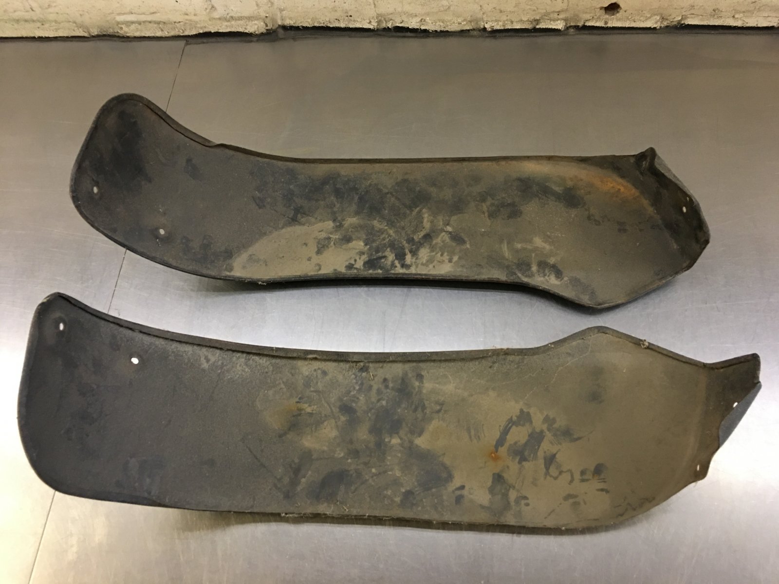

  29. Those are front seat lower skirts. They cover the seat tracks, so you don't see them when you open the doors.

    Ahh, ok I though somewhere around the wheels.
