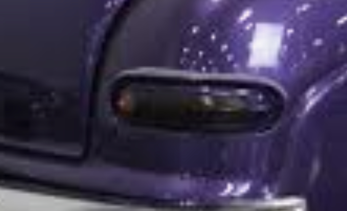

    The bucket part I think will be easy but not sure how to do the edge where slopes down. I don't want it to look like a tunneled tail light, more like it is transitioning into the quarter.
  4. Build the basket/bucket outward from the body the distance for the lip. Tac in place. Then build the transition or lip into the body

  5. Here’s a few pics
    CEB1630E-7708-4610-AFE8-3A5FFCC7A7A8.jpeg 8E0B01C6-8B19-413A-9B9E-95113CB1BA9D.jpeg E75520D2-7352-49F4-9257-3982AAB39CB5.jpeg

    That makes sense, then from there it'd just be trying to make them even side to side.
    anthony myrick likes this.
  7. That’s the hard part
    Use the tape templet/pattern method to help make em match.
    Raising the deck lid and lay out a tape line between the qtrs can help.

  8. More on bates lights this time on a 36 Ford, they look good.
