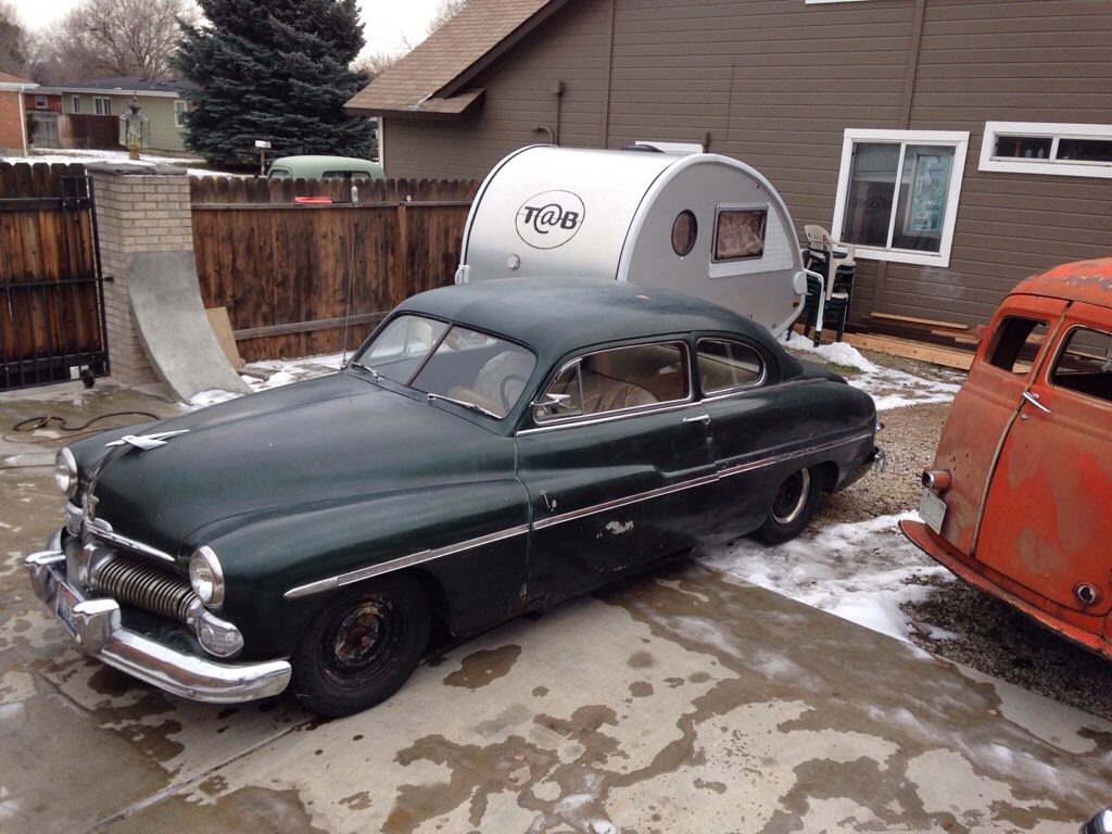

  3. Danger
    Joined: Jun 18, 2010
    Posts: 145
    Danger

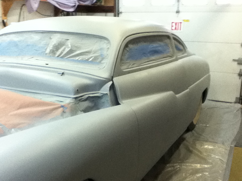

    Sprayed the rockers and fender also got my hands on some original 51 skirts. Should be getting my rear suspension this week, get the cat a little lower. ImageUploadedByH.A.M.B.1395235394.462475.jpg

  9. Danger
    Posts: 145
    Danger
    Thanks! Your merc looks great, how did you lower the rear?
  10. Leadsled612
    Joined: Sep 9, 2010
    Posts: 466
    Leadsled612
    3 inch lowering blocks and a leaf spring removed

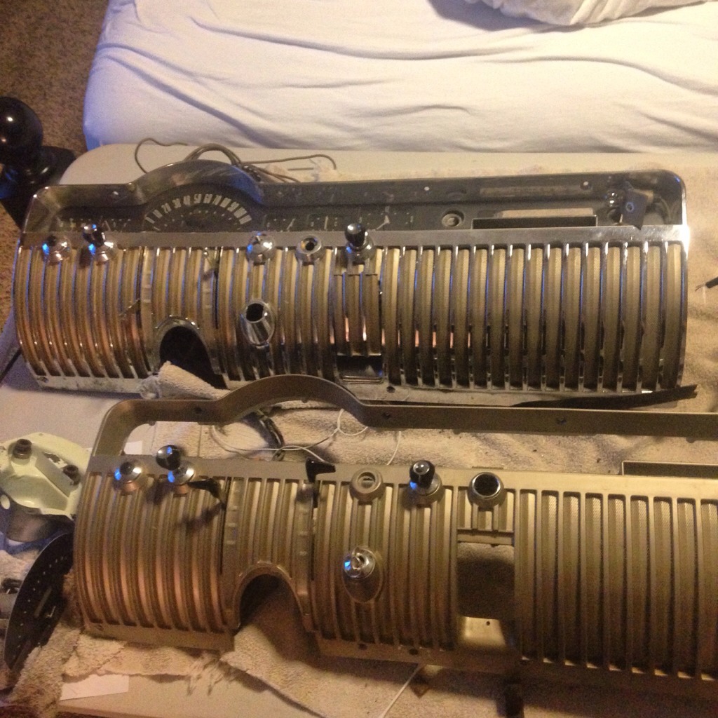

    Question- while I have the dash I kinda was thinking about sending the gauges out to be rebuilt to 12 volt? This would eliminate the need to step down the voltage to the gauges right. Who should I send them too? Any tips while the dash is out would be appreciated. ImageUploadedByH.A.M.B.1396764386.655372.jpg ImageUploadedByH.A.M.B.1396764401.164035.jpg ImageUploadedByH.A.M.B.1396764411.781001.jpg
    kiwijeff likes this.
  16. I just saw these on ebay the other day. How do you like them, & do you know what gauge they are? Nice car, I am in the middle of taking everything off the body on my 49 Merc & need rockers, inner, upper & lower.
  17. Eric H
    Joined: Apr 2, 2006
    Posts: 975
    Eric H
    The stance looks great! Ford used a voltage regulator for many years after converting to 12v. Mac's sells this part as B9M2-10804-C.

    Anybody have any experience polishing one of these dashes? It's pot metal but looks like the paint could be removed for a polish look. I have two dashes and plan on making one nice dash, the painted on is in better condition but I want a polished look. Can I just lightly sand the paint off? Thanks. ImageUploadedByH.A.M.B.1397536167.783986.jpg
