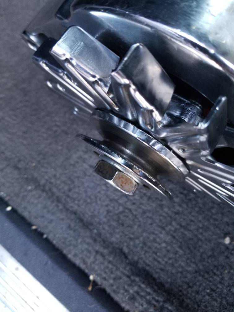

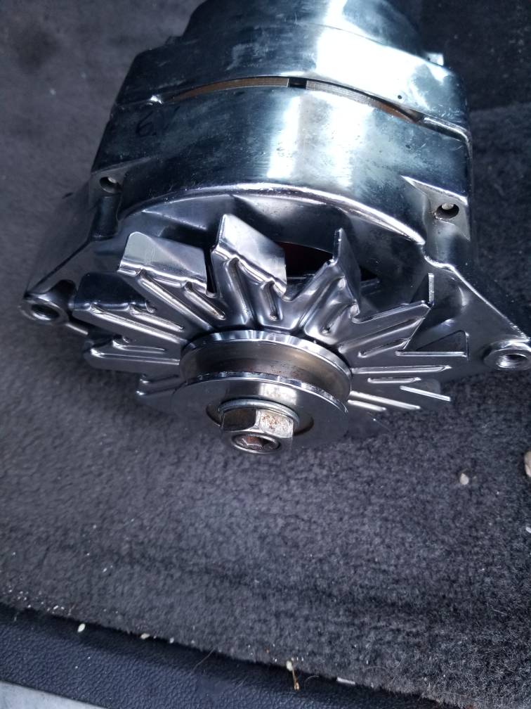

    Hi guys im new here and i just got a new (to me) 50 merc! Very excited about it and excited to be a part of your guys forum! So the car is 6v stock came with this chrome generator/alternator? That the bearing died on it. Sent it in to get rebuilt. Got it back put it on as i tried to start it smoke started coming inside the cab. Jumped out and saw the generator was smoking. Quickly took off the battery cable. Checked for anything on fire (nothing was) so the question is 1- did i cause damage and 2- what the heck happened? I can see inside the generator everything looks modern if you will ill post some pics. Thank you! First 2 pics of what it looks like before taking it out the other pics are close ups of the insides. Looks like a big orange disc inside im confused and frustrated! Thanks again in advance! 20190403_123831.jpg 20190327_174554.jpg 20190409_190447.jpg 20190409_190434.jpg 20190403_123831.jpg 20190327_174554.jpg 20190409_190447.jpg 20190409_190434.jpg

    You have an alternator - not a generator.
    The picture taken of the rear of the alternator shows the bridge rectifier ***embly.The red "disc" inside is the rotor.
    Your rebuilder probably rebuilt the unit using 12 volt parts. Yank it off and go back to whoever rebuilt it and *****!
    Hard to say what got cooked until you get it running again at the proper voltage.

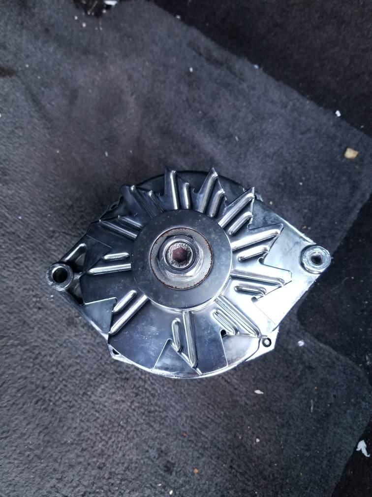

    Thank you! So the guy that rebuilt it was a ***** he doesn't understand what im trying to say about positive ground so my next question would be if you guys can point me to a alternator to fit my application i can buy on line. Here is a pic of the alternator as it is now. Thanks for helping me out 20190410_075326.jpeg 20190410_075328.jpeg 20190410_075335.jpeg 20190410_075400.jpeg

    You might check with Smith Auto Electric in Yakima Wa. They are used to odd ball stuff and don't flinch. They are also car guys who understand old cars. They do do stuff that is mailed in and mail it back.
    http://smithae.com/
    Who ever you go through tell them exactly what you have and what you are up against.

    If an auto electric company, you should ask them if they can fix the one you have cheaper than buying another new one.

    A six volt positive ground alternator would be a standard Ford 8N or 9N tractor upgrade They aren't cheap but should be rather common.

    And just noting that you have an alternator, which WE all know (you too now), But- Better check pulley grooves, because if you have a wider belt for the crank/WP's, that Skinny Minnie alt pulley wont jive for too long... Everything has to be the same, or- you put thinner belts on everything......and then....... Good luck.;)

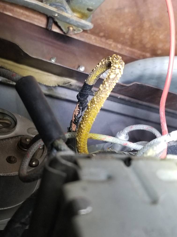

    Thanks guys heres an update so i did a good inspection under the dash and got this pic . Seems like the rest of the wire bubbled but nothing crazy like this. .. here is the alternator im thinking about.
    https://brillman.com/product/6-volt-one-wire-alternator-40-amp-positive-ground/ 20190410_175946.jpeg

    Hey guys quick question. So im gonna order a 6v positive ground 40 amp alternator from brillman and i wanted to replace the yellow wire that got fried (posted a pic above) what gauge wire would i order? Seems as if the yellow wire was the one that was overheating and as you guys say "let the smoke out" lol just wanted to verify if my order and application is right with you guys first. Have an awesome thursday everyone!

    40 amp should be fine, stock it was 36 amp. Replace the wire that burned with the same gauge or next size bigger. A wire stripper with the wire gauge size marked on it will tell you what gauge the burned wire is.

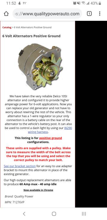

    Ok sounds good i went ahead and ordered this guy from quality power auto since they are a bit closer. I appreciate all the help. Ill keep yall updated![emoji2] Screenshot_20190411-115206_Chrome.jpeg

    At 60 amp output that may fry your amp gauge. Or put out more than you're wiring can take.

    I’d suggest you follow these guys suggestions. You were on the right track and suddenly took a left turn.
    Don’t install a 60 amp generator in your system.

    Ok great so the 40 amp this alternator makes is spot on for me right? Just wanna be 100% before i order lol

    Yes, go with the Brillman unit.
