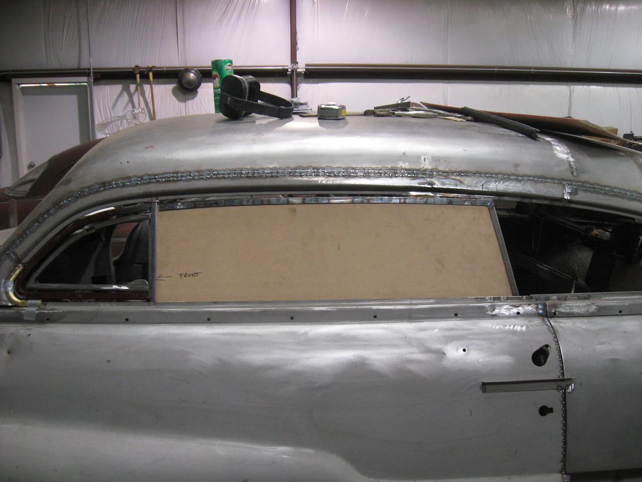

  4. slddnmatt
    Joined: Mar 30, 2006
    Posts: 3,691
    slddnmatt
    craigs 50 040.jpg craigs 50 041.jpg craigs 50 032.jpg craigs 50 070.jpg craigs 50 071.jpg
    Welding, welding, and some more welding...When creating a Hardtop, and you want to have functioning windows for it to seal, you have to try and think a few steps ahead of what your doing to not screw yourself up. Revamping the door jambs to accomodate weatherstripping and stuff can be a PITA!

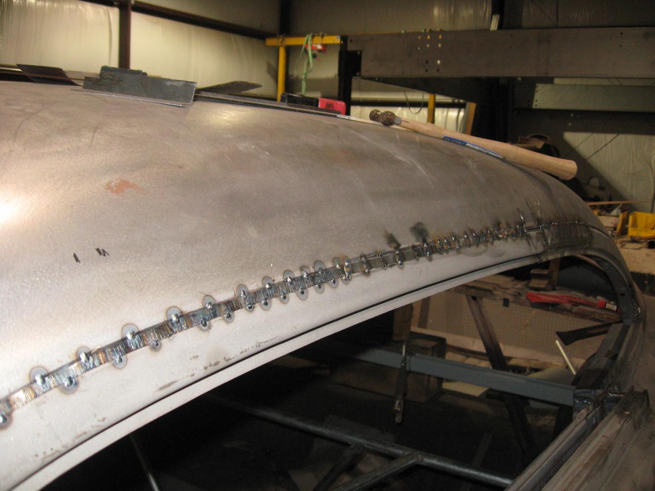

  5. slddnmatt
    Posts: 3,691
    slddnmatt
    Now the fun stuff, creating all the window frames. I opted to make a new vent window housing frame since it would be visible and needed to be sturdy enough to hold the vent frame and not be attached to the top of the door. After the frame was finished and reshaped the vent frame and shortened the division bar.

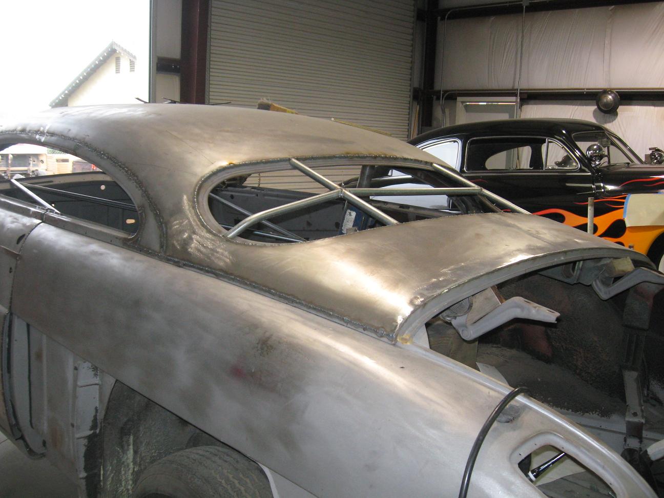

  13. slddnmatt
    Posts: 3,691
    slddnmatt
    craigs 50 090.jpg craigs 50 047.jpg craigs 50 048.jpg craigs 50 085.jpg craigs 50 091.jpg
    Never hurts to see pics of Mercs Verbal Kint!!!

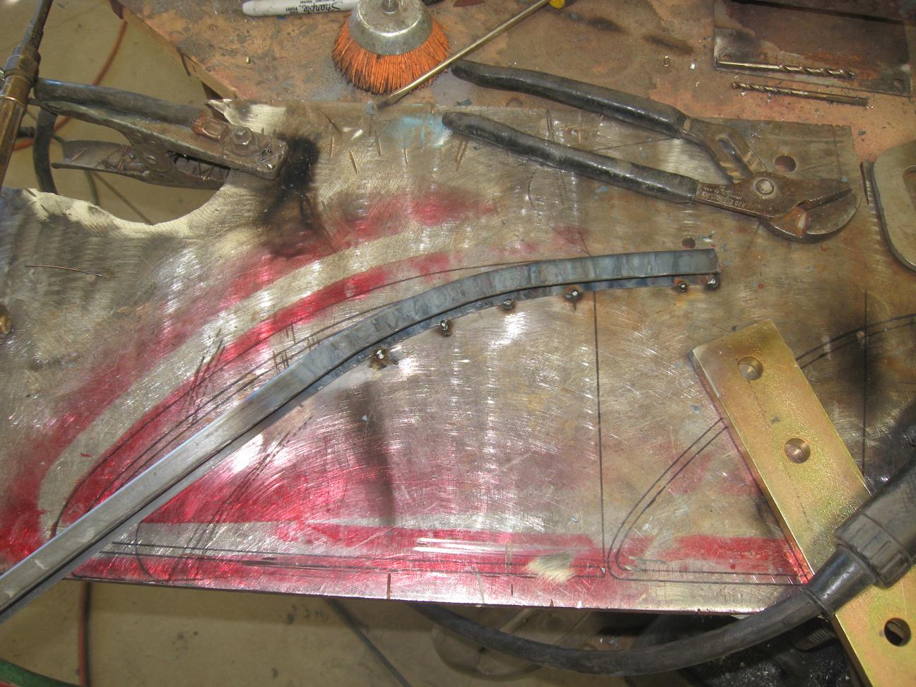

    I made the frames of the windows out of some 1/2"x 1" rectangle tube then trimed it down to 5/8"
    If I have to make these again in the future, they will be from stainless, REALLY ****S when the chromer's screw up the shape and all your perfect fitting edges...

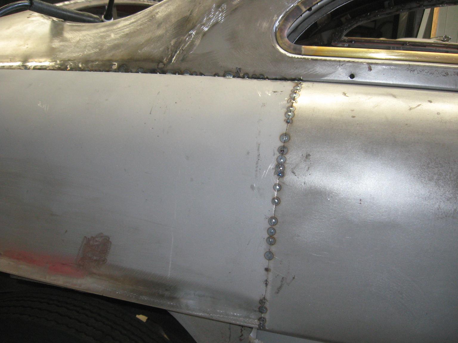

    Once everything was sand blasted, I trimmed off the 50 rear 1/4's. I had pics of this process, but I believe they were on my phone which just happened to fall in a pan of ****** fluid...Ooops..I left a little 1/4" flange on the top part by the body seam to let the new panel rest on. When I cut the 51 1/4's loose from It's body, I used a thin cut off wheel to keep as close to the edge as possible to retain as much metal as I could.
    The 51's peak along the top edge, is pretty much the full length of the upper 4 door 1/4. So I used almost every bit that Chad had sent me. I marked everything out where I was happy and made my cuts and once fit and tacked on, everything lined up really well. Then on to some tedious welding/ grinding and some dolly work...

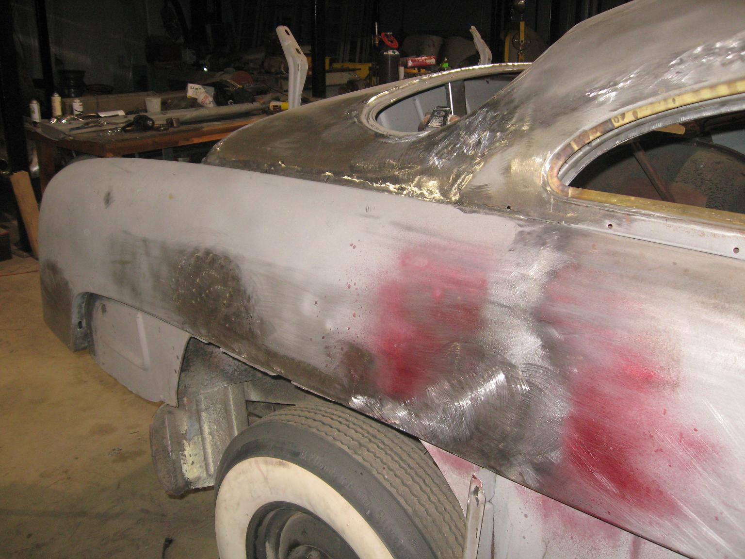

  28. slddnmatt
    Posts: 3,691
    slddnmatt

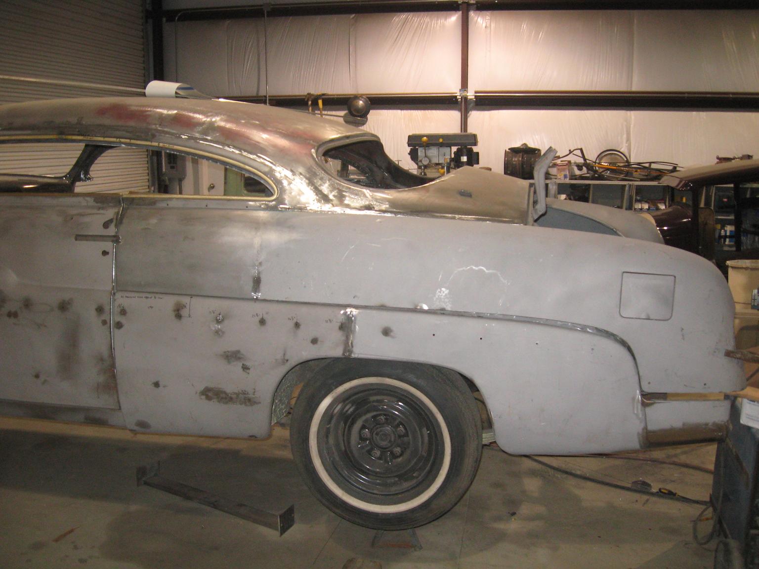

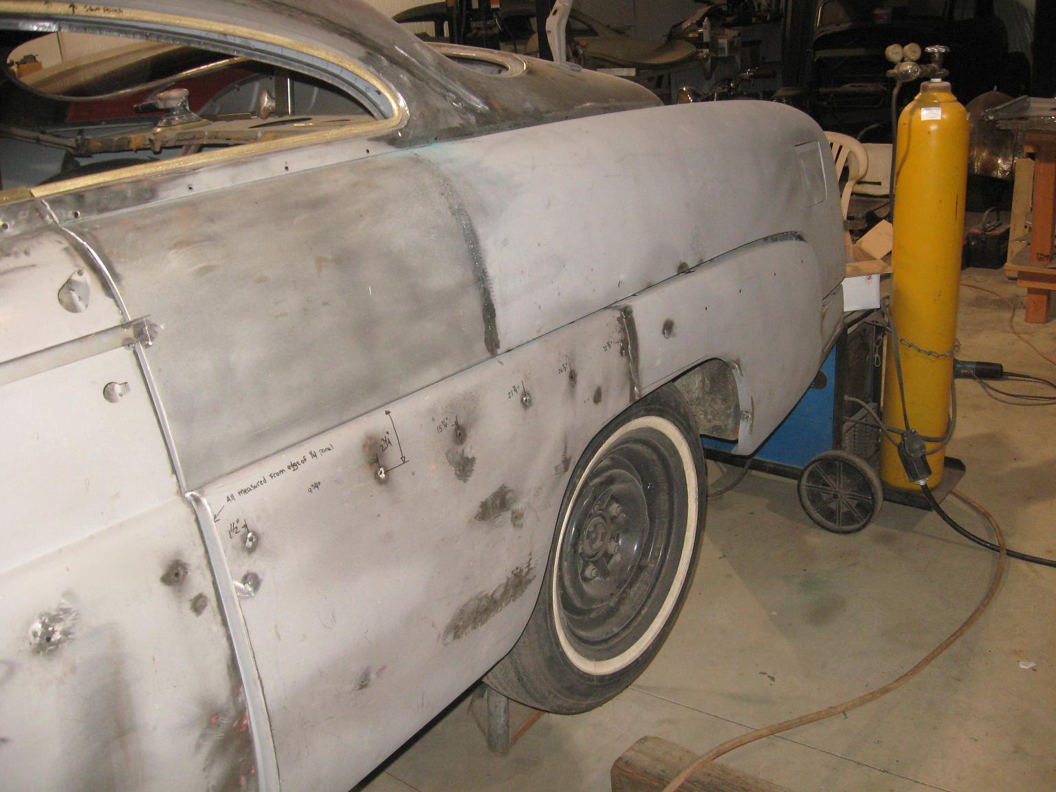

    Ok a little update on the build from where I left off. Been a bit busy, my wife had our second child a couple weeks back and I forgot how much sleep you don't get with a new born!! Got the upper and lower 1/4's all smoothed out and dollied, then gave the body a once over with the DA before I shot some epoxy on it. This car was 99% rust free but had some bad previous body work so I opted to trim off the p***enger rocker and replace the skin. Firewall was left stock, just filled in some holes...

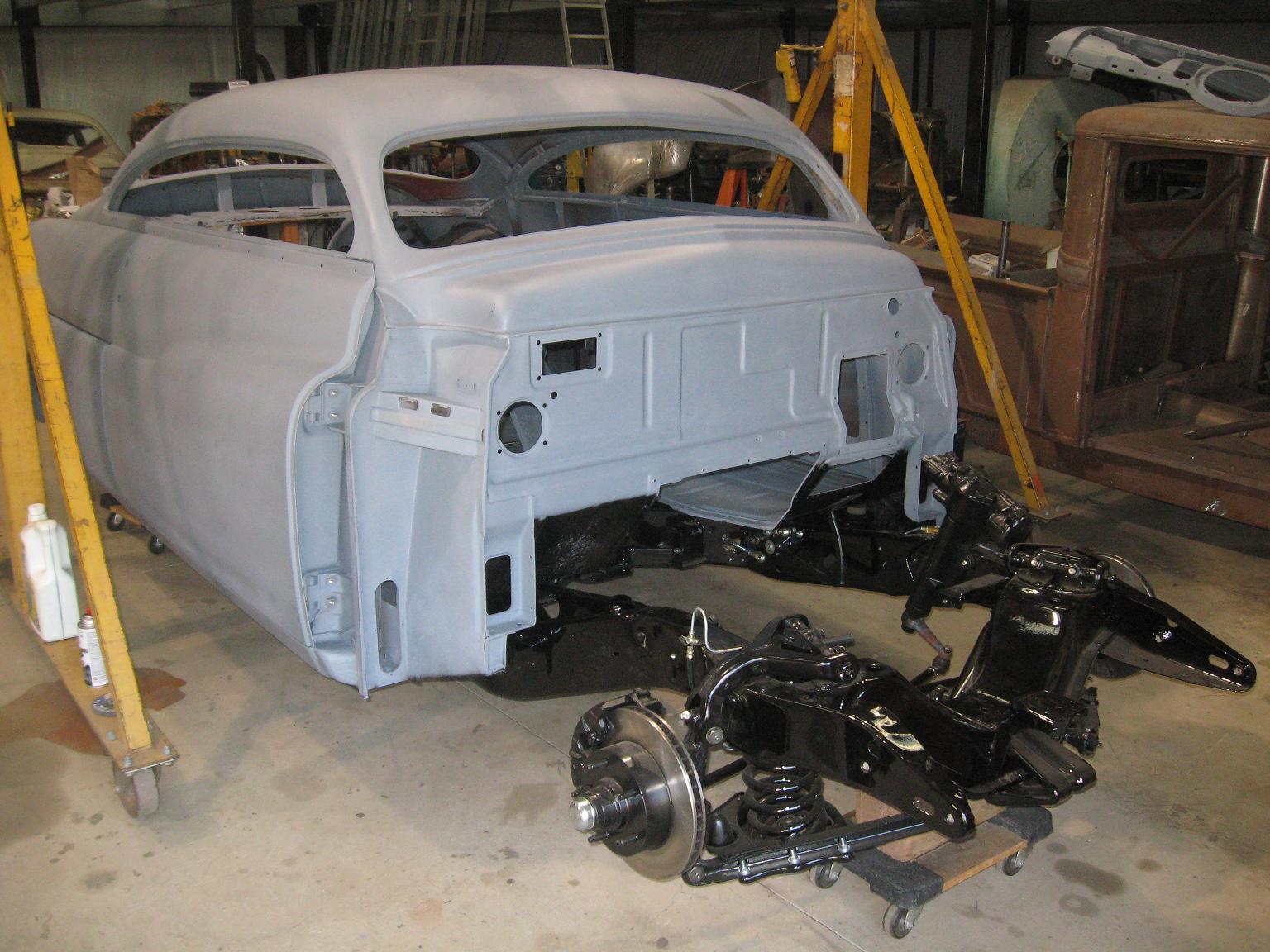

  29. slddnmatt
    Posts: 3,691
    slddnmatt
    craigs50 117.jpg craigs50 100.jpg craigs50 102.jpg craigs50 110.jpg craigs50 113.jpg craigs50 115.jpg craigs50 111.jpg [/ATTACH] craigs50 110.jpg craigs50 113.jpg craigs50 115.jpg craigs50 117.jpg craigs50 102.jpg craigs50 110.jpg craigs50 113.jpg craigs50 100.jpg

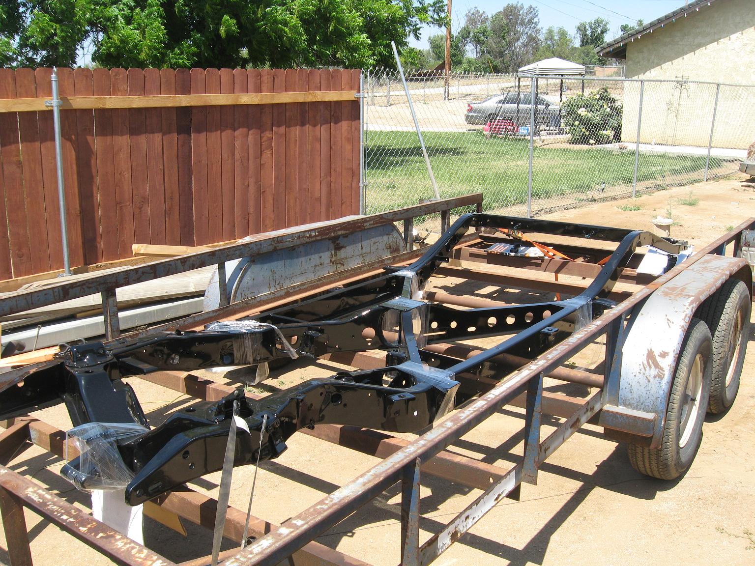

    Picked up the ch***i from the powder coater and started running the fuel and brake lines, then got the body sitting back on the ch***is. Owner wanted to keep this car simple so a bolt on disc kit and dropped spindles is what was mounted up front. The rear is running a block.. You got to love Merc floor boards when they are as purty as that!
