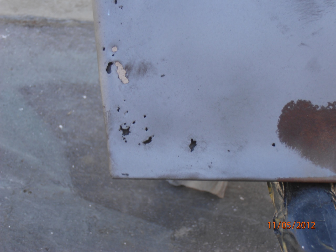

    Here are some recent before and after photos of the trunk lid...I'll have more detail photos when I visit the car in a few weeks. It looks to be in good condition when I bought the car...but like all project cars there was fair bit of bondo covering the problem.

    As you can see from the new photos it seems the floor is toast...so should I give up and admit defeat and lose a ton of money...or spend more money and find replacement floor pans...or I'm tempted to find an unfinished 2/4 door project with a good floor that I can use. time to have a think about what to do next...but if anyone knows of a reasonable 2 or 4 door that I can use the floors from then I'd be happy you hear from you.

    You might consider checking the Mercury parts thread. One of the frequent Mercury contributors makes some nice floor pans, toe boards, & door bottoms and the price won't break the bank. It is relatively common to Find inner/outer rockers and floors eaten by corrosion cancer since FoMoCo didn't prime stuff well on the inner panels. The other parts that are common look like they have already been attended to. Mike Dundon (Green Mountain Parts) may still be reproducing rockers and there is another source for the outers now too. This is the most time consuming things about rebuilding or restoring the mid century Mercs. Its's not easy to find one of these cars (either 2-door or 4-door) that have no corrosion but there may be a few out there left in the dry states.
