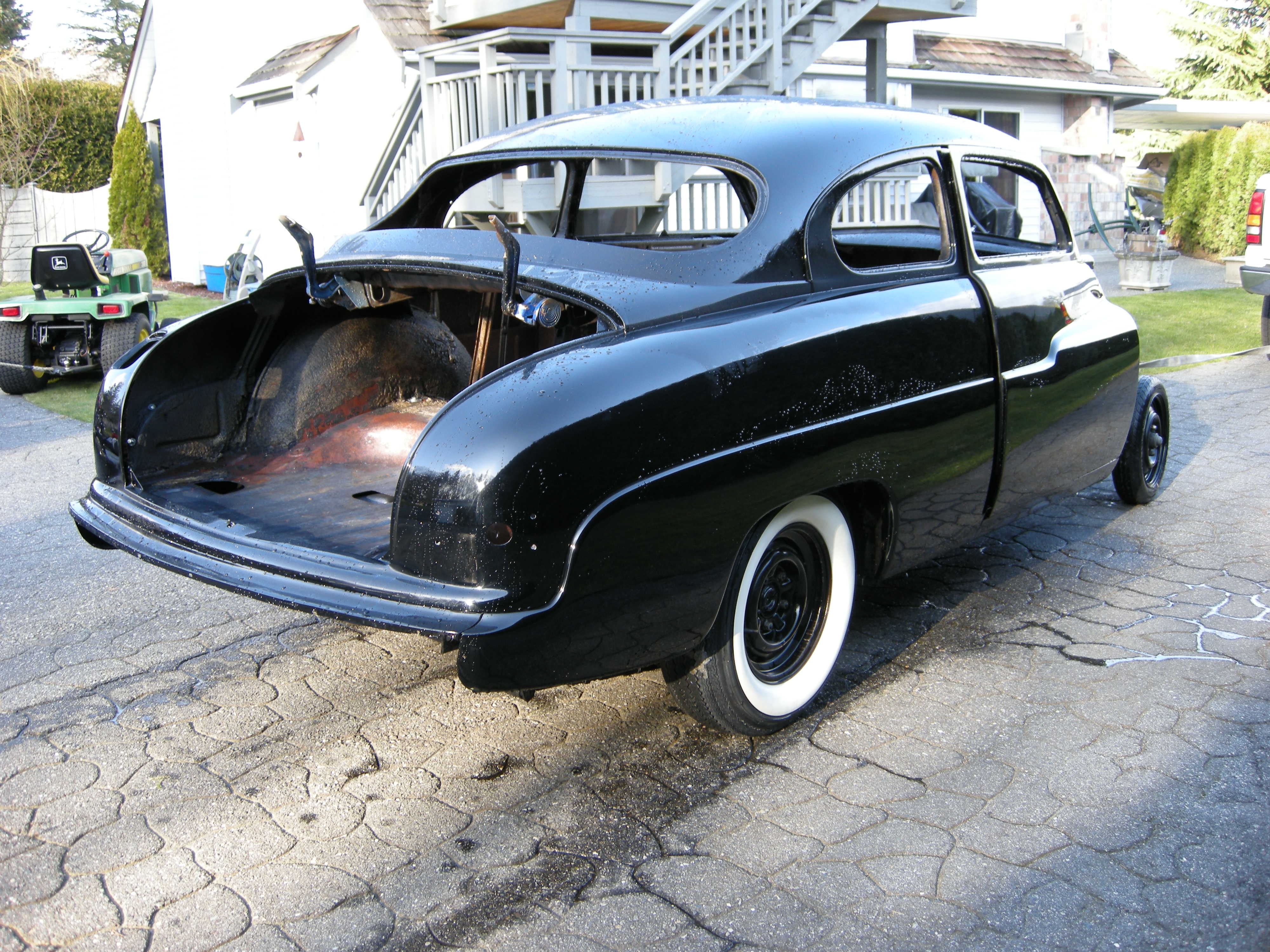

    looks great! this is the day i bought it and dragged it home.....alot has changed since!

    Those pictures are great! Haven't seen many from before Ross got it originally chopped. Thanks for posting them.
