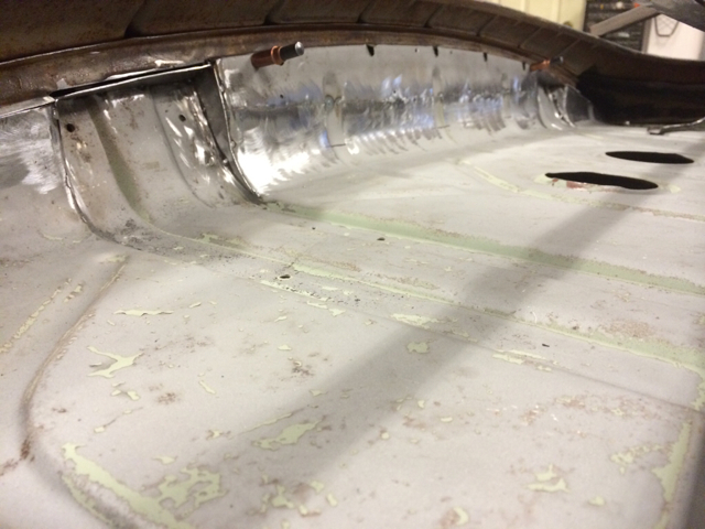

    Started the non exciting work of replacing the entire package tray in the merc. In the initial chop, the sliced through the middle of it from end to end and only re welded the center section. Also the hinge mounts weren't braced and were out by over an inch when we tried to mount the trunk hinges back into the car. It also wasn't shortened so it sloped towards the back. Needless to say this wasn't gonna cut it so we cut it out. I got a replacement tray from the merc owners collection of 4 door parts cars. I blasted it then started the modifications to make it work. I had to section it and cap where the hinge mounts were set back to line up properly. Ran outta argon so couldn't finish it. Next time.

    Got my bottle filled today and was able to wrap up the package tray modifications. Fits great and retained the factory look for the most part other than the recessed hinge pockets. Belt line area is next and then should be wrapping this chop up soon after.

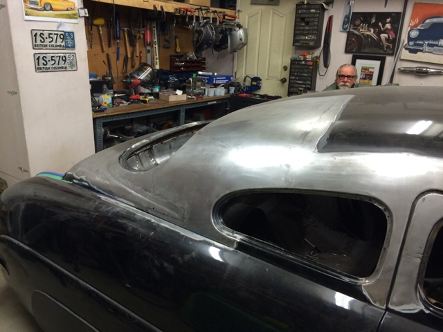

    Worked on getting the p***enger side belt line tacked in and everything hammered and ready to weld. Ross came over to check out the progress and we rolled the car outside for a look at the end of today. Super happy with the new belt line.

    Today was filled with lots of welding and a bunch of hammering. Got the belt line completely welded and ready to be dressed and finished. Close to 16 feet of TIG welding in the belt line.

    Started finishing the belt line tonight. Long way to go still but got a good start.

    Finished the belt line yesterday. Roof is almost finished. Need to adjust the radius'd door tops as I'm not happy with the flow into the quarter windows then onto garnish moldings.
