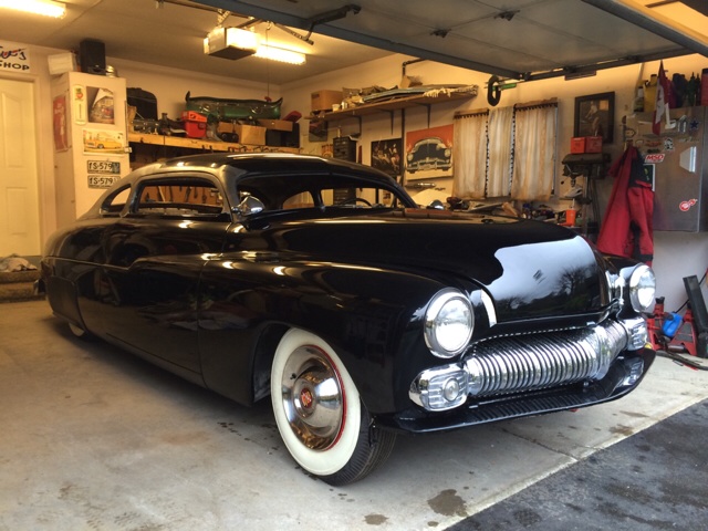

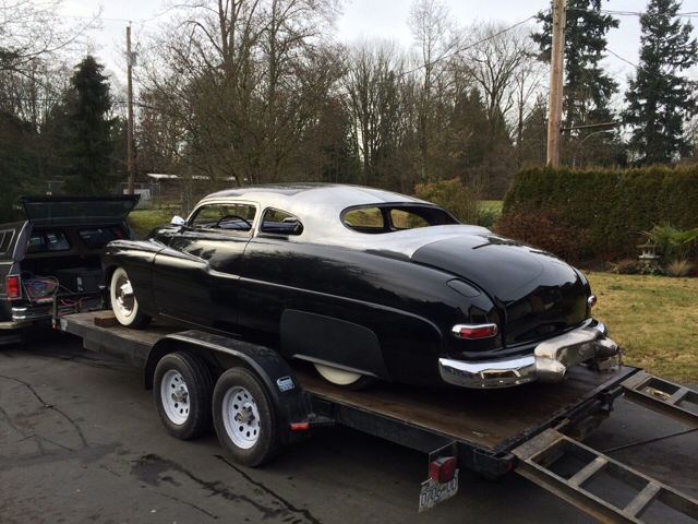

    Mercury left my house for body and paint Wednesday.

    Your Merc has the classic look. Great work!

    Fantastic.It's all there.I hope your friend leaves the car like it is.Paint and detailing,doesn't need more.Maybe some side trim,maybe not.Really,really nice !

    The merc will remain as it is now just painted and detailed. I like the factory grill and head lights on this car. Simple stylish custom.
