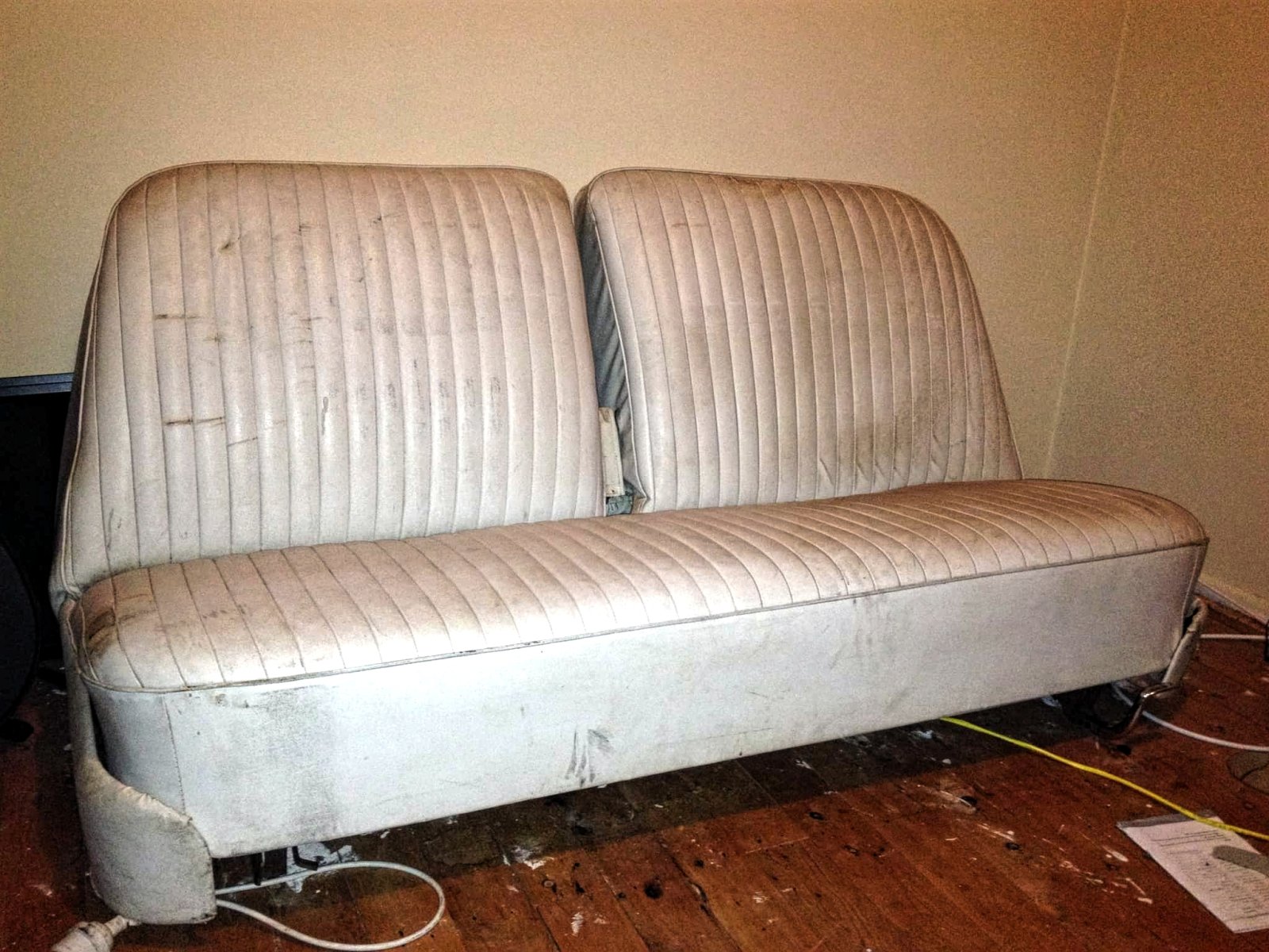

  2. 1672724738588.jpg Found a front set and will retrim to suit rear seat 1671023365104.jpg

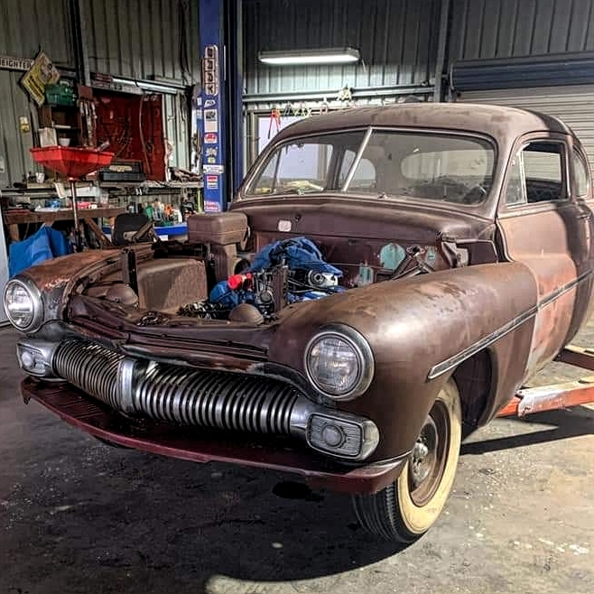

    316599358_911311323333686_5988046096602404823_n.jpg 318929418_667689091670699_6687669952618038728_n.jpg
    A good friend Cusso Allan is going to help out with fitting an engine and suspension work
    So taking the car to his workshop with the use of his awesome 1960s f350 ramp truck

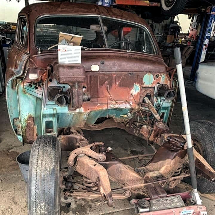

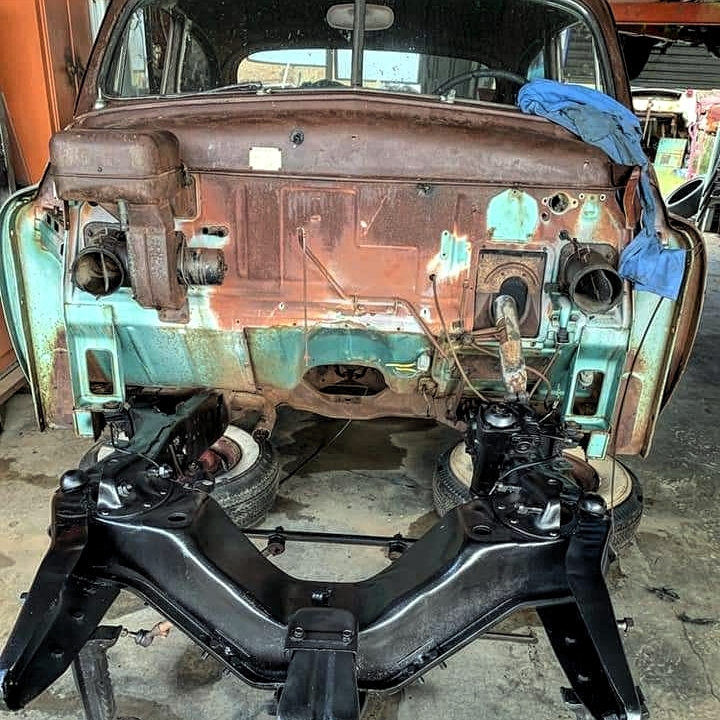

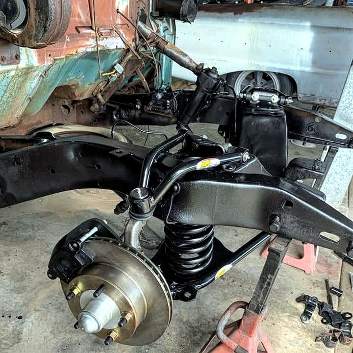

    Given the front end a good clean and paint .
    Getting ready to fit jamco front suspension kit.
  8. Did you use one of those rust converter chemicals?
    Aussiepete. likes this.
  9. Wire wheel the surface first.
    Yes a rust converter was used Lucius.
    54delray and 51 mercules like this.
    Jamco suspension fitted.
    Went in pretty easy and happy to have disc brakes on the front of the car.

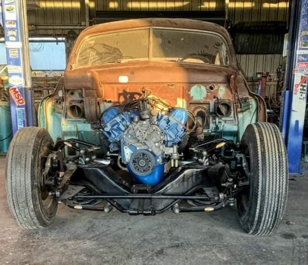

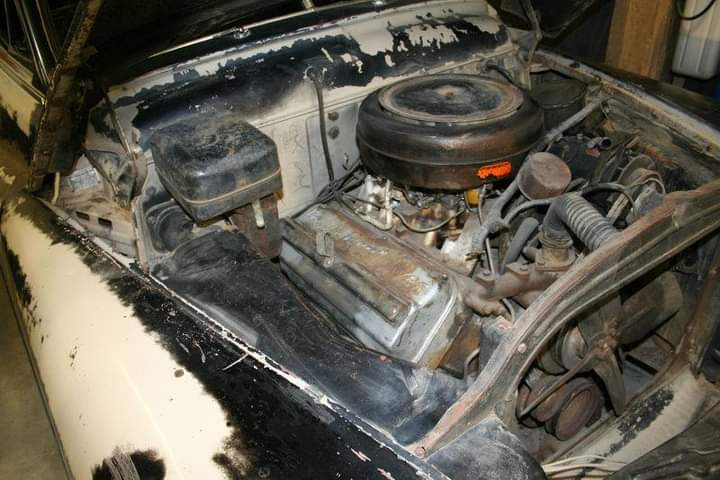

    It's time to fit the engine and just wanting to give a heads up to anyone fitting a 351 cleveland/windsor. Please ask for the long frame pearches not the short ones Jamco supplied. Three guys in Australia all had the same problem.
    Not sure why this happens but jamco are quick to respond to the situation.

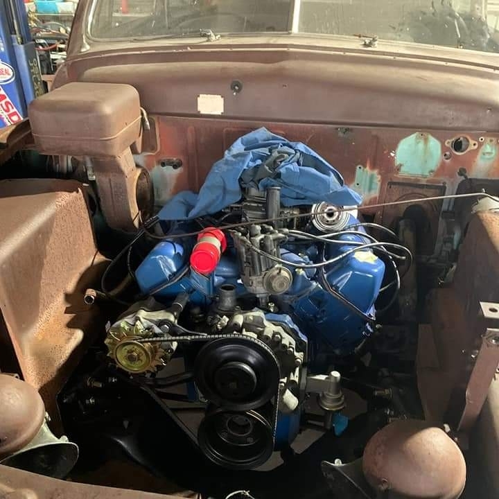

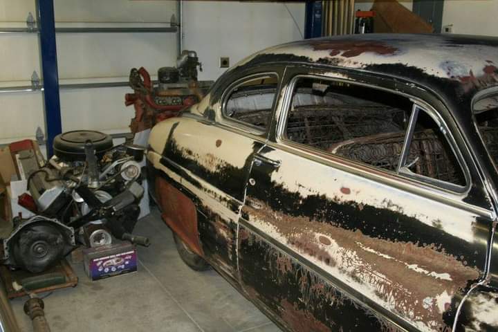

    Fits pretty good.
    A f100 4x4 rear sump was used and the engine was pushed back as far as it can go . Cusso Allan will modify the trans tunnel for better clearance as I'm using a c6 transmission.
    Pretty much using 1978 f100 running gear.
    351 + c6 + 9 Inch.
    Thanks for advice everyone
    Trans cover has been modified to cover the large c6 transmission. Firewall was trimmed a small amount aswell.
    It's hard to see but the part at the top has been extended forward .
