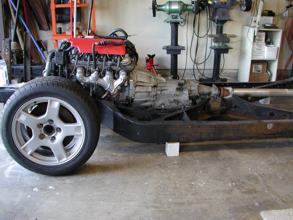

    Been there, done that. I grafted the front clip from a 92 ZR1 onto a Merc frame and installed an LS1/4L60E trans. Also modded the rear of the frame to accomodate the C4 IRS and bags. The concept was good and the actual clip graft came out fantastic...the problems arose with engine to body clearances. The Vette setup pushes the engine way back...the harmonic balancer actually sits behind the R&P unit in the stock configuration so you know that the rear of the engine has to sit a lot farther back in the ch***is. Track width is also a gotcha. I forget the actual dimensions but the Vette IFS/IRS is wide enough to cause problems when trying to fit it under the Merc. Sure you can use some wheels with m***ive backspacing and get the tires fit fit under the wheel openings but is that really the look that you are going for? I thought that I could make it all work and then finally decided to ****can the whole ch***is and start over. Maybe you can get your setup to work to your satisfaction...I don't want to tell you not to do it, but maybe hearing my story may bring up some issues that you did not consider. Good luck!

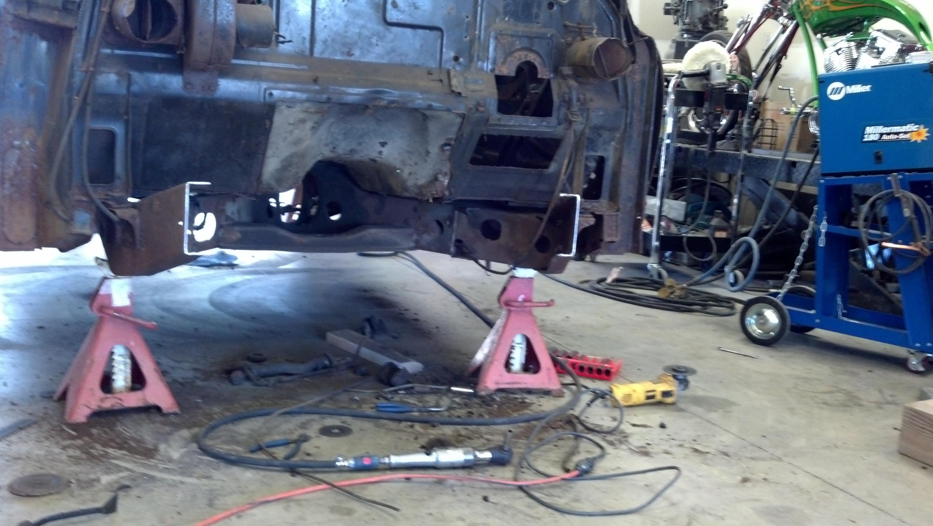

  7. SycoSteve
    Joined: Feb 12, 2011
    Posts: 296
    SycoSteve

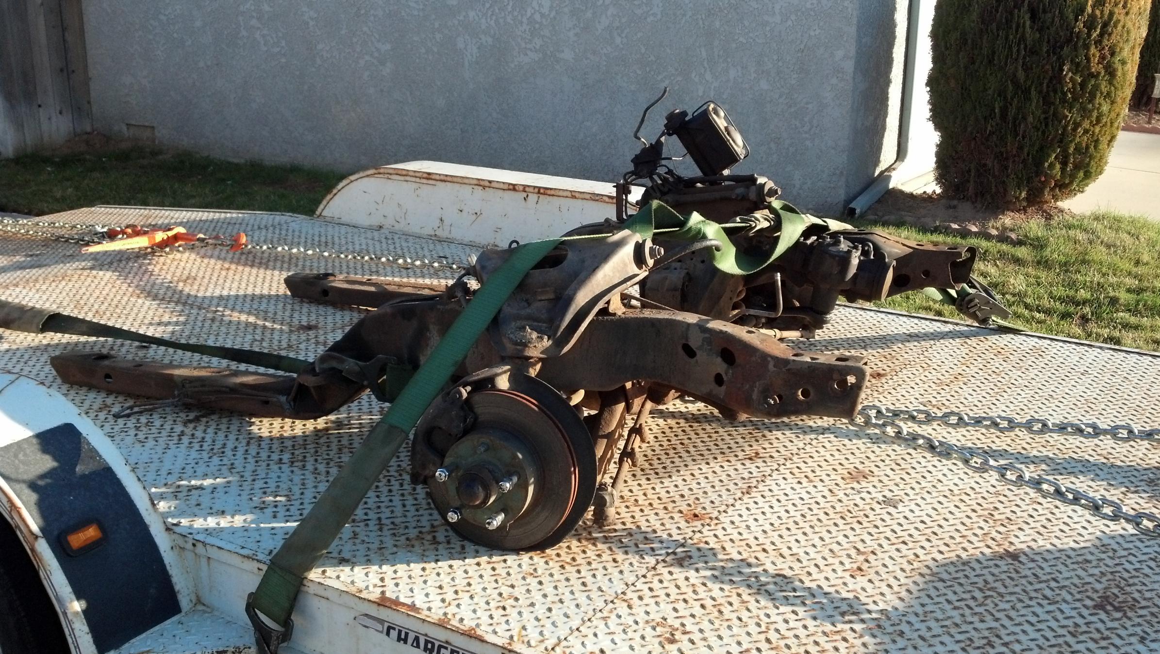

    The donor clip.

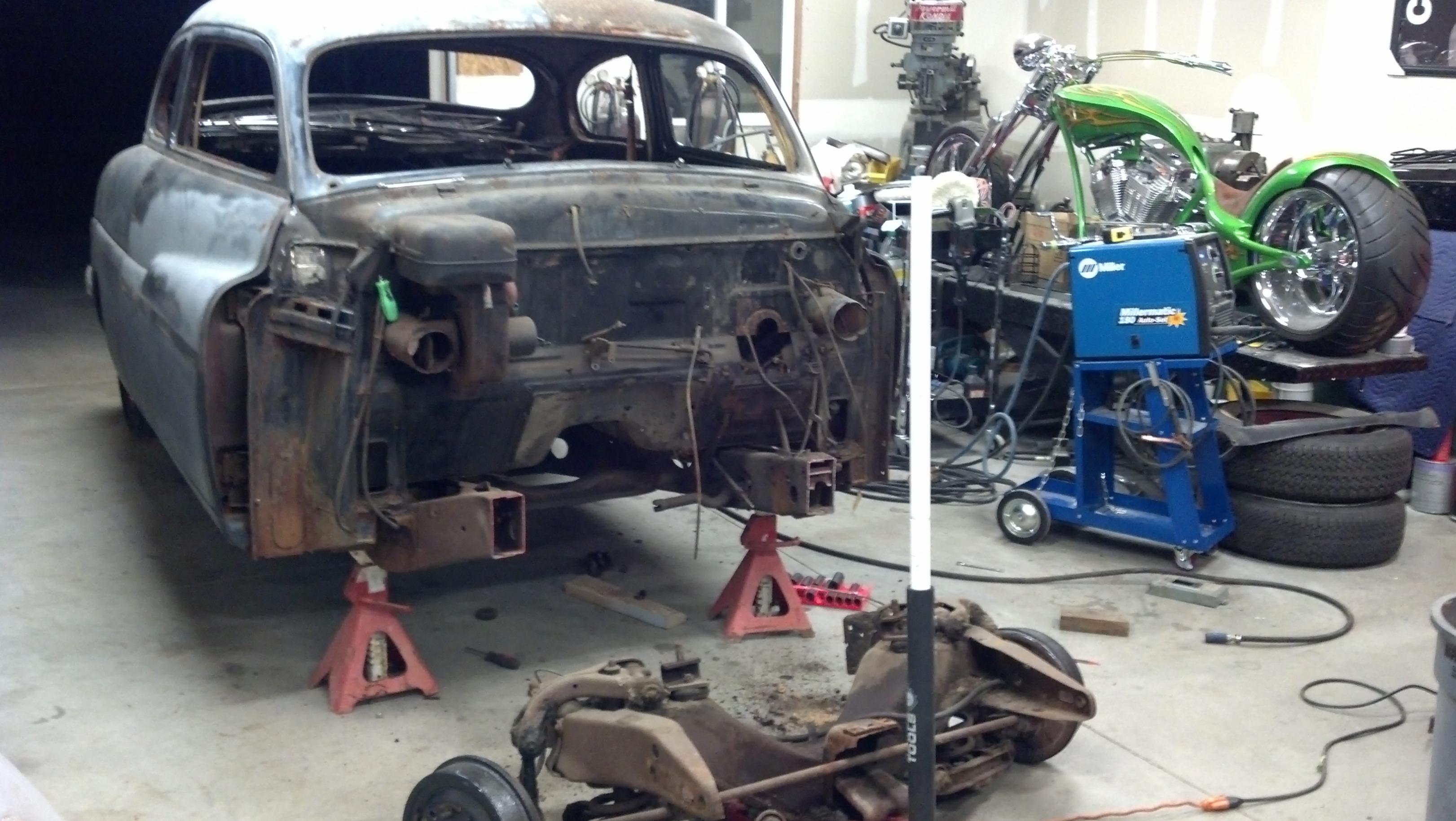

    I really messed it up now!

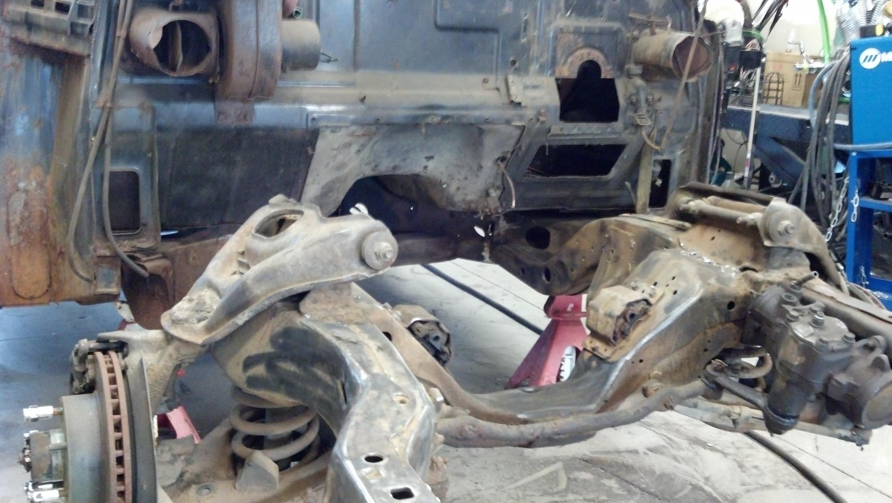

  10. SycoSteve

    Blackie I,m going for tho old school look on the out side with a newer drivetrain that will drive nice and if i want i can drive it anywhere without worries and have plenty of power nice brakes and handle well.

    All trimmed out ready for subframe.

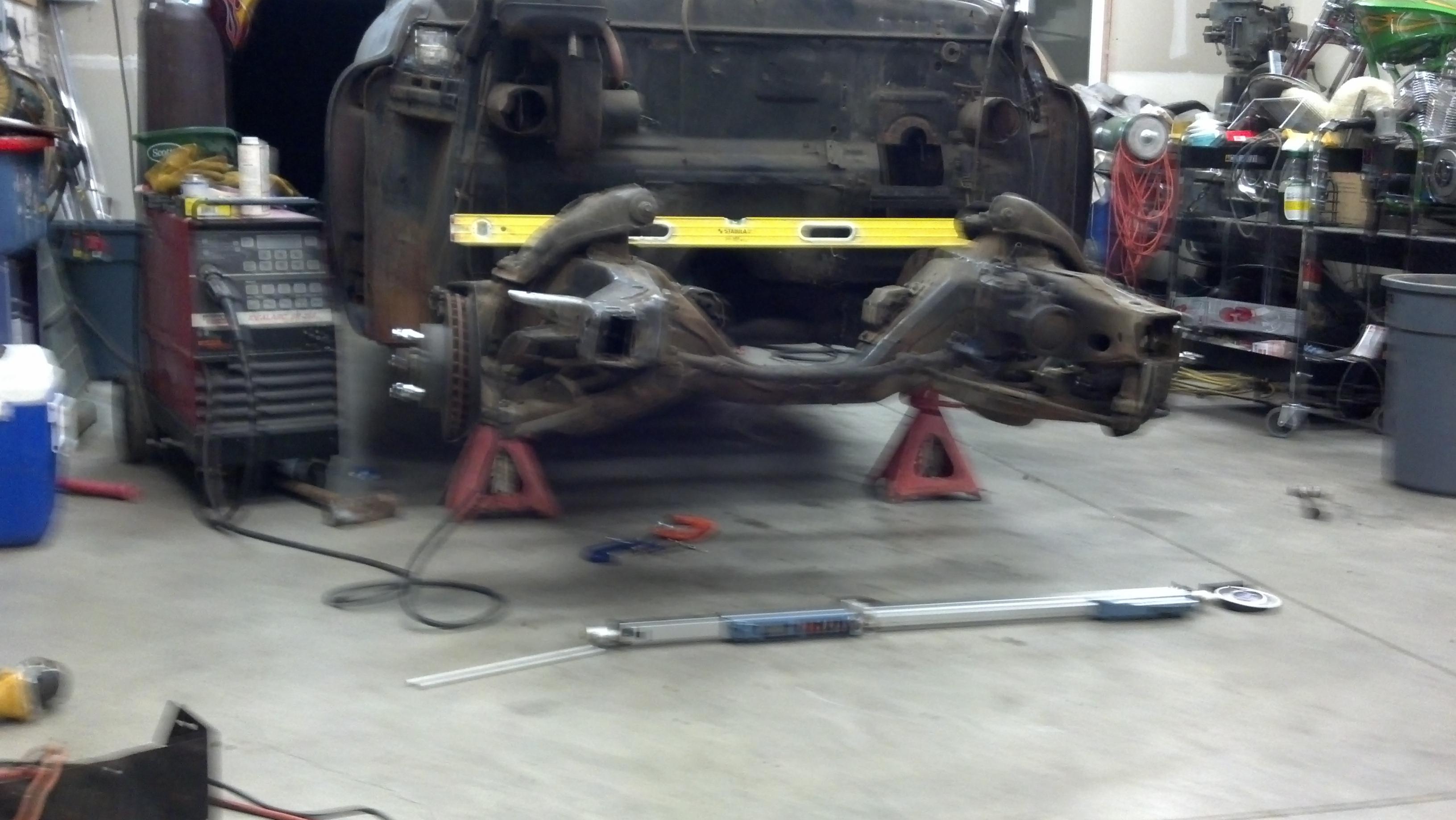

    Joined: Apr 21, 2009
    Posts: 943
    EXK
    from SO CAL
    Steve it looks like you may have the clip set a little low. I can not tell by your pics if you set the clips main rails 2" up from the bottom side of the X member like we talked about. If you did you have it leaned down in the front to much. I can see in your first pic where the merc frame is ****ed to the clip it looks about level on the top side. When i do them the clip sets about 1" up at that joint. Look at the 2 holes on the clip thats on the drivers that alline slightly in front of where the 2 frames join. Usally the upper hole on the clip ends up about 3/4" down from the top side of the merc frame at that joint. At this second i can not find a pic that shows this joint clealy but if you need it i will find one for you.
    Oh an LS motor will fit in a stock merc frame fairly easly even with a big 6 speed 4L85 auto trans attached and even more room with a camaro clip. The only mod you need to do is to slightly raise the top side of the transmission cover.

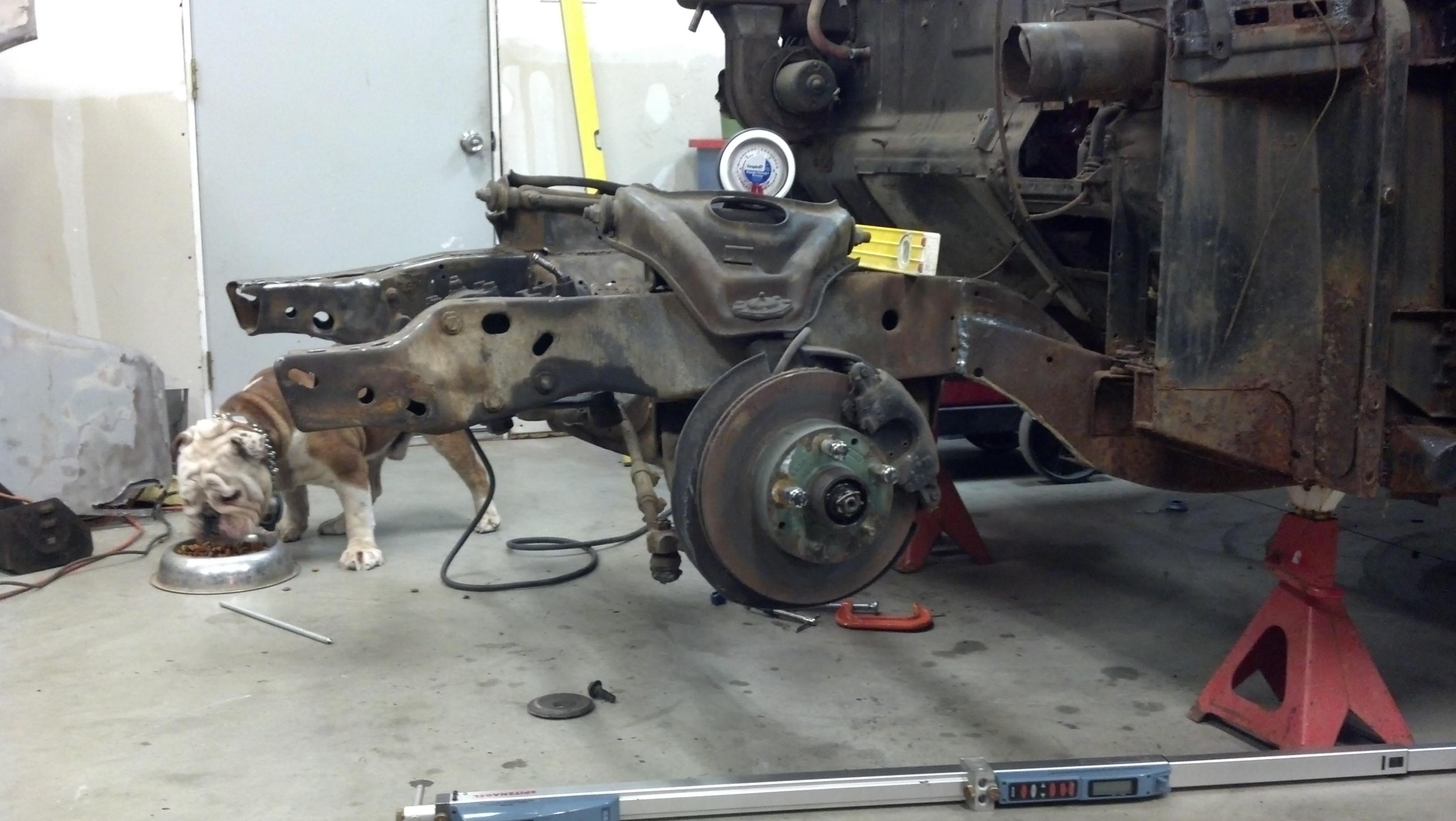

  19. SycoSteve
    Posts: 296
    SycoSteve
    I,ll call you in the morning to go over it. I was looking at the pics of the one you did on the 51 frame and the rear of the rails looked dlush with the bottom where it joins the xframe meets it. No problem to move it its tacked in a couple of places. Thanks for lookinf out. If you can post some more pics.

  22. EXK
    Posts: 943
    EXK
    from SO CAL
    I do not always set the clip at the same height. Customer's want differnt ride heights with bags, no bags, lay frame, and even a built in saftey scrub. Some customers want large dia tires and lay frame so i have to set the clip even higher. Buy adj the clip height you end up with very good suspension geometry as it fully cycles. Here are some better pic to look at.

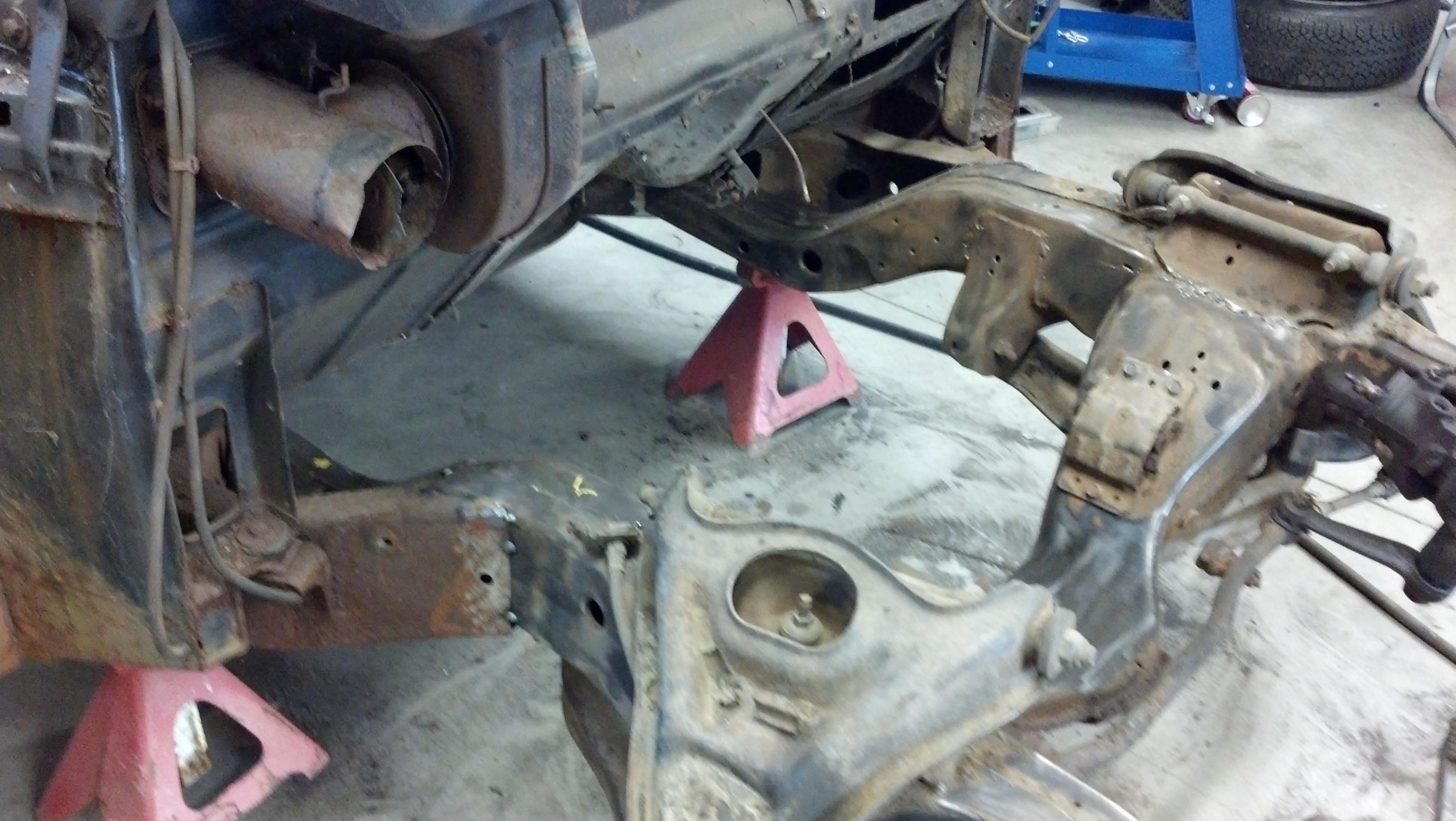

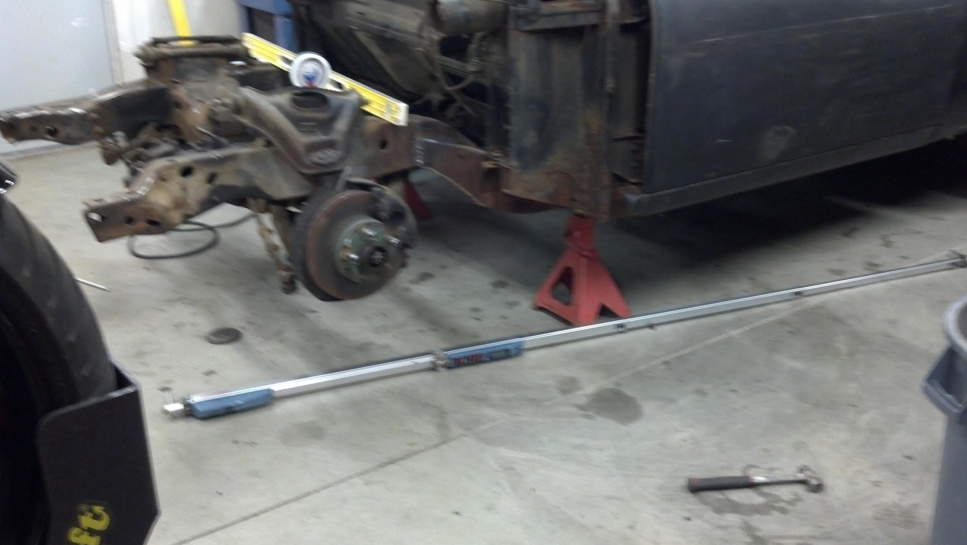

  23. SycoSteve
    Posts: 296
    SycoSteve
    update.. welded up time to build gussets. thanks for your help EXK!
  24. SycoSteve
    Posts: 296
    SycoSteve
    dont know why pics are so blurry, here is one more.
