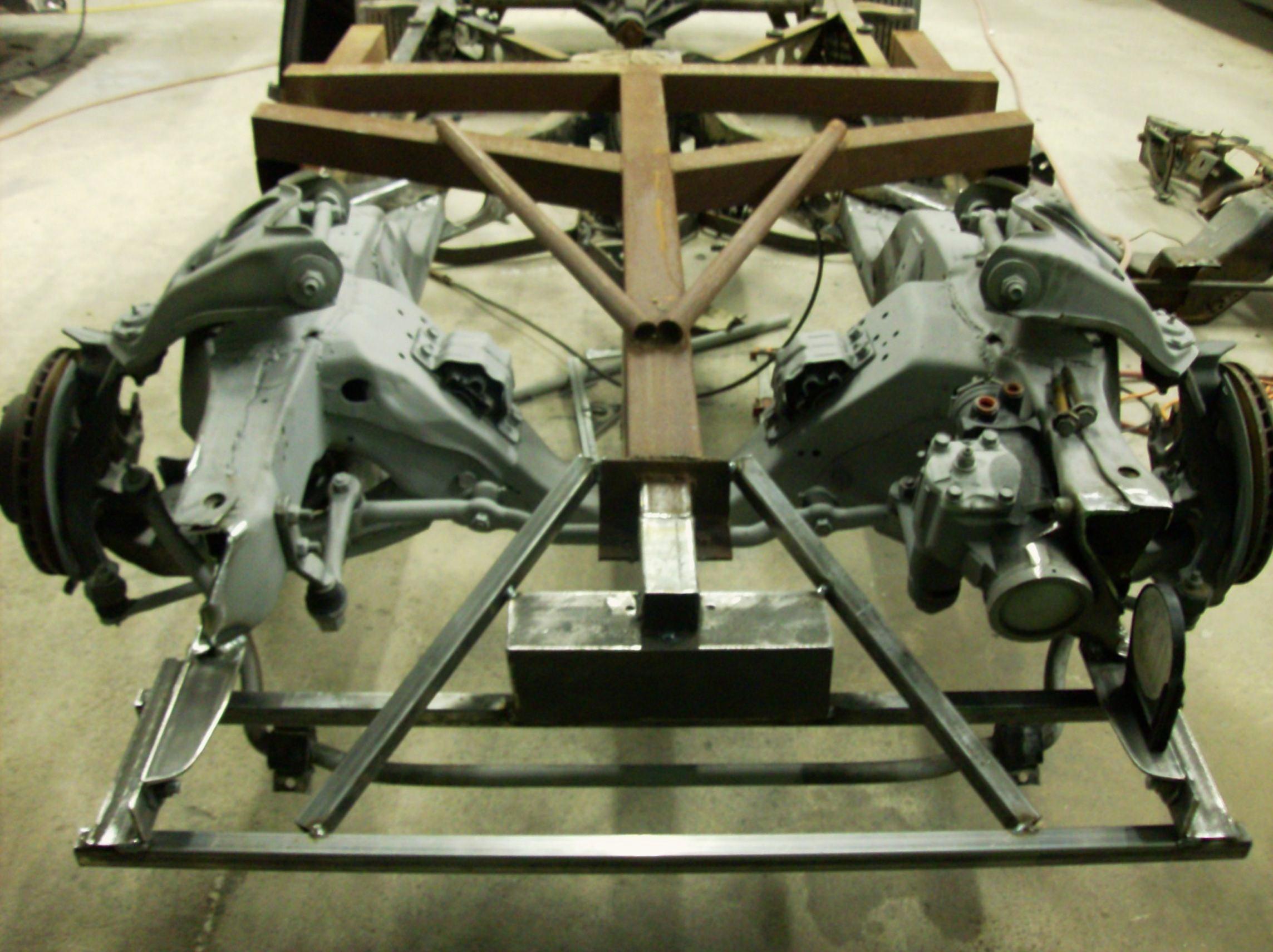

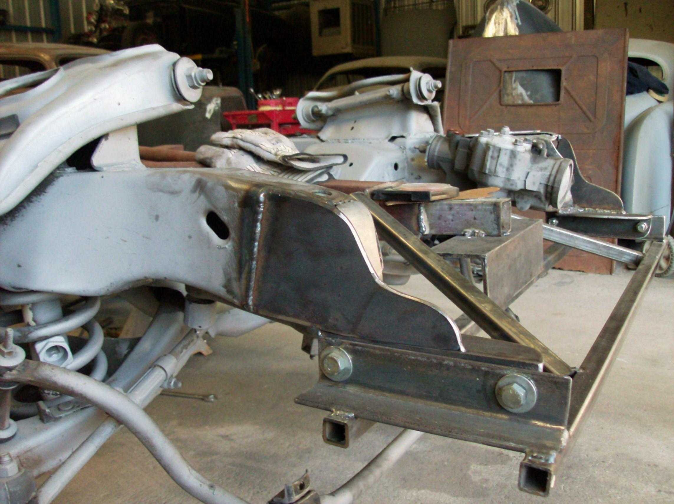

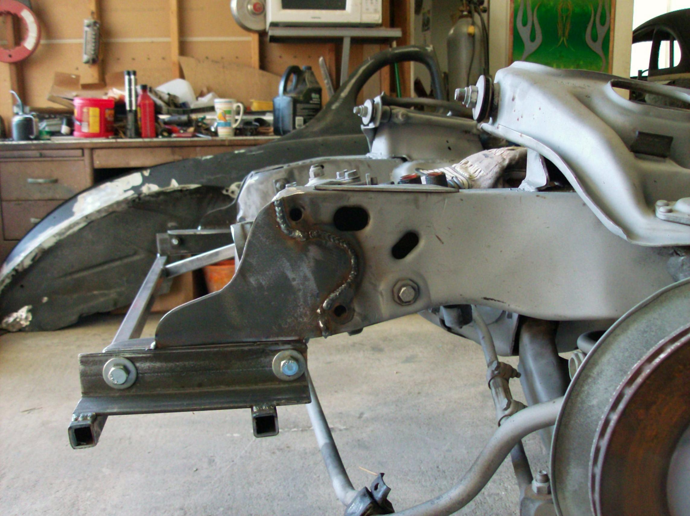

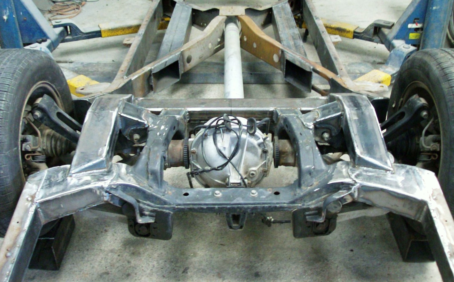

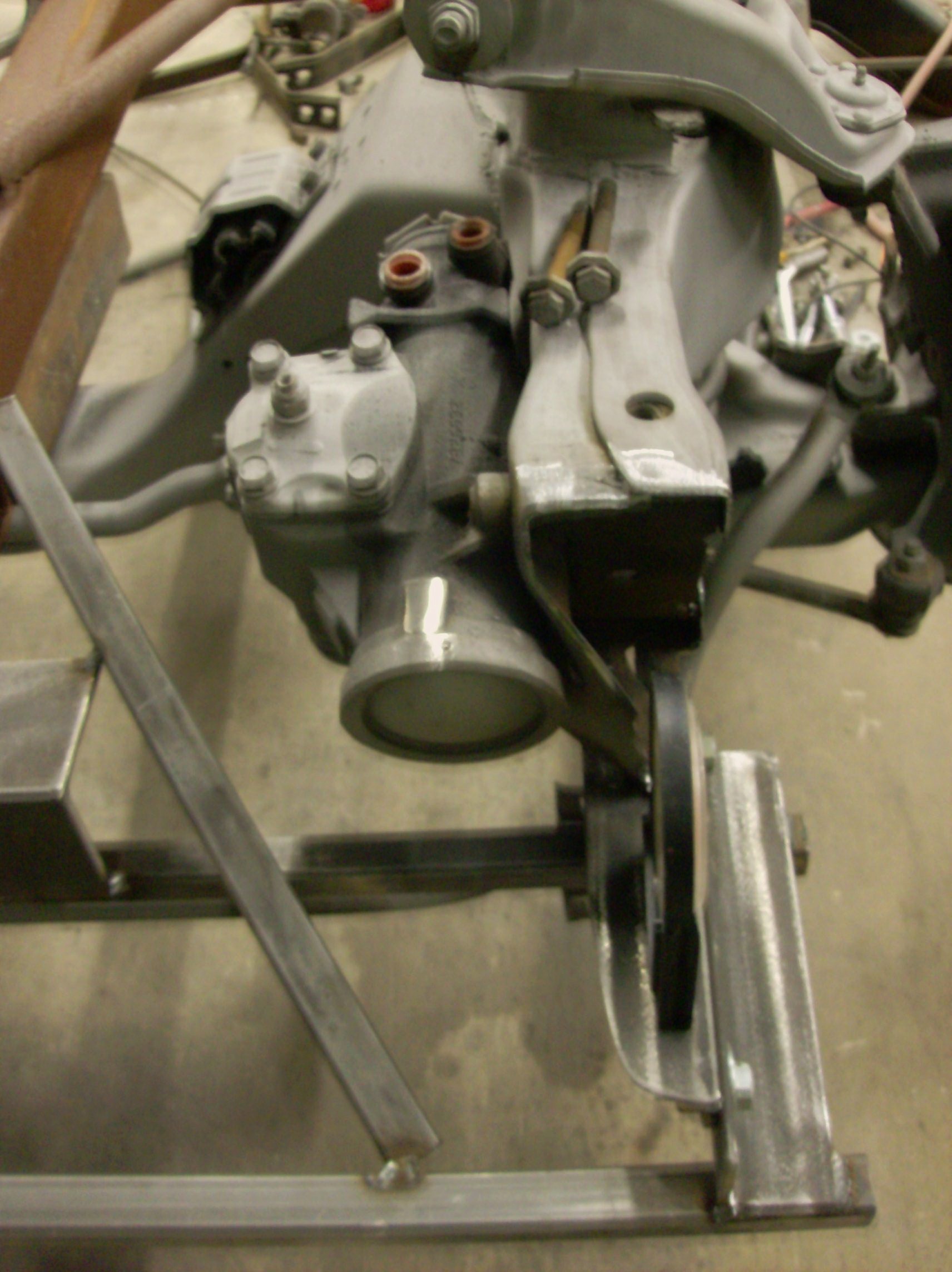

    Well Steve since you beat me to the clip in Santa Anna last weekend. Tuesday i had to send Greasy to 29 Palms to get mine. This is a 79 Trans Am clip and i am using the stock TA big block springs as this one will have a heavy Ford 460 C6. When this car is all back together. The frame should set a little higher than we want at around 7" ground clearnce. So i am planing to add 2" dropped spindles but i want get it all back together first. Here are some new pic's. I know most of these pics are to late for you but others might want to see.

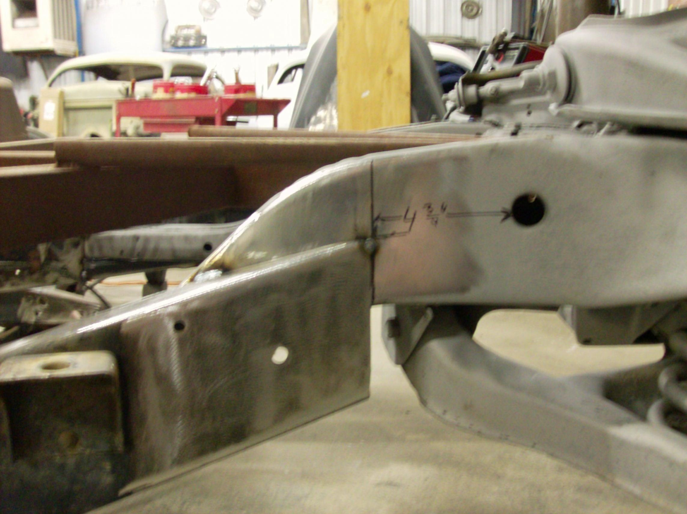

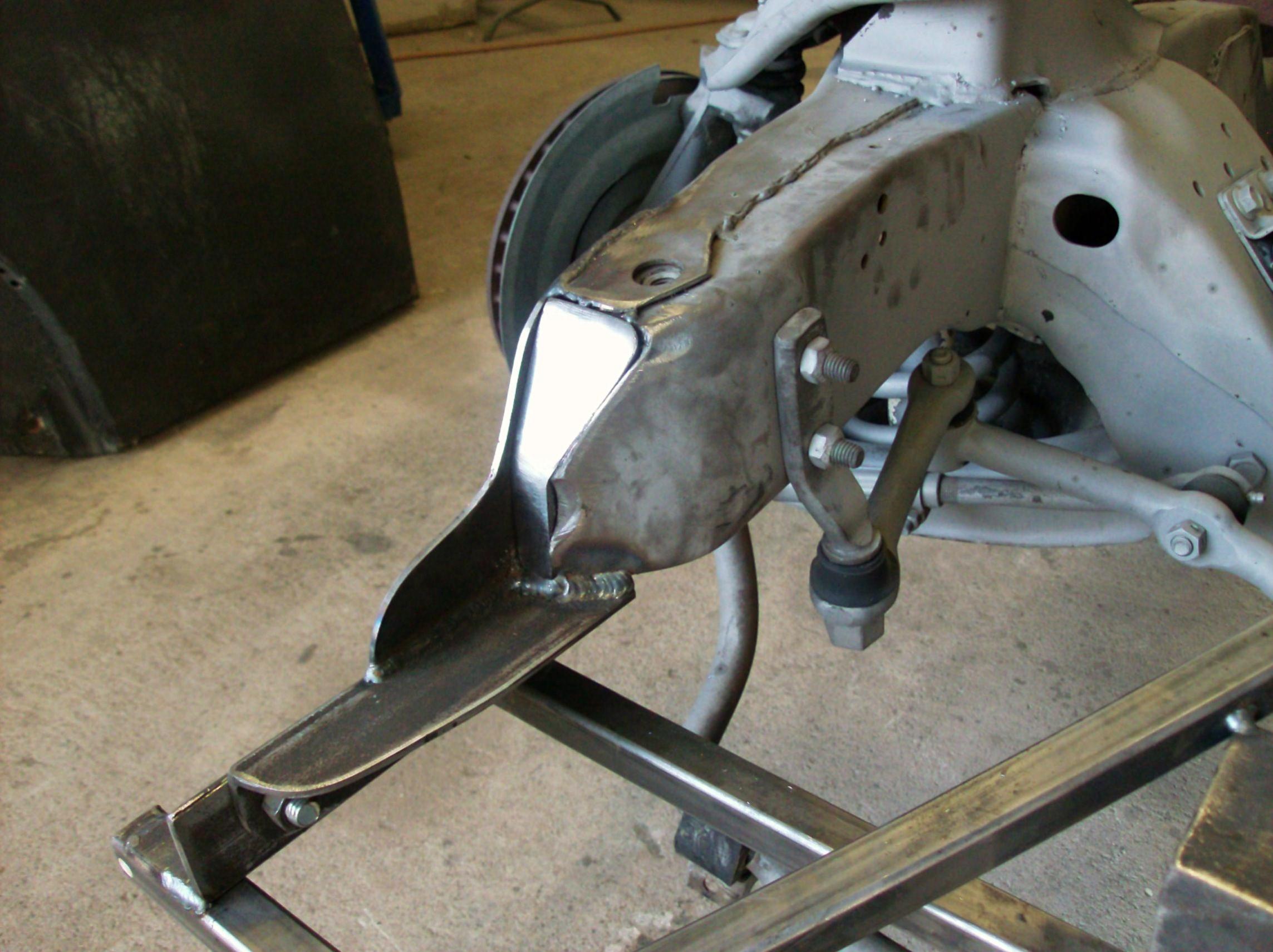

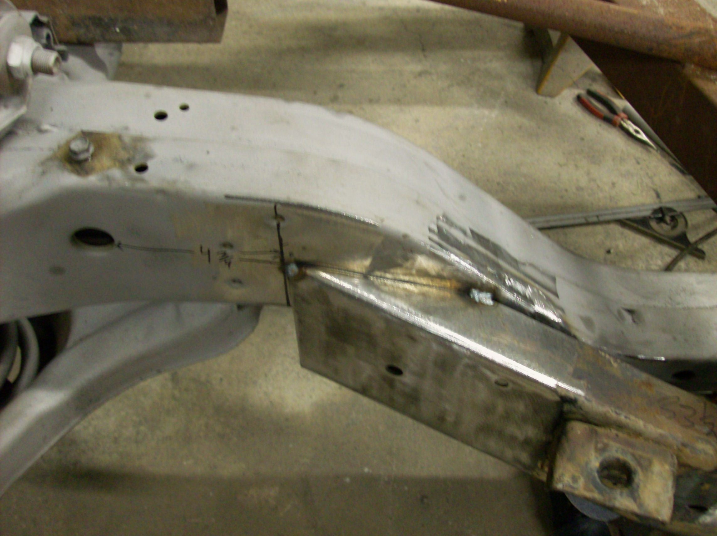

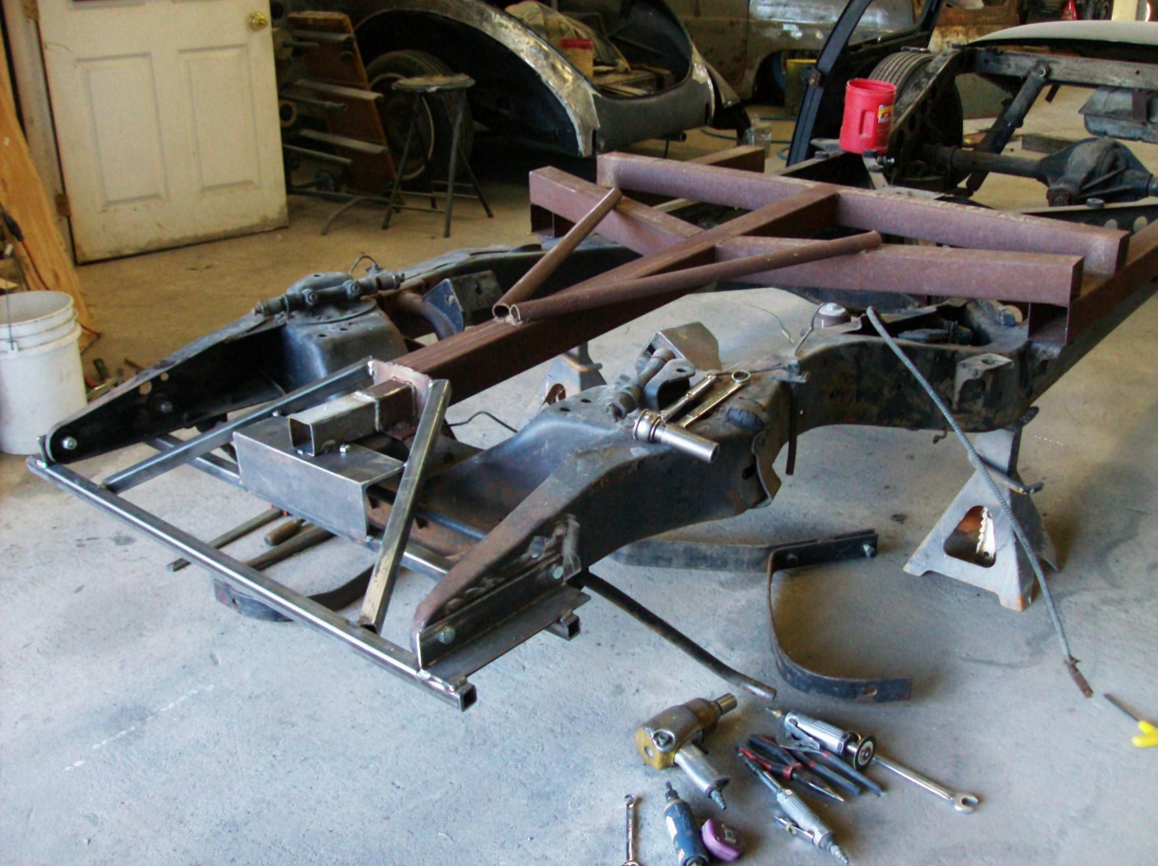

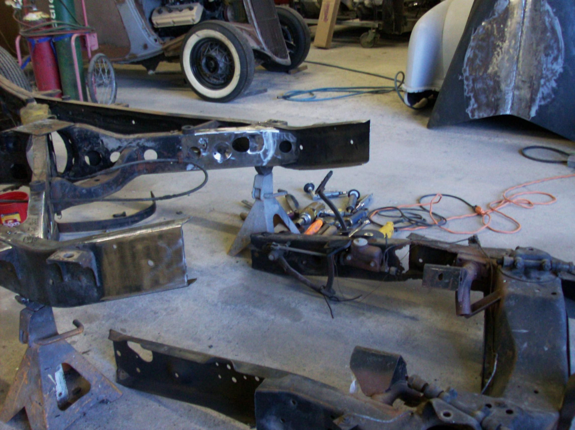

    Heres a few more pic's of how i finish off the front rails and reinforce the bumper mounting brackets.

    EXK - I really like the jig you made for the front bumper mount! Thats some good planning ahead. If you were going to run airride planning to have the frame about 1" off the ground layed out. How high would you set the subframe, at the rear where it meets the original ch***is. What is your optimum choice for a rear end? Thank you, Korey

    Thanks, If bags are being used i install the clips rails in the middle of the X member just like you see here in this post. Since you want a 1" saftey scrub you probally can use the stock spindles and make a bump stop when done. For optimun choice in the rear this is whats under my personal mercs but overkill for most. I like a simple 2 link better than any 4 bar setup. There are a few kits avail and i even make one. If interested let me know and i can post some pics and more info about them.

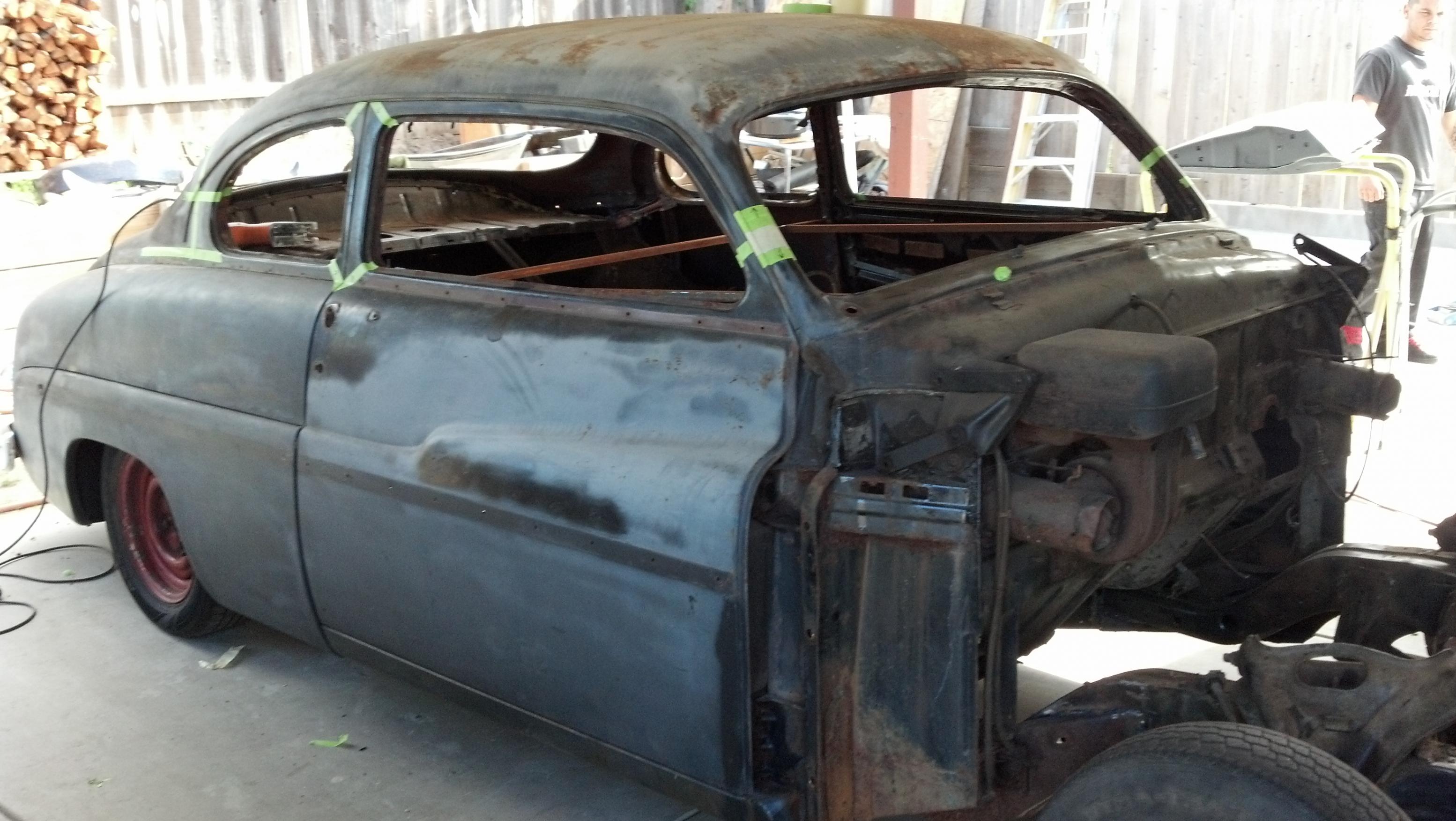

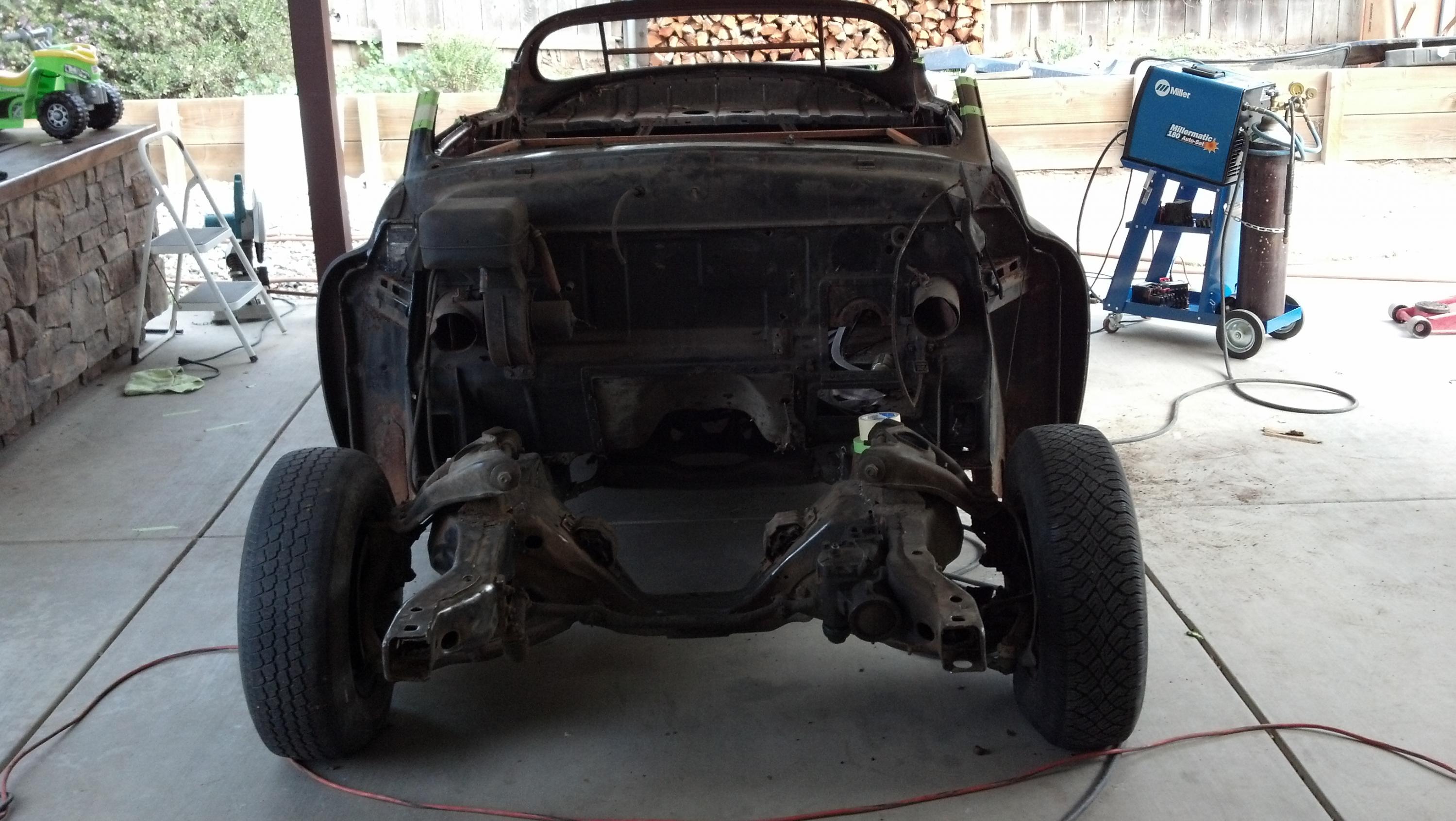

    I began the chopping today!

    Looks good, is that the height of the chop? Looks like 5-6 inches?

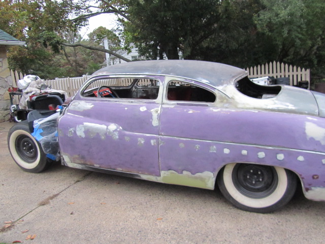

  12. SycoSteve
    Joined: Feb 12, 2011
    Posts: 296
    SycoSteve
    Thanks, lots of more work to do. Its 4 1/2 front and 5 in the rear.

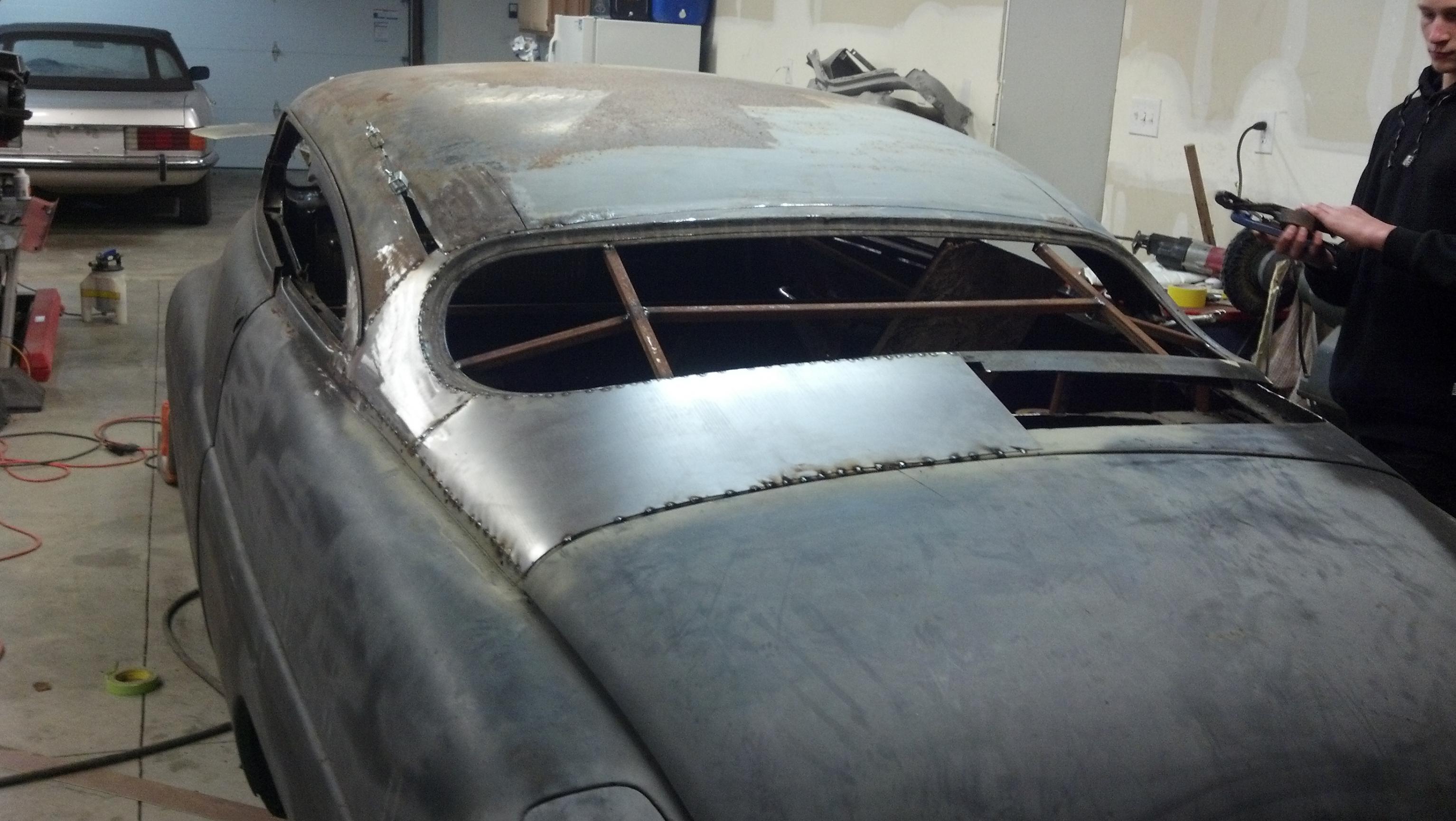

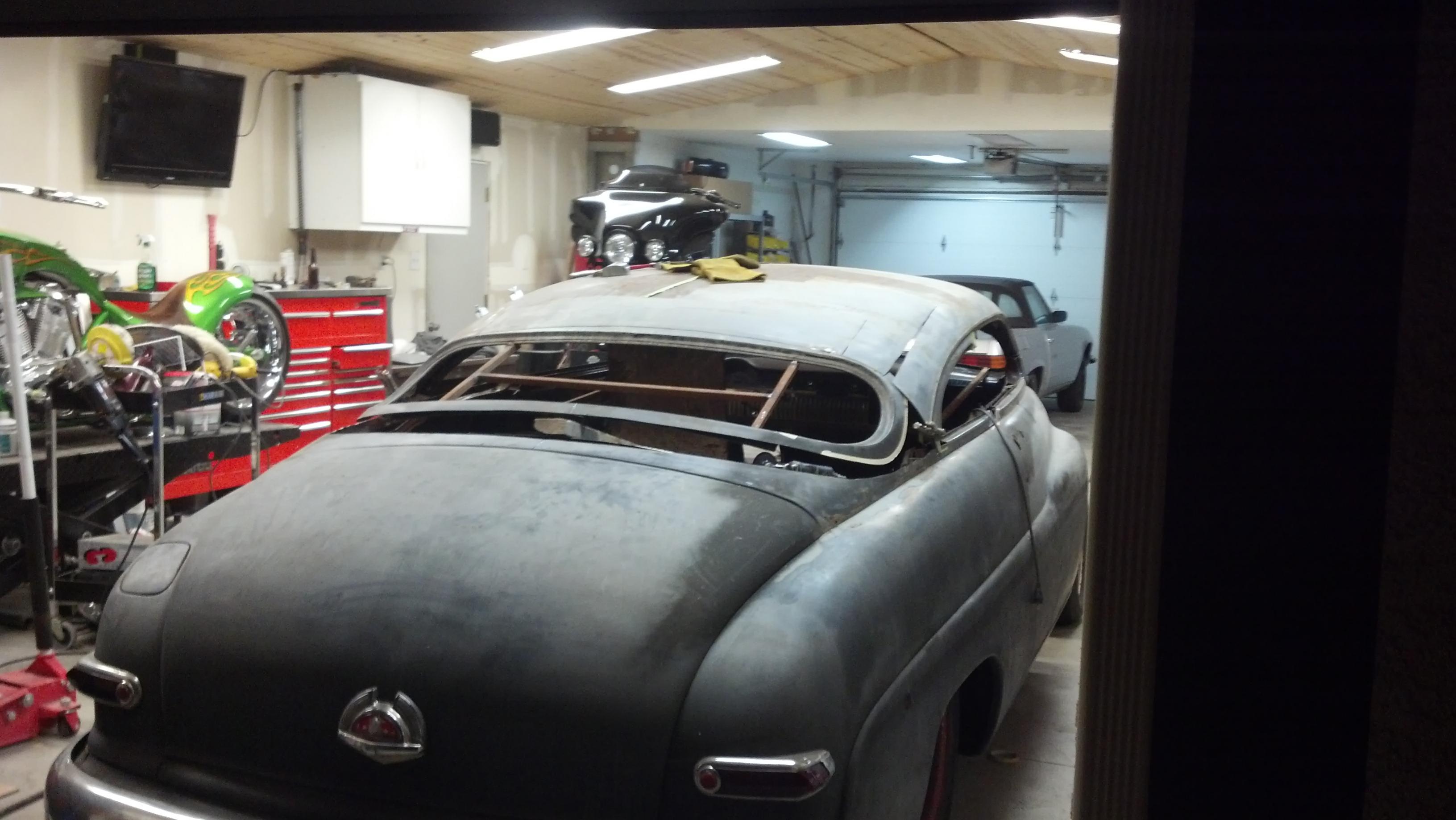

    getting the rear window where i want it.

    Slanted b-pilars or straight? How much did you take out of it?
  20. SycoSteve
    Posts: 296
    SycoSteve
    Slanted pillars. Took 4 1/2 out in front and 5 in the rear.

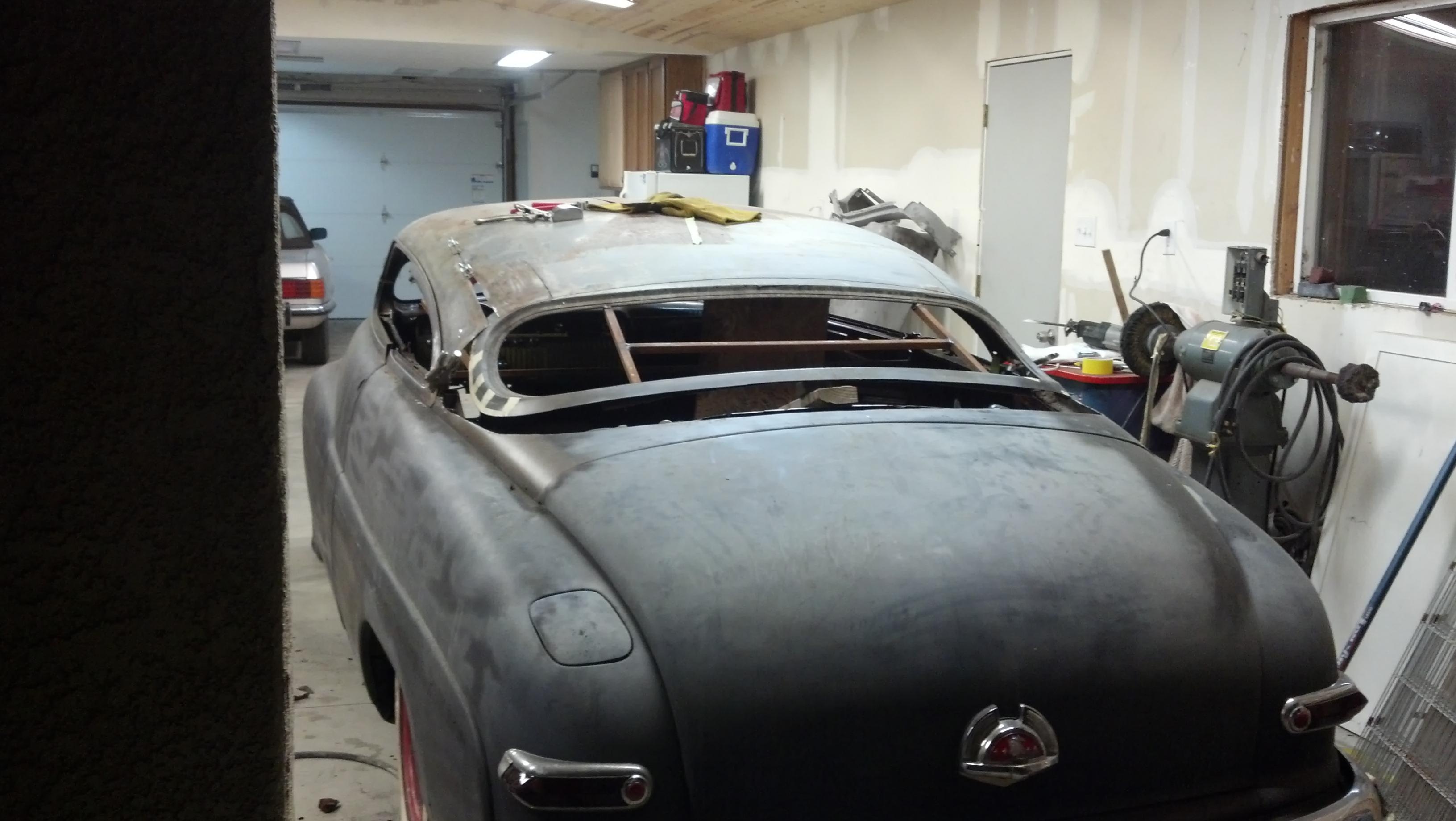

  21. SycoSteve
    Posts: 296
    SycoSteve
    more progress.
  22. Looking good.....nice profile.

  24. Are you leaving the back of the side windows like that?
    I did mine the same and really like the look.
  25. Bad Bob
    Joined: Jan 25, 2006
    Posts: 24,334
    Bad Bob
    from O.C. Baby
    Same as mine...slddnmatt takes out 4 1/2" from the front then adjusts the rear til it flows nice. That third pic with the side profile looks alot like mine.
  26. SycoSteve
    Posts: 296
    SycoSteve
    NO, I still need to fabricate the radius onn the back of the rear quarter windows.
  27. SycoSteve
    Posts: 296
    SycoSteve
    Thats what i did i like a nice even flow to the trunk lid. I moved the rear window up instead of just tilting it. i think it makes for better lines.
