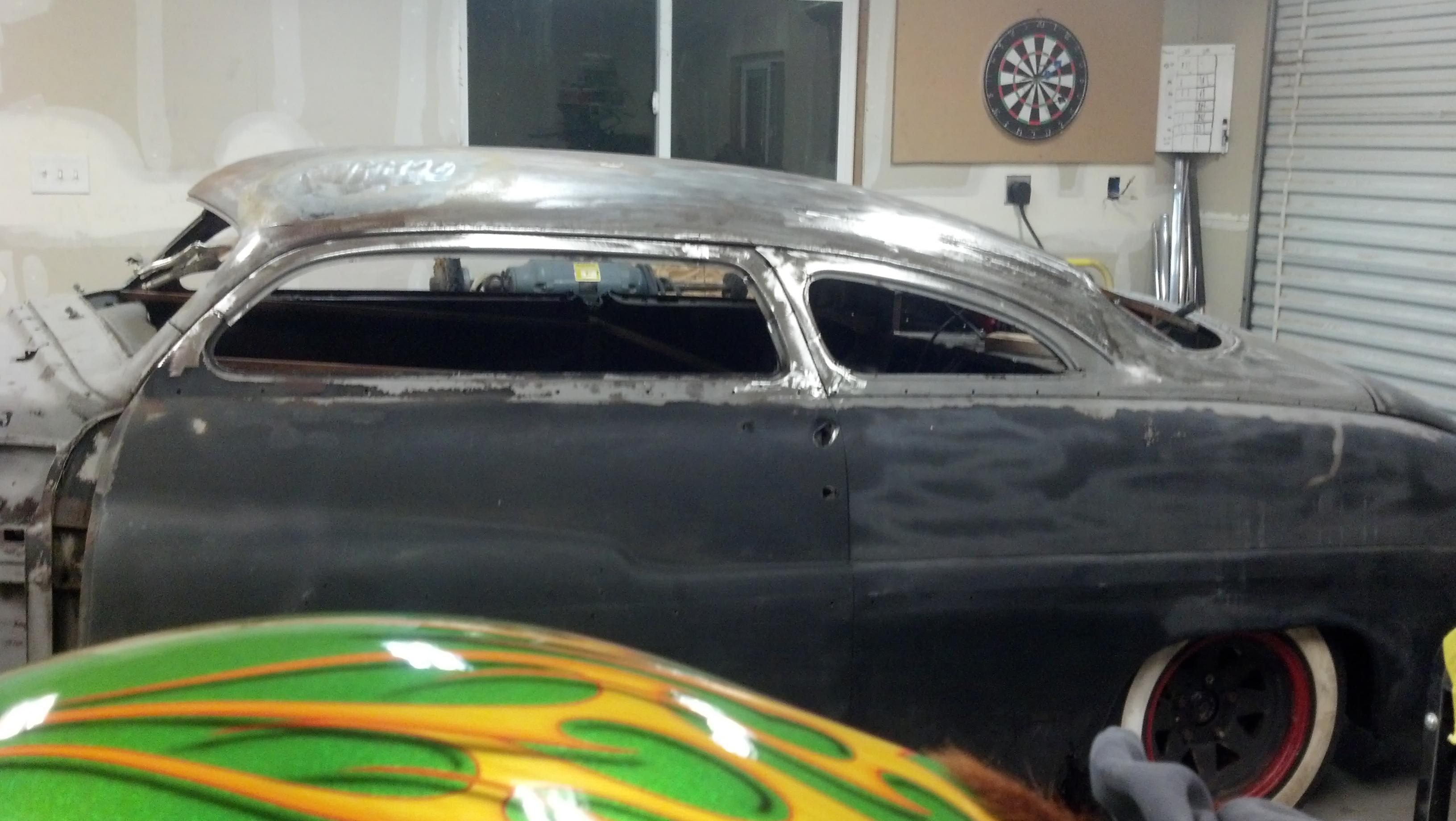

    a few more shots. I had to push it outside to make sure i like it.

    Thanks! Its fun to work on this. I,m a body man by trade so i get to work on wrecks all day. This is my first time chopping and i,m learning a lot.

    Back is almost complete window pillars next. I,m gunna get the roof media blasted due to the fact that it was a Monterey (vinyl top). lots of surface rust and pitting.

    Drivers side almost done.

    Thanks man, Ive been busy working on projects for other people but found some time yesterday to do the post and window frame. Now that I got one side figured out the other side should go pretty quick.:D

    hell the other side usually takes longer, because you have to match all the radiuss' from the other side! and you wouldn't believe how many are out there that do not match!!

    I hear you there, But i did make some templates for a guideline hopefully this helps. This is a learning experience for me being the first chop i have attempted.

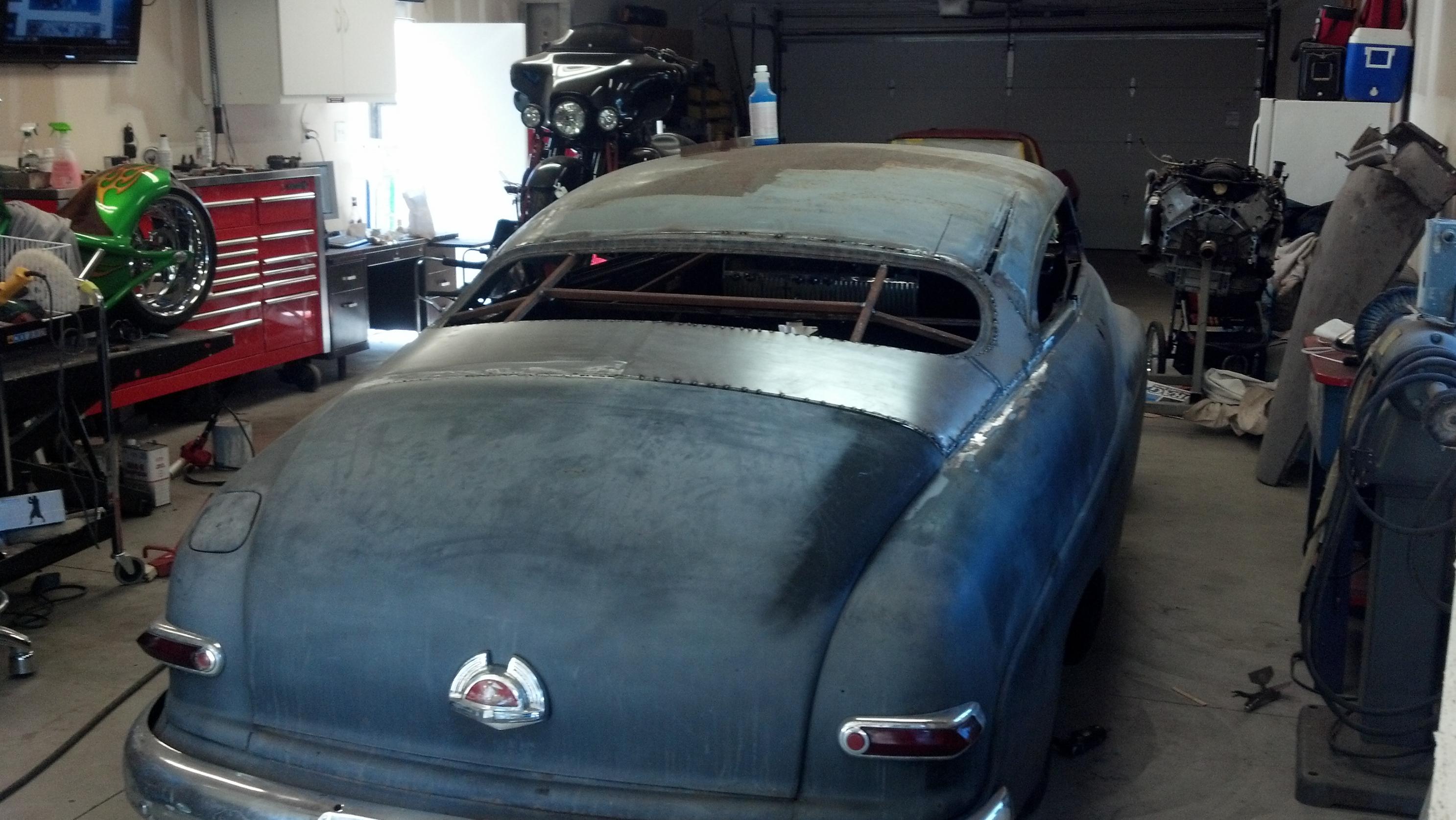

    Chop almost done, going to get the roof media blasted to clean out all the pits from the old vinyl top. Body work next.

    Im goin..... Slddnmatt was rite matching the other side was difficult.I ****oned it up today. All thats left is the quarter window rear radius And I can do the bodywork.
