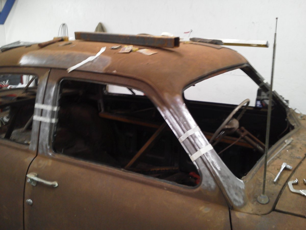

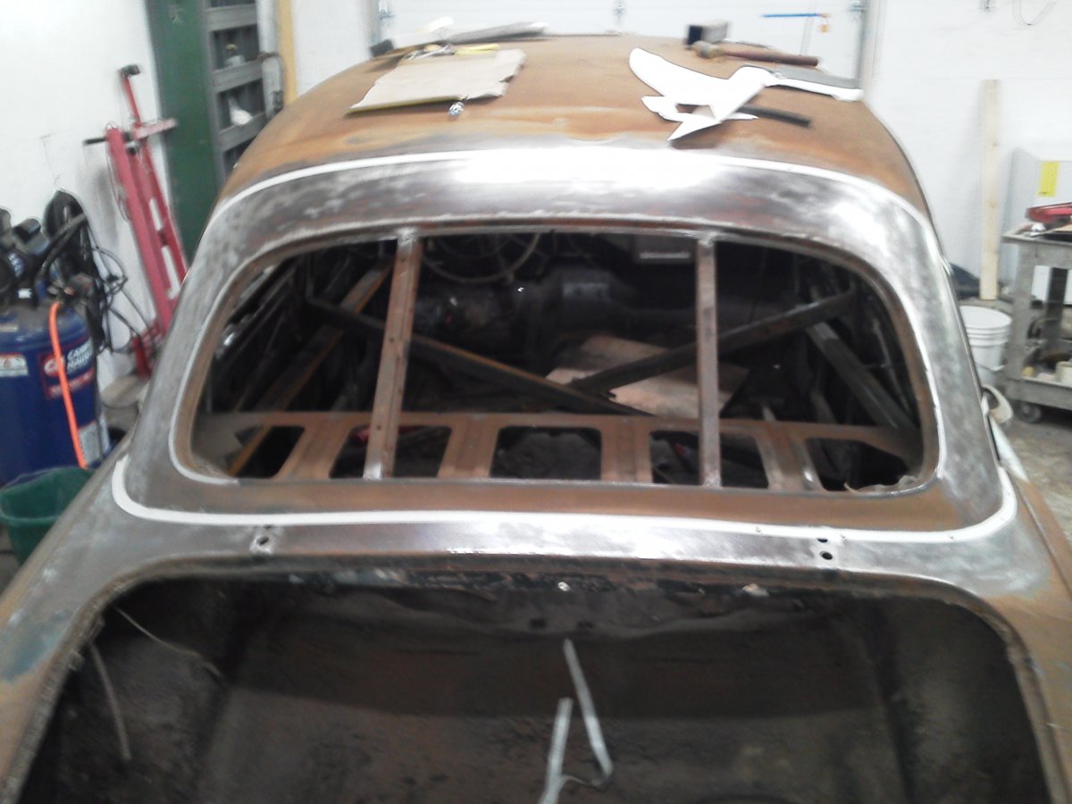

    IMG_20160710_174147.jpg This project started in July when I found this car in a shed and it has been their for 50 yrs. I bought the car mostly for the flathead but after I seen what a chopped shoebox looked like
    I thought I'd give it a shot. I am a State Corrections Officer and Prof. Taxidermist. My hotrod building experience none. Everything I've learned, I've learned from this sight and a couple others so I will thank you now for all your experiences and recommendation to other builders. I was given a f150 with a 302 (powerplant). I was also given an s-10 frame(front clip to gain power steering disc brakes etc. This is a budget build. I purchased a T5 ****** and at this point I'll be mocking up motor/******/power steering before separating body from frame. Any good info on the motor mounts ****** cross member.

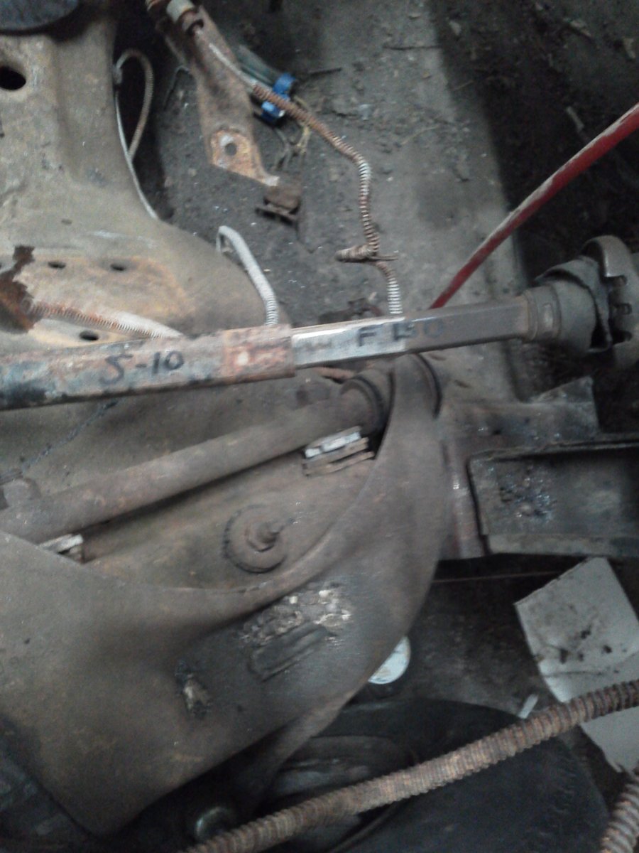

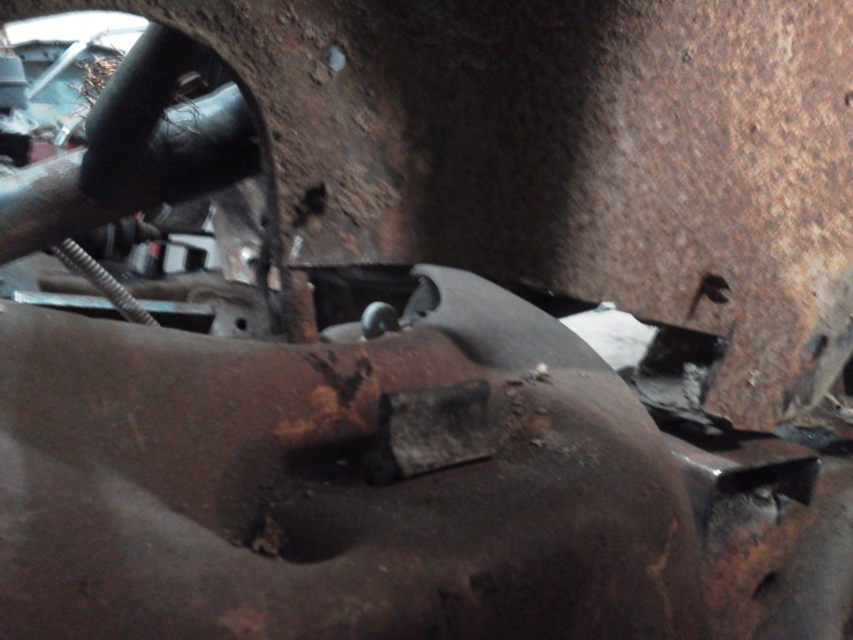

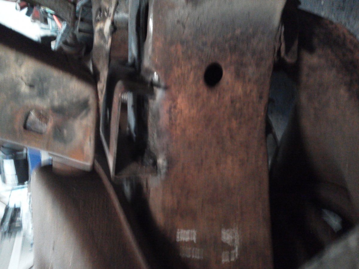

    Rocky and Toqik I'm glad you asked yesterday about front sheet metal. I fitted the inner fender today it needed a little trim at the bottom to clear the upper control arm. here are few pictures before and after.

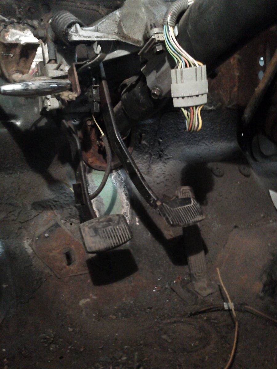

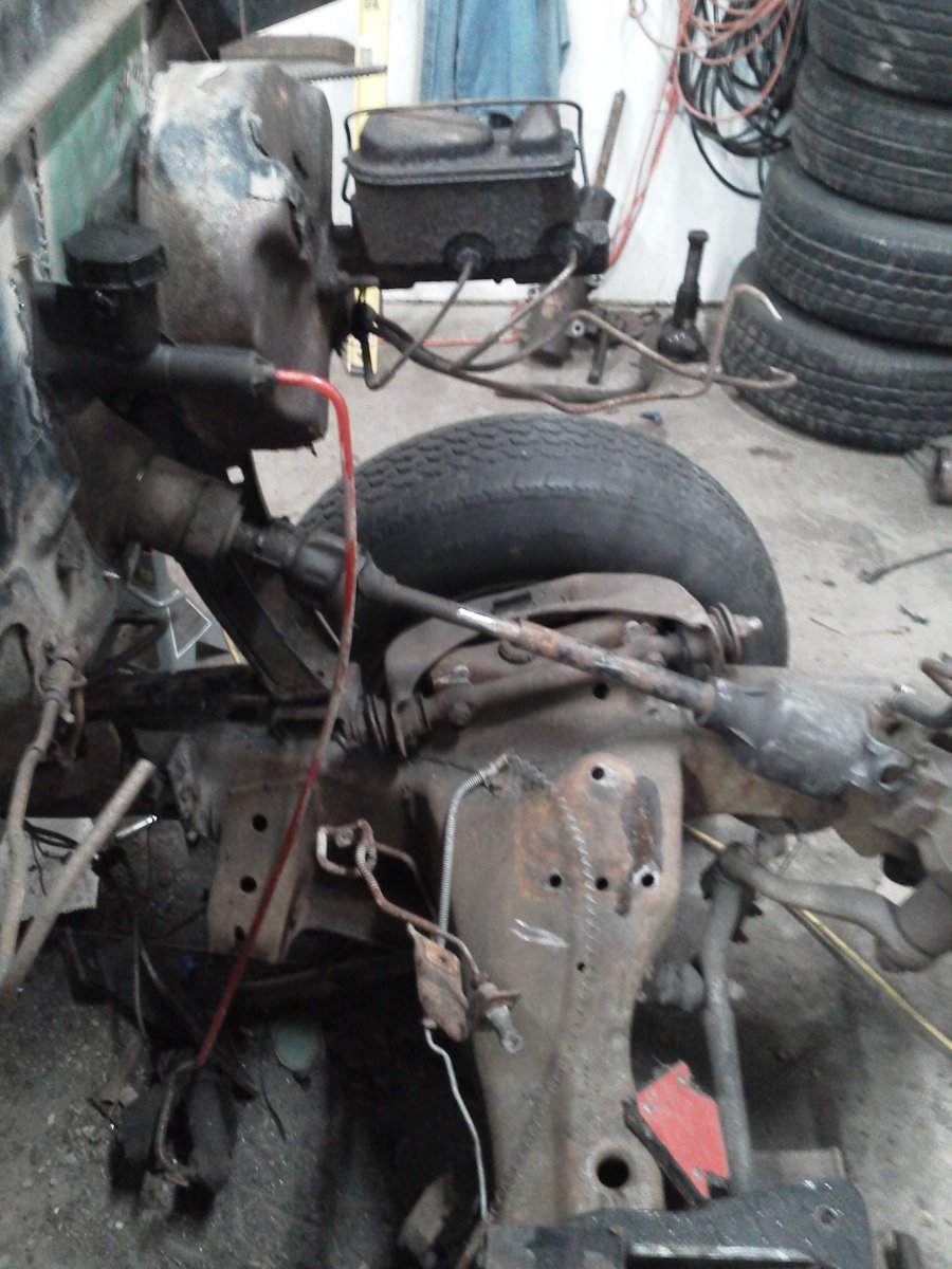

    Ive been working on the clutch/brake pedals. The f150 I got the motor out of also had a pedal ***embly.
    I adapted this to my shoebox firewall as I will have power brakes and a hyd. clutch. Believe it or not the f150 steering shaft and the s10 steer shaft fit right together. Look at pictures it went together fairly well but I wish I new whether or not their is a smaller brake booster with the same bolt pattern as the f150. This one will work but I'll have to trim the inner fender a little.
