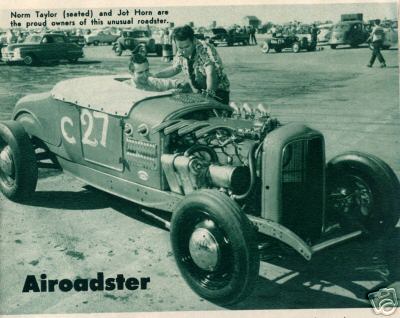

    Now THAT idea really has some merit! I was just discussing late fifties Ranger engined sprint cars with a local vintage sprint car racer the other day, there was an article in Hot Rod in 1960 about a couple racers from the Seattle area building them, and they were very successful. These motors only weighed around 350lbs, and laid in thier side with a dry sump the frontal area and center of gravity would be low.

    I'll post the article on the sprint cars tomorrow, I think Metalshapes has the answer here. I might even "know a guy, who knows a guy" for a motor...

    Funny you should say that, the vintage sprint car guy I was talking to is building a midget with a Hilborn injected Z-tec...

  11. I'm a little bit familiar with the Ranger from years back, and I realize it has some racing pedigree. I'm just not feeling the whole air-cooled thing for the body shape I have in mind.
    Normally I'd be all over a Quad 4 or similar...I also have a BMW V12 that looks a LOT like an early race/aircraft engine once it's stripped down. Although it goes against my nature, I'm really trying to keep this one "period correct"...where it shows. :)
