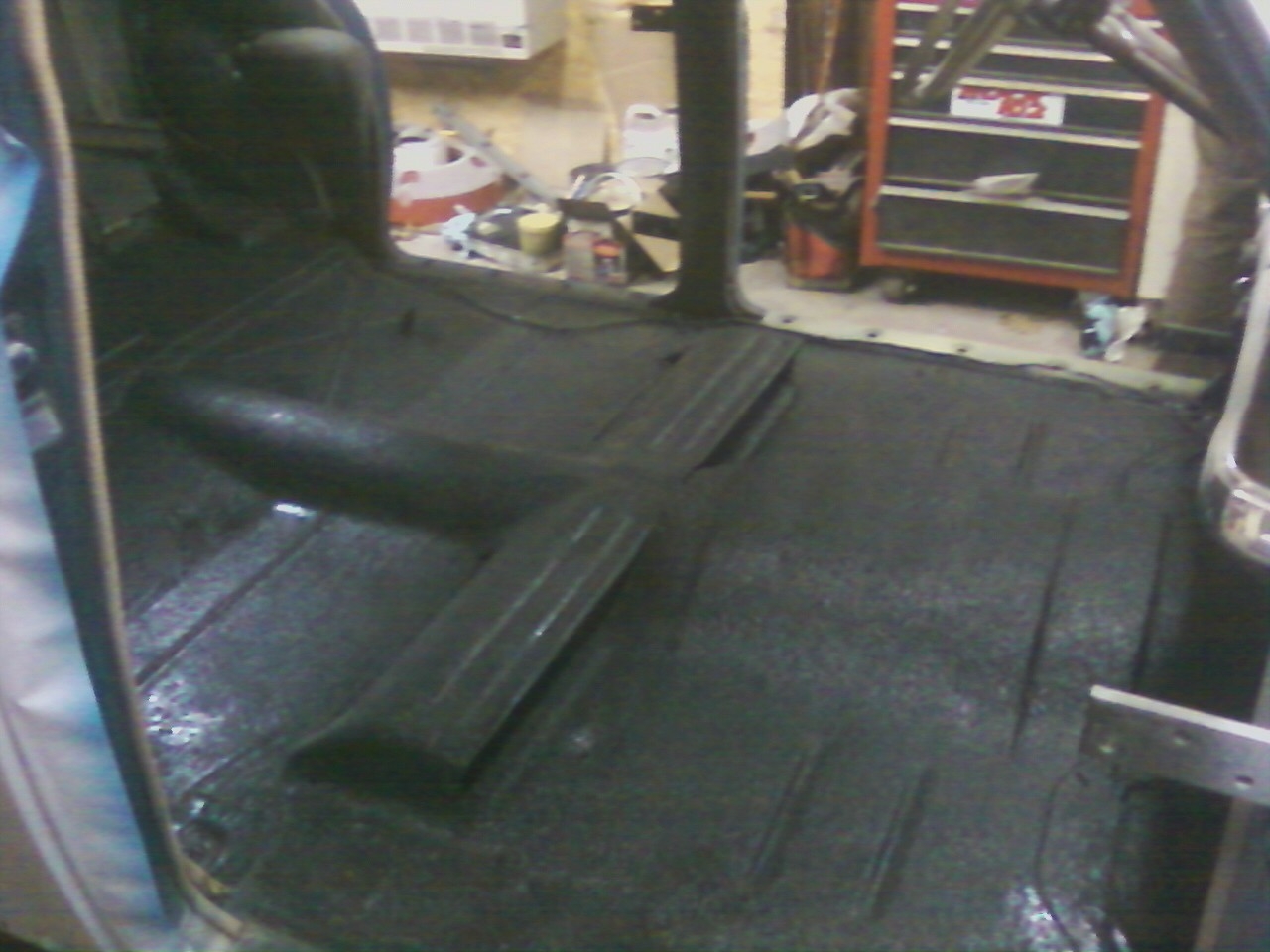

Well we are one step closer to DONE after the weekend. We had a leftover gallon of herculiner so i herculined all the floors yesterday and they came out GREAT! The entire body has ben block sanded and touched up with putty for any issues. The body shell is ready for a second round of primer then paint. We have one rear fender that is still awaiting the first coat of primer. the rest of the body pieces are ready for block sanding. Wehave set a deadling to finish in about 2 weeks. Hopefully that will be feaseable. We are currently trying to figure out how much we want to drop it. looking like 3-4 inches in the rear and about 1 1/2 - 2 inches in the front. heres a pic from yesterday

here is a photo of the finished rhinolined floors. We weren't able to remove a lot of the noise deadener coating that was from the factory. luckily there was no rust under the hard to remove stuff. So we figured if we rhinolined the floors it would all blend in and look original. The floors came out AMAZING and i tall looks like the original coating from the factory.
