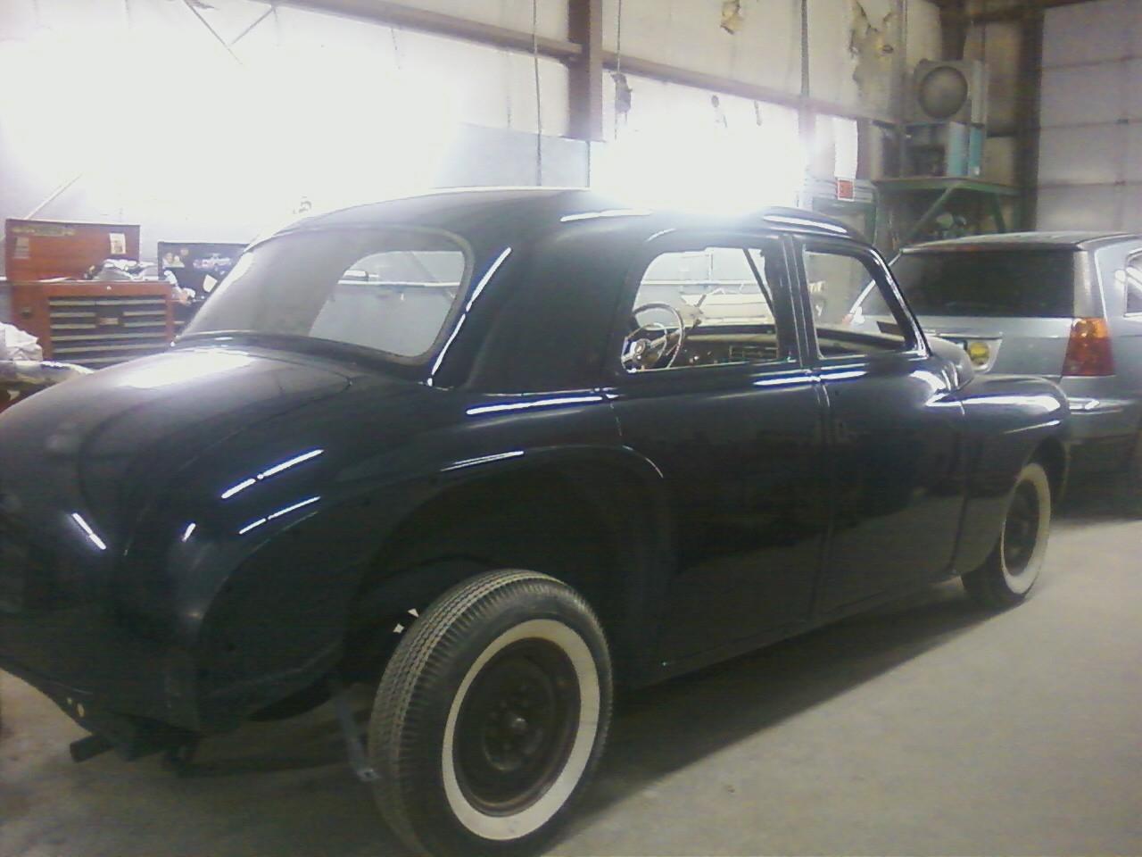

    Here are two cell phone pictures from this evening. we are prepping for paint on the final 3 parts right now. we'll be here until midnight doing it but it needs to get done :) enjoy!

    Good morning fellow HAMBers and Happy Cinco de Mayo!
    A little update this morning: We had some further paint issues last night and we are NOT happy. The last rear fender we had to do had the same chemical reaction issue that we had with the roof.One large splotch on the rear fender probably means we are going to have to strip it back down and re-do it. The body shell and the trunk lid have been sitting, curing, for well over a week in a dry, warm garage. We started wet sanding last night and went to buff it and found that the clear coat has not cured yet and it is now scratchy and ****py which means more wet sanding sometime. The body guys at the shop (who didnt even ***ist in this car) are beyond pissed off and called in the dupont people this morning and i hear theyre out for blood.
    We thought the roof reaction occured due the fact that we mightve put it on too heavy in the middle but now that the same exact thing happened in a big spot on the rear quarter; we are confident that it is most likely a paint issue. The rest of that quarter was fine and the rest of the panels we painted last night were fine when finished. we were ther euntil midnight last night and were expecting to leave happy and excited that our painting adventures were finished and we were ready to re-***emble. not so much now.:mad:
    We're just really frustrated right now since the most expensive part of finishing this car was the paint and the clear. we've seriously dumped a lot of money on the paint and now it's kicking us in the ***. On top of that; the parts we painted last night were supposed to be our last of the painting process.
    It's just very frustrating. the rest of the car; as you can see from the photos: looks KILLER and we are thrilled by the overall look and quality of the color in the big picture of it all. After spending months and months of hard work to prep it and get it perfect, and then dumping a bunch of cash on whats supposed to be high quality paint, and then discovering its ruining it all....just ****s. Well here's to hoping DuPont decides to help us and at least covers the cost of what paint we will need to fix it....not includnig the clear coat curing issues we are having.
    Anyone else have issues with dupont paint?

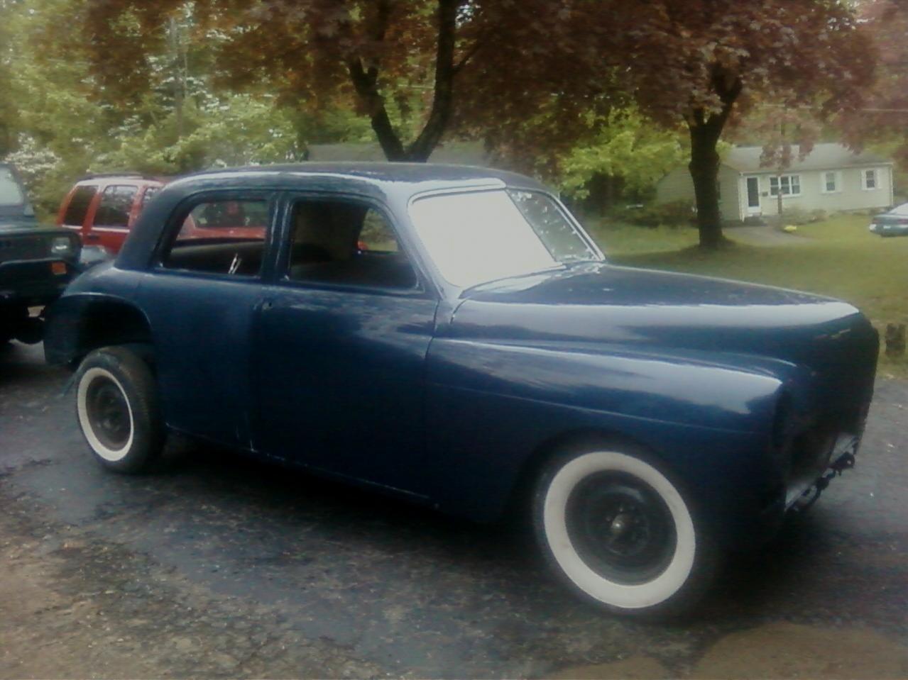

    I was finally able to get some photos last night! It stopped raining for an entire half hour so we were able toput all the seats back in the car! we still need to put one door back on and both rear quarter panels but that will be this weekend's project. I hope you dont mind but we're in the middle of wet sanding and buffing right now so i apologize for the ppoor paint quality right now. Hope you like her!
