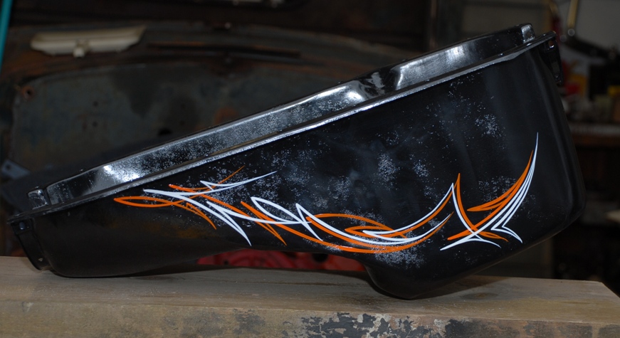

    Here is a pic of the Olds engine and oil pan with paint work by Sinister custom and what I started with on the front end of the Studebaker.

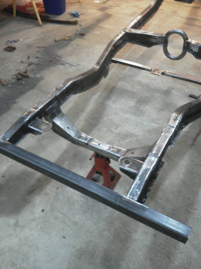

    CGkidd
    Here are the mods to the front suspension to install the model A axle I already had. I removed the original front crossmember, removed the original spring buckets and replaced them with 2x3 tubing. I then grafted in a aftermarket 36 ford front crossmember.

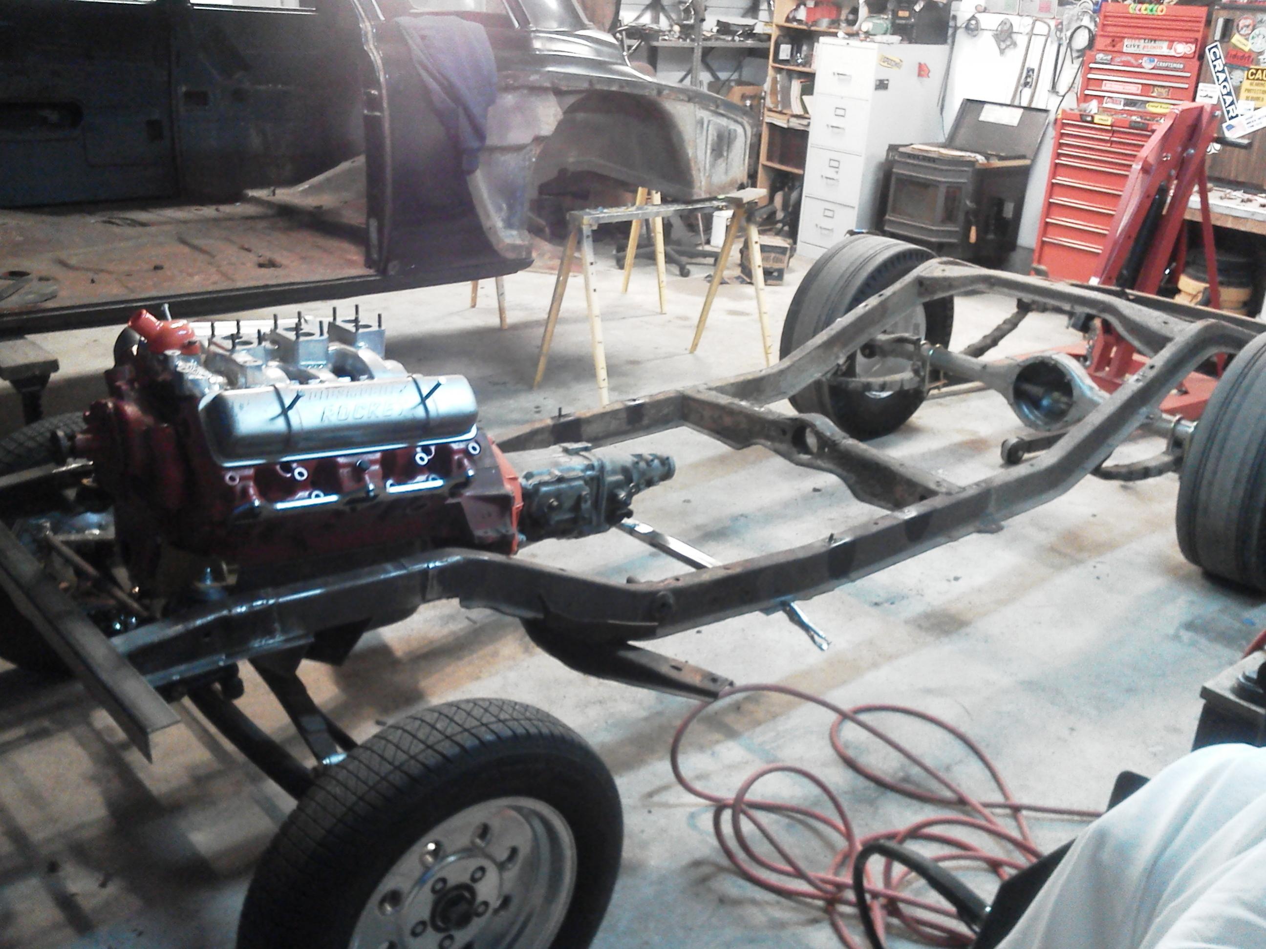

    Mocked up the motor mounts and trans crossmember. Then pulled body off frame to allow frame to me cleaned and painted. Also finished gutting the interior of the body.

    CGkidd
    And this weekend I moved the existing middle crossmember forward 10" and grafted in a loop for a driveshaft safety loop. I also finished mocking up my front suspension. There will be more soon.

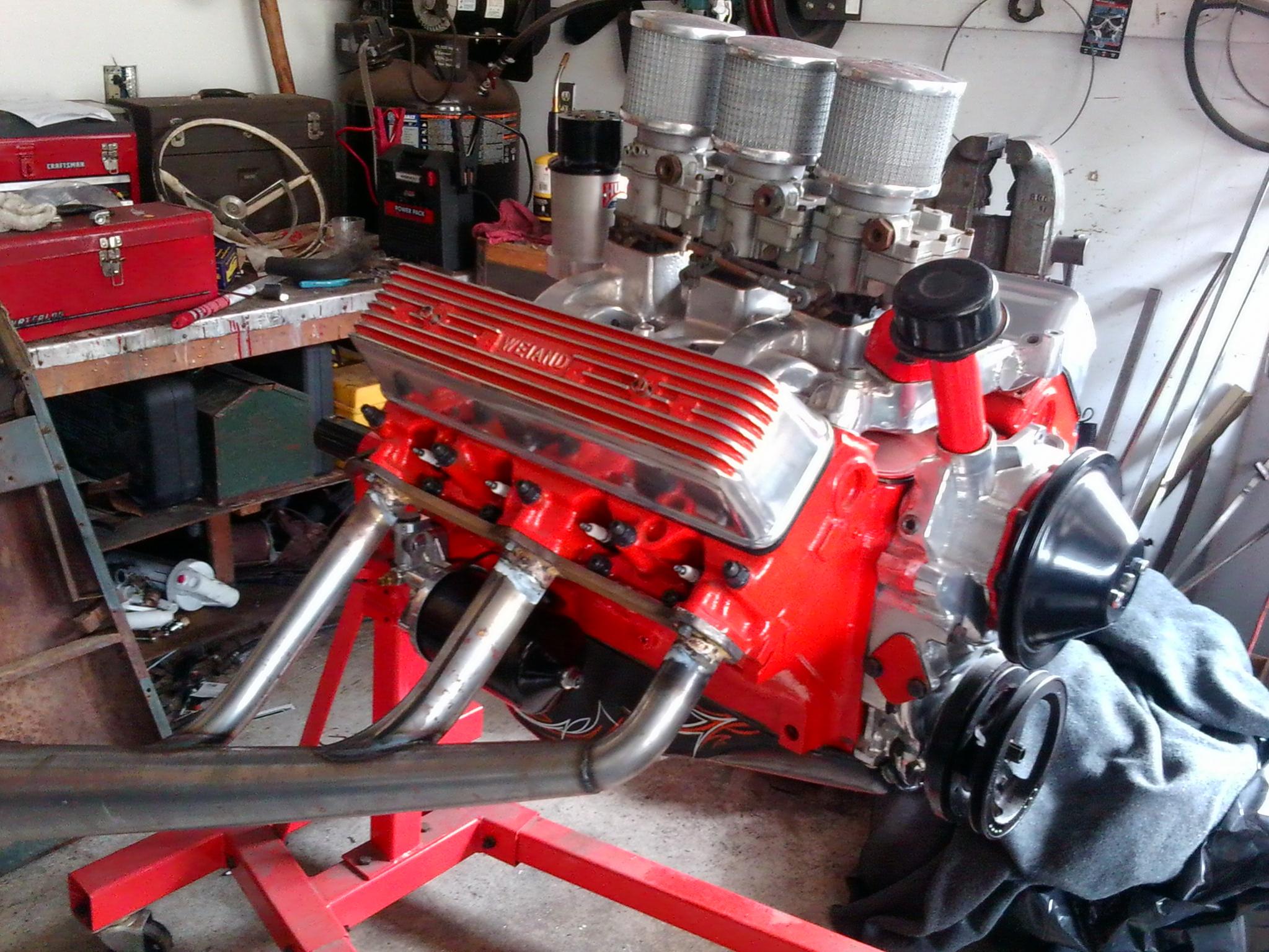

    The specs on the Olds are as follows. 1956 block and heads, block has been bored to 4" with Crower rods for a 400 Pontiac, Isky 505C solid roller cam .505 lift with 320duration, Joe Hunt Magneto, 10-1 forged pistons, heads have been reworked with SBC valves and roller rockers from Ross Racing, Aluminum flywheel with steel facing from Ross racing. I have a Hayes 2800lbs pressure plate.

    What you guys think Tripower pictured earlier or a weiand dual quad with early carters?

    FWIW, the 2x4 WCFBs will make more horses than the trips.
    It's your build, but what that Stude really needs is a poked and stroked Packard V8 with a U-Fab tunnel ram and an aluminum flywheel. The close-ratio Ford toploader bolts right up using an extended pilot bearing. I have one NOS Isky 505C flat tappet cam left. DynoSim says the 505C makes its power 5,000 - 7,000 RPMs; about where the Olds or the Packard loses the main bearings. We could run head's-up and see which one wins the most before it dies. ;>)

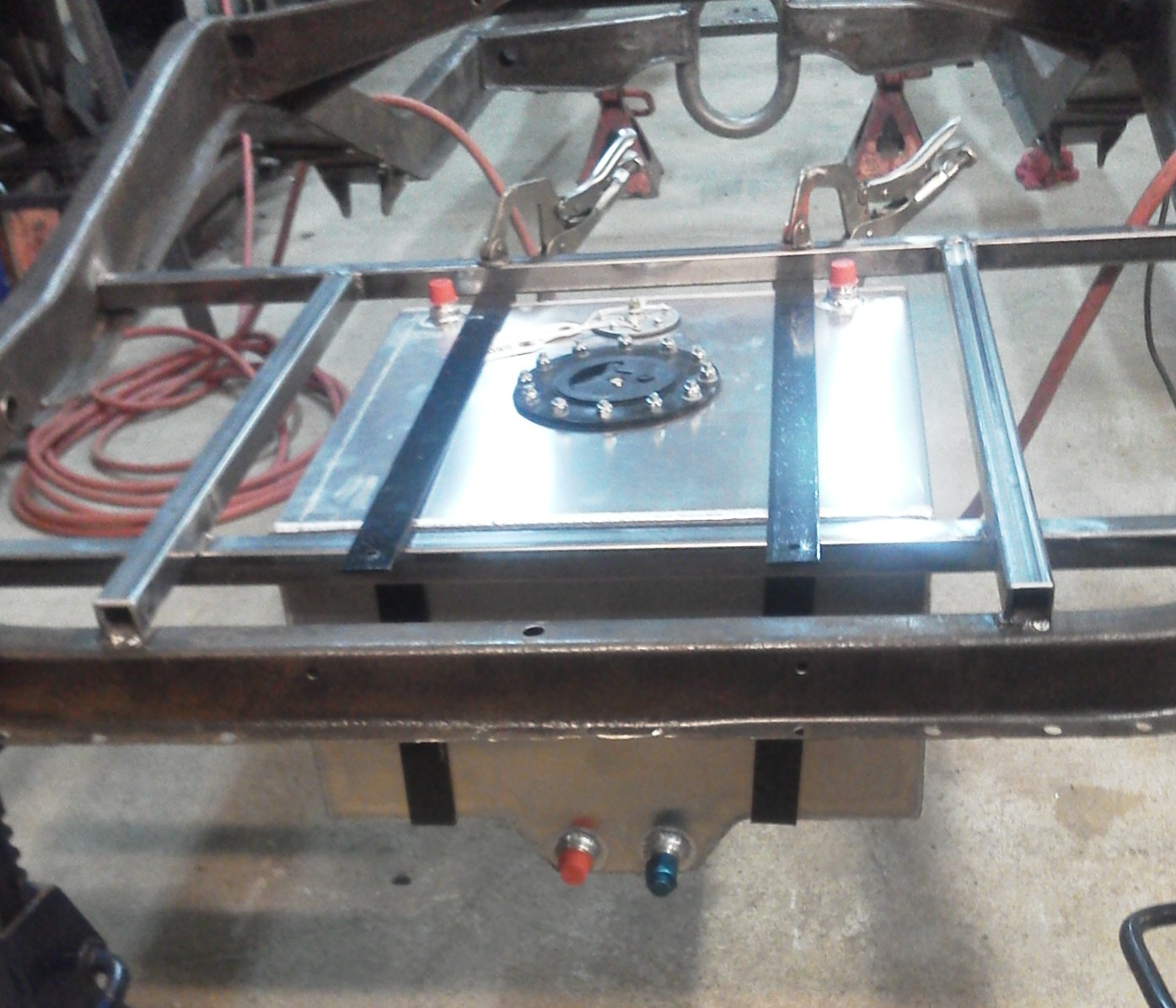

    Well got the frame work for the fuel cell tacked together.

    I think I am going to run the dual quad.

    Good choice! I'd run the dual quads also!

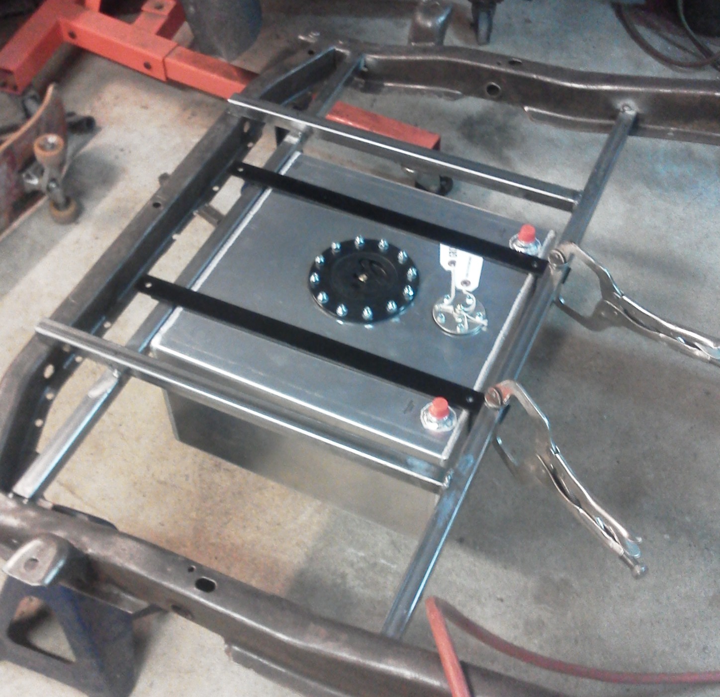

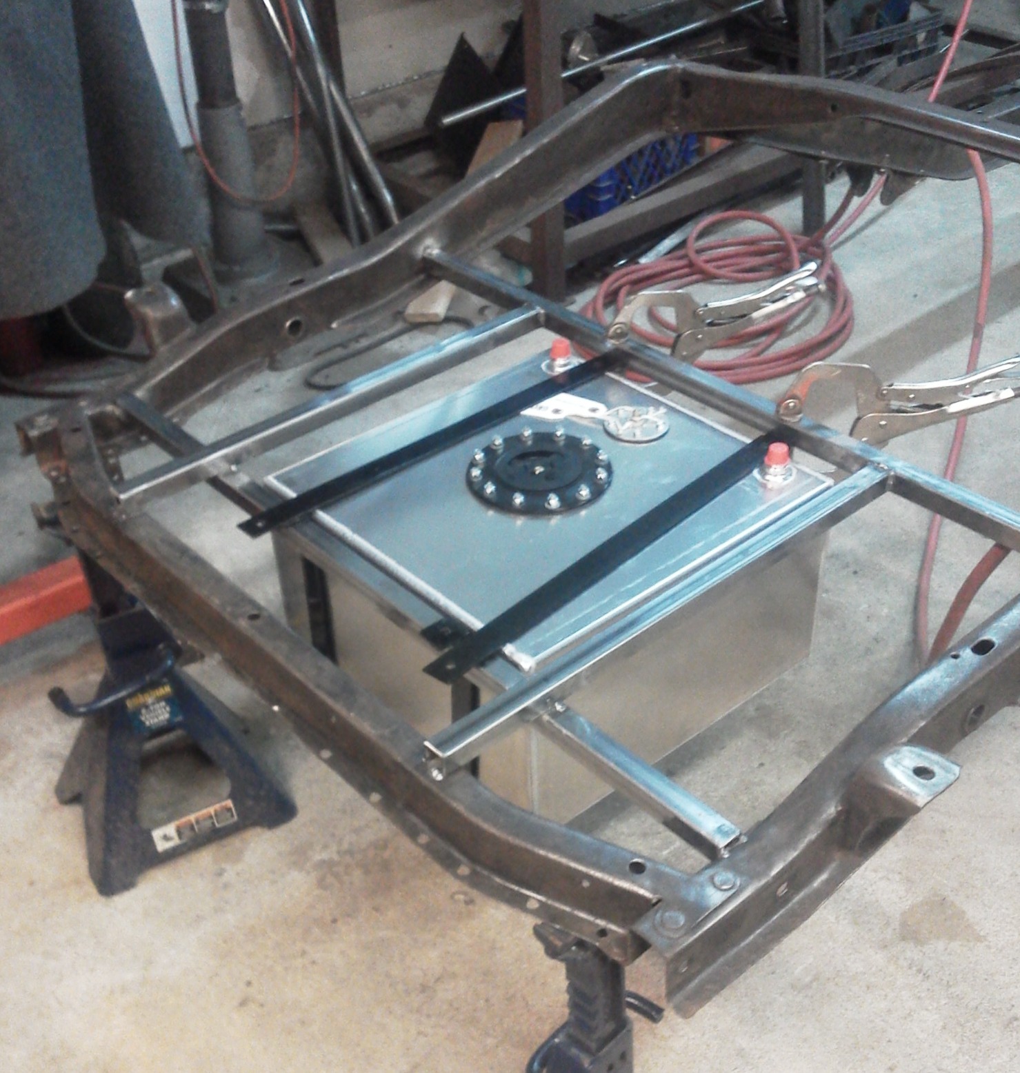

    I got the fuel cell mounted again. After looking at the first mount set up a couple times I decided to move the tank forward a bit.

    Here is a pic from the front showing the new brackets which will also eliminate any chance of the tank shifting side to side.

    Boxing plates are done.
