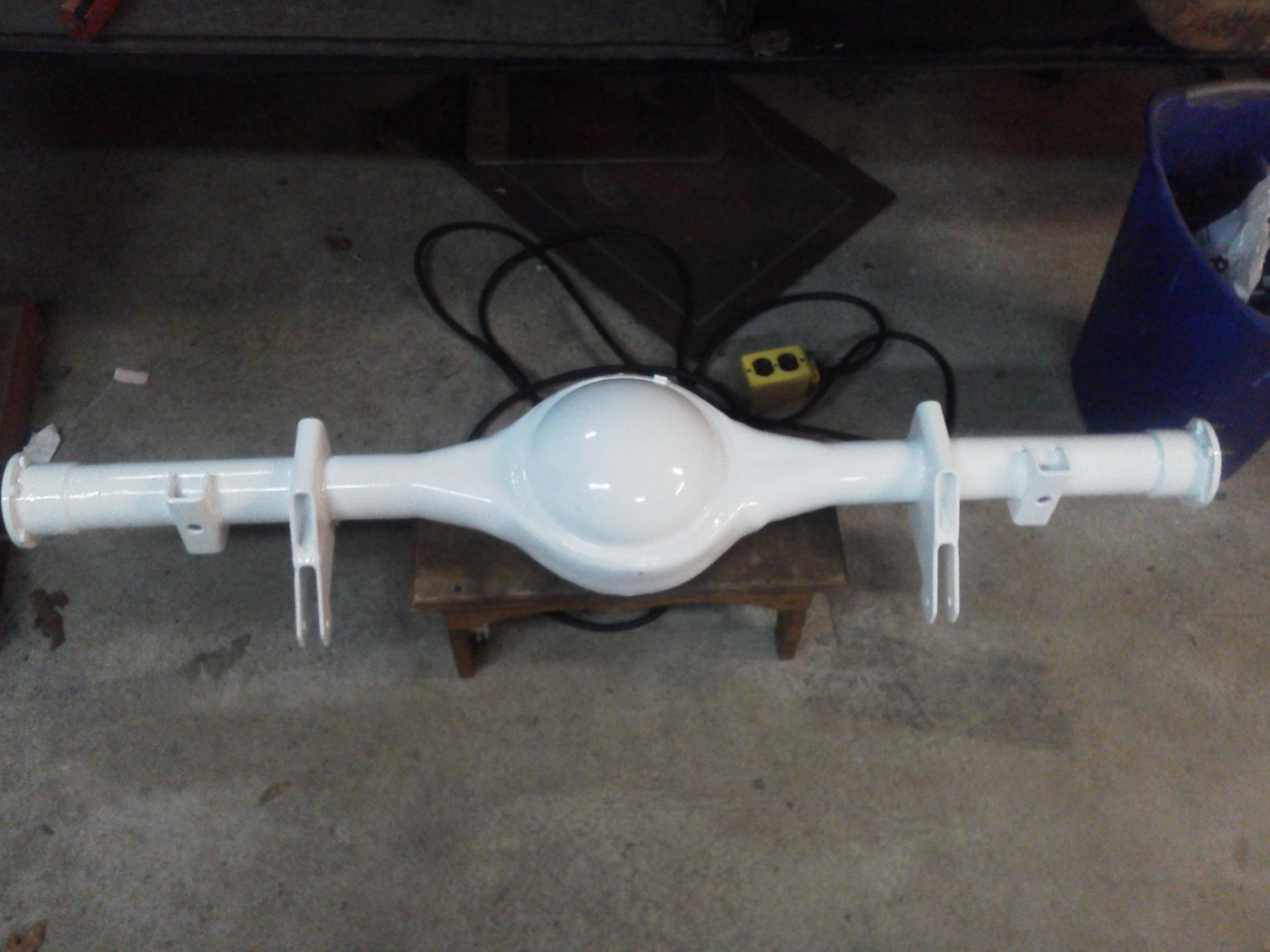

    I got the 8 3/4 housing straightened and powder coated.
  2. J.Ukrop
    Joined: Nov 10, 2008
    Posts: 3,703
    J.Ukrop
    SUPER MODERATOR
    This is looking really good, CGkidd. I dig the gl*** frontend, transverse leaf setup and white powder coat. I'll be keeping an eye on this one...
