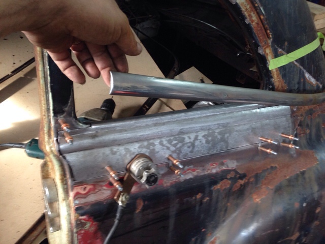

    I finally got a little time to start working on repairing the rust. This is the worst rust besides the floors. Pretty scary ****! ImageUploadedByH.A.M.B.1421294871.737377.jpg this is a bad pic of the rust underneath the belt line trim at the quarter windows

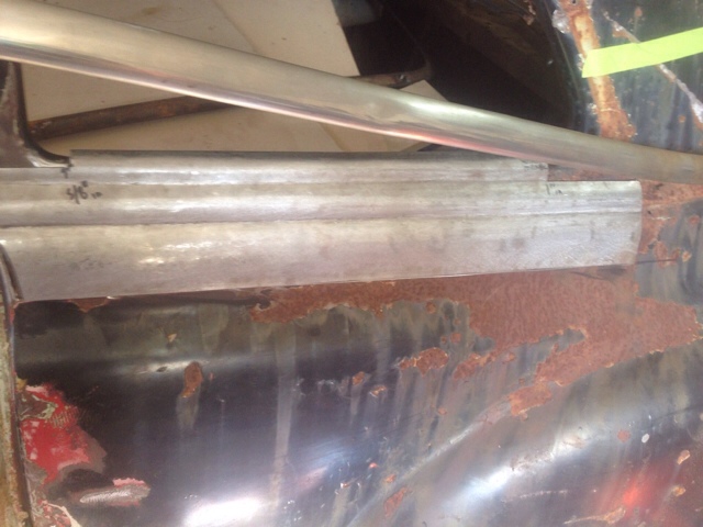

    I started making a pattern to match the section to make a hammer form for a patch panel. I also made some corking tools to help coax the final shape as well as some oak *******s. ImageUploadedByH.A.M.B.1421295308.626242.jpg ImageUploadedByH.A.M.B.1421295464.712854.jpg ImageUploadedByH.A.M.B.1421295484.526351.jpg ImageUploadedByH.A.M.B.1421295505.775986.jpg ImageUploadedByH.A.M.B.1421295530.709421.jpg ImageUploadedByH.A.M.B.1421295555.026718.jpg

    Here's the patch, it's not quite finished and the belt line is slightly larger than the original. I will try to fix it or do a new one, but overall I'm pretty happy with it. As you can see I need to stretch the metal in the center to make it straighter. ImageUploadedByH.A.M.B.1421295814.495506.jpg ImageUploadedByH.A.M.B.1421295834.078877.jpg ImageUploadedByH.A.M.B.1421295848.628749.jpg ImageUploadedByH.A.M.B.1421295862.345308.jpg

    Fitting up the patch panel needs some tweeting and persuasion. ImageUploadedByH.A.M.B.1423026014.170982.jpg ImageUploadedByH.A.M.B.1423026029.737865.jpg ImageUploadedByH.A.M.B.1423026047.321043.jpg ImageUploadedByH.A.M.B.1423026069.554399.jpg

    ImageUploadedByH.A.M.B.1423026145.104708.jpg ImageUploadedByH.A.M.B.1423026167.037445.jpg ImageUploadedByH.A.M.B.1423026205.520960.jpg
    Tacking the sum***** in. I had to stop here. I'm going to hit it again tomorrow. The plan is to get all welded and finished with the exception of the rear window corner. Once I chop it it's going to get cut out anyways. All in all I'm pretty pleased!

    ImageUploadedByH.A.M.B.1423106404.741028.jpg ImageUploadedByH.A.M.B.1423106419.440672.jpg ImageUploadedByH.A.M.B.1423106430.307277.jpg
    Well, I got the patch welded in. I think my panel gaps were too tight. When welding, the patch sunk in slightly and there is a little bit of a "step" between the original metal and the patch. My original hope was to use as little body filler as possible. It looks like I'm going to have to use some filler to even this out. Hopefully by the end of this project I will be a decent welder lol. The panel is a bit lumpy also, a little bit like Roseanne Barr's ***. A skim coat should take care of it.
