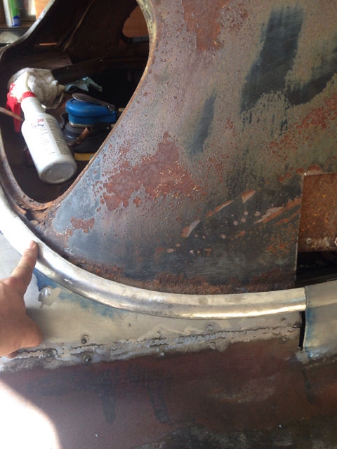

    ImageUploadedByH.A.M.B.1426452611.768018.jpg ImageUploadedByH.A.M.B.1426452625.000886.jpg
    I little bit if folding around some square tube to make the channel.
    Marked off where the patch will be. ImageUploadedByH.A.M.B.1426452722.184096.jpg
    And cut it out

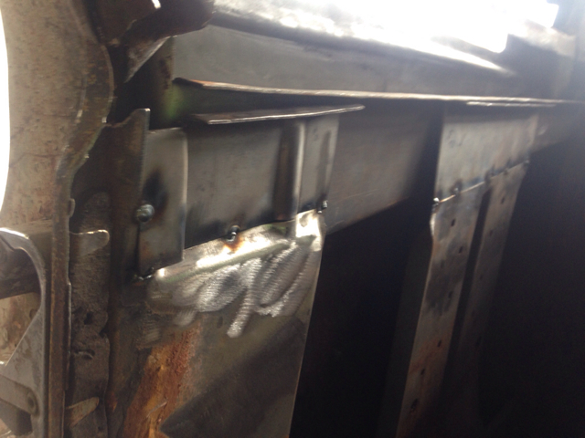

    Then made the top couple inches if the bracing that will need to be replaced. ImageUploadedByH.A.M.B.1426452784.934898.jpg ImageUploadedByH.A.M.B.1426452798.550914.jpg
    Tacked the braces in but I need to redo the one on the left as the flange is at an off angle.

    Finally got away from work and snuck into the garage for a little it today. I finished welding in the braces and the replacement inner window structure. Welding this was a ***** because the sheet metal was so thin. I blew a lot if holes in it and spent a great deal of time filling them up. I didn't spend much time trying to metal finish because I was worried about further thinning the ironical metal and also because it will be covered by the garnish molding. The body is so much more rigid and solid now. The pics **** due to the light coming in. ImageUploadedByH.A.M.B.1427857814.388619.jpg
