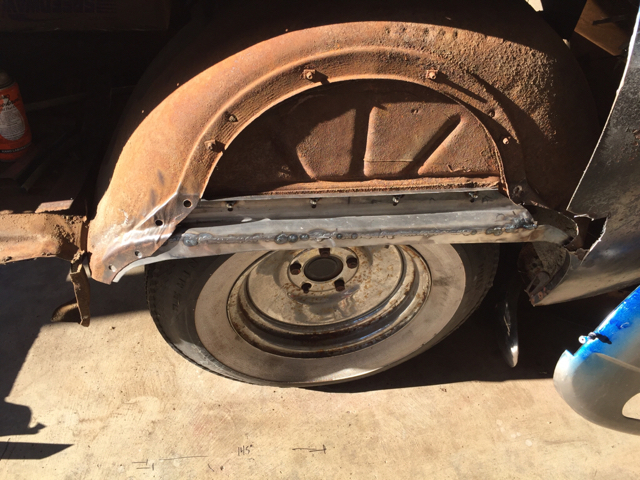

    ImageUploadedByH.A.M.B.1445220778.038069.jpg i reworked the brace to fit the contour or the wheel opening better. I should have taken more pics but basically made a reference line parallel to the ground and traced the contour to a cardboard template the template was cut out in sheet metal and the reference line was transferred. This made it easy to get the position accurate. Can anyone tell me if the inner wheel opening lip gets folded over the inner fender lip like a door skin, spot welded or does it get held in with seam sealer or other goop? Thanks

    I'd love to be able to tell you, but unfortunately mine were made out of sponges, newspapers, fibergl*** screening, and that was all behind the wall of bondo. To be honest, before I read your posts, I didn't even realize there was a supposed to be a brace back there.

    That's crazy. I can't really imagine someone actually trying to fix something like that but it happens all the time. The brace basically connects the front if the wheel well to the back and has a little flange on it to support the wheel opening that's about 1/2" wide. The actual wheel opening has a corresponding flange that Tia sits in plus an extension that is bent almost 45* up an into the wheel area. That's the part I'm not sure gets folded over. I am actually thinking it doesn't get folded but am trying to figure out how the factory attached the fender here.

    Thanks for the info, I'll look into it as well and see what I can find out. If you think my wheel openings are bad, my rockers are truly next level. Pretty much the entire panel is filled with expanding foam then covered on bondo on each side. However, there are places where aluminum flashing was pop riveted to the bondo and fibergl***ed over. I'm kind of like you on this one. I'm not too worried about messing it up, because anything I do to it will be an improvement.

    On my 51 it rolls over and is spot welded through, I was lucky and mine are not that bad at all. I just took the inner removable wheel well covers off and removed mounts for fender skirts from them so they wouldn't cut the tire, shome how I manages to squeeze an 8 inch wheel and a 255/60 in the rear wheel wells with out having to even mess with the lip, and no rubbing either.
