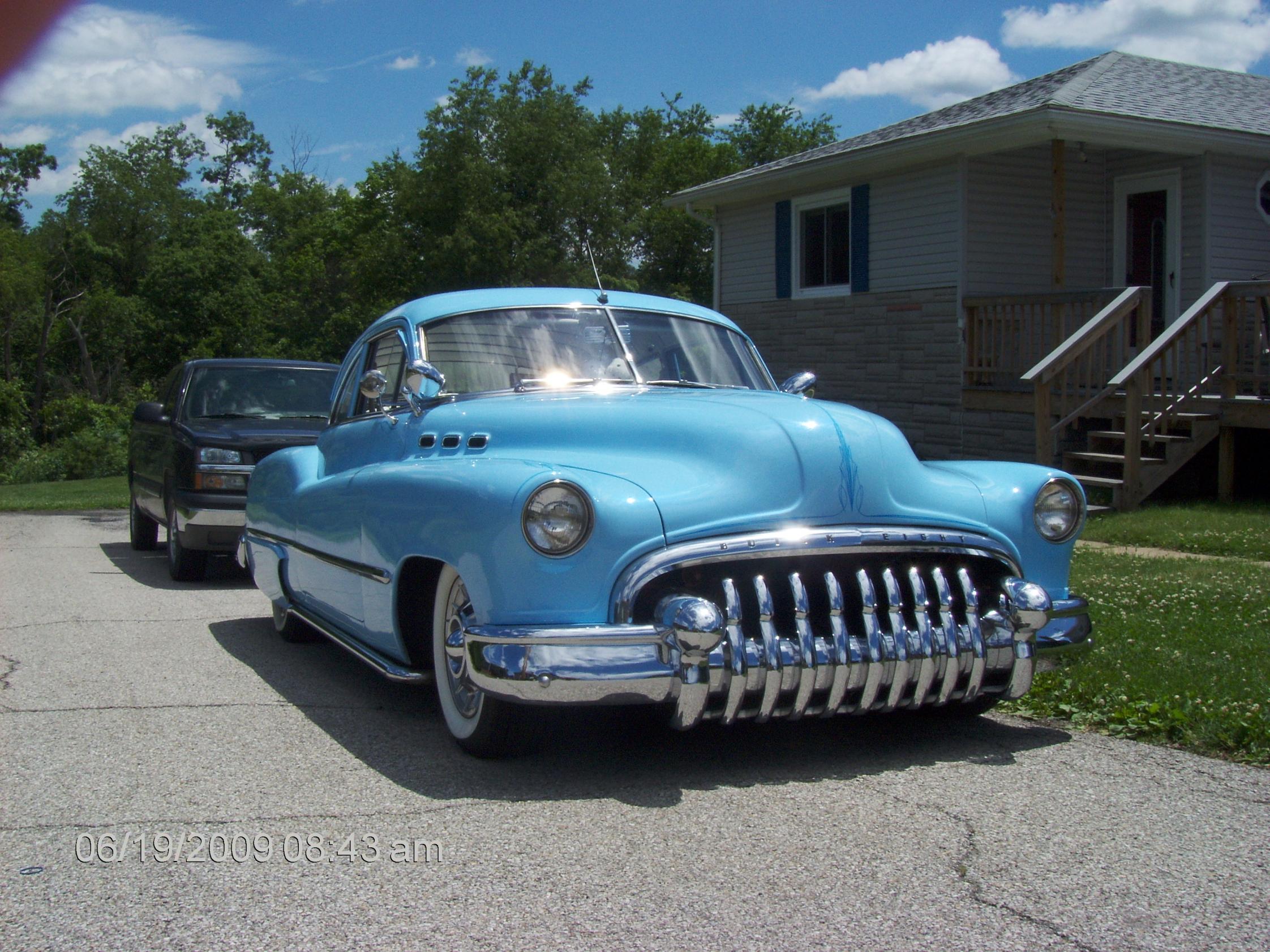

    so today i accomplished some more. none of which is "finished" but it gets me to the next step which is closer to being "finished".
    cut the door tops to make them longer. found that there are no pieces with the same profile. so i had to use the closest piece and will later have to add the raised lip to it. should not be to difficult to do...
    welded back on the door. it fits quite nice. the door needs some adjusting so the gaps are not all equal. that will be handled later on though...
    also got the rear quarter window radius's welded in. found some lead on the driver side, so i did the best i could and will have to go back to it later as well. at lease all 6 roof supports are welded in place...
    profile shot with door tops and rear quarter windows complete. i am really excited about the overall look. cant wait to wrap up all the rough work so i can go back in and hammer out some details...
    and a quarter view cause now the pics are starting to show it more how i see it in person...
    tomorrow ill try and wrap up the A pillars so that i can start getting the glass cut and reinstalled!

    so a quick update for the night. was my buds b-day so i had to cut it short today.
    got did some minor welding and lots of blending...
    got the driver door far enough for some black spray paint (i will be painting the car one day so i dont want to wast a lot of time, just want a solid base for when that time comes)...
    also got the doors' garnish moldings welded up...
    measured out the glass for its cut too...
    tomorrow (or today?) ill get the other door up to black spray paint and hopefully the B pillars to match. i want to see it all in black so i can focus on the back glass a little better.

    close up of door top, i had to make the raised area from when i extended the top back...
    close up of door front & A pillar drip rail, its just about seamless...
    began prepping the windshield for its haircut. i plan to do it myself...
    the ladies that keep distracting me and my windshield just about ready for its trim...

    sorry for the dark pic, its the inner C pillar, i redid some inner structure and skinned the face. will go back later and blend it as well...
    working the roof, doing my best to match the 2 halfs...
    its not bad at all, still will require some more work...
    rear quarter view, the rear glass moved forward about 3" which is great cause i plan to later extend the rear fenders slightly in a slope, ive always thought this car had too short of a trunk...
    got the glass centered as can be, measured about 15 times both outside and inside the car...
    notice i lined up the belt line trim, ill have to later modify it to contour and trim it at the front. this was one of my goals that im glad to see im meeting. also notice how the drip rail falls right into the back window trim, lots of times these type rear windows end up under or just at the belt line trim after a chop. i like to keep the car appearing stock...
