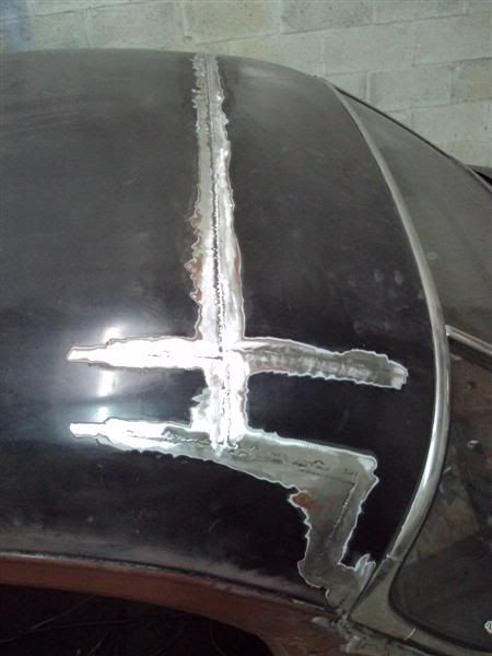

    hand formed the inner trunk to bottom of window structure, actually did it with a hammer and a vice. will get painted before the sail pan goes on and later finish welded from inside the trunk...

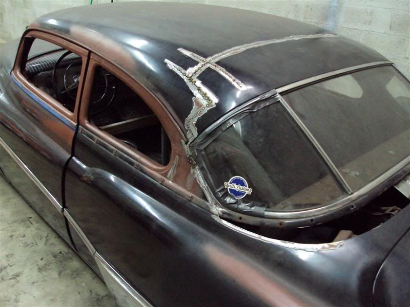

    worked out the cuts to allow the 2 roof halfs to flow properly at the sides. this took a while but its darn close. some lead work is definately scheduled for the future...

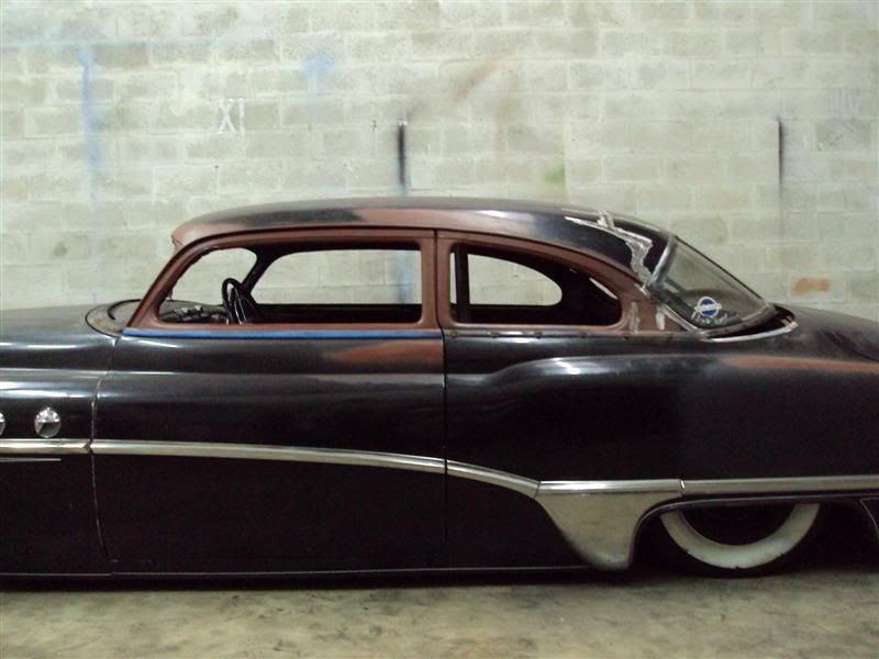

    the roof profile, very similar to the stock one, which i dig...

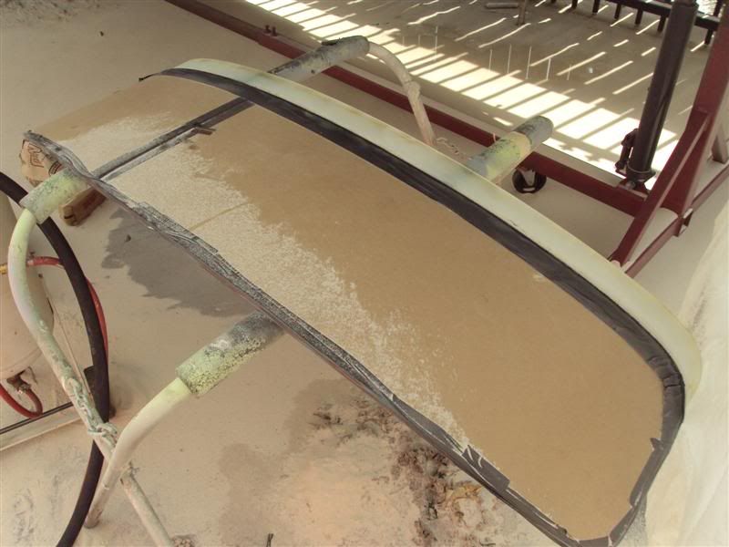

    so i got to blasting this morning! after replacing the sand and getting a handle of things it was a smooth operation. took me about 3 hours to cut the glass...
    tiny cartoon windshield. maybe someone will want to buy this for there 10" chop...

    no magic tricks. like everything your finish is all in the prep work! template is key to getting it right. 3 or 4 layers of duck tape to make the edge as precise as possible. cover what you dont want blasted and protect yourself too! regular ass standard sand that my bud had next to his sandblaster. i went through about 4 50lbs bag fulls. pressure was always changing cause the hose didn't have a regulator on it and had some leaks, not the best of working conditions but hey i dont have a blaster or compressor of that power. i move all the time side to side. just like mother nature erosion will take its course. once i got to the film from side to side i flipped and did it again. a razor blade and the glass was cut. i went back in and got the edge a little cleaner with the blaster on both sides. just trying to get closer to the tape edge. later ill belt sand the edge a little smoother and rounder. i test fit it in the car with no seal and its looking mighty good.
    hope that helps you guys out!

    also got to 95% finish welding the roof section. ill tackle the pinholes tomorrow from inside so i can see where they are. there will still be a lot of hammer and dolly work to get it better and of course the lead work later on, but its not far...

    A quick question..... how are you going to tidy up the welds between the belt line and the sailpan without actually digging into it? That's the one thing that would be the most challenging.
    Maybe if you could also illustrate with some close up photos??:D Cheers.

    that sir will require my steady hand and patience. :D i might bring out the tourch? im sure that would make it a lot neater, but i havent practiced in a while my oxy asced. we'll see.

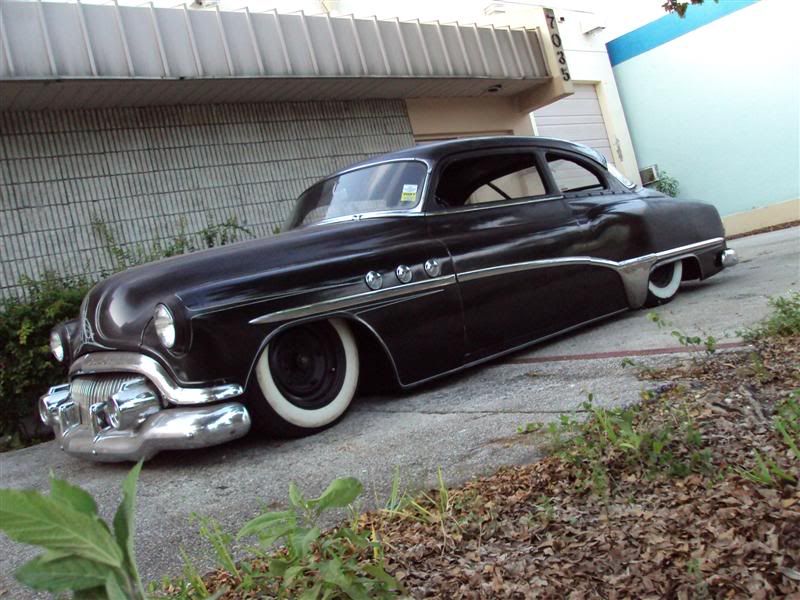

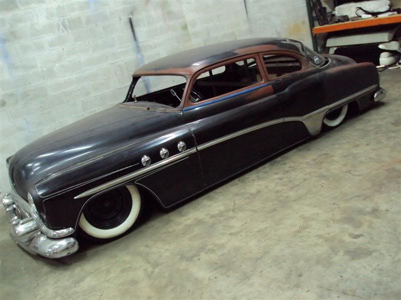

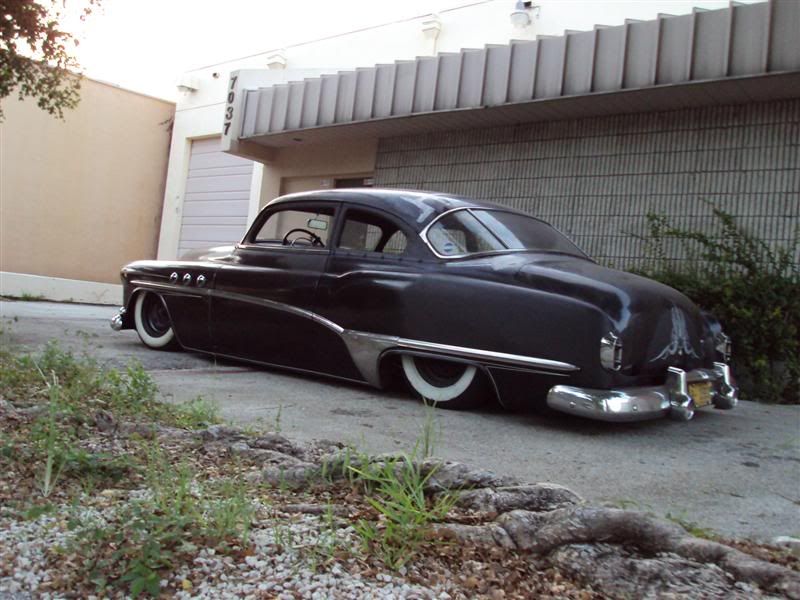

    well its not done, at all. but here are some pics from yesterday. i took it to the local meet and it was great! some guys didnt know what happened to the car they just knew it looked better. i heard one guy comment to his wife that i was simply doing some rust repair. guess the 2" haircut went unnoticed to him. those that know my car commented that "Buick should have built it like that!" so this week will be much much slower progress but progress none the less. will finish the sail-pan and begin on the vent windows so i can install more glass.
    hope you all enjoy the pics,
    Yaril
