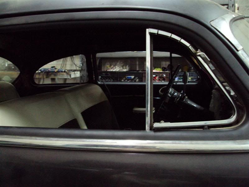

    alright, so i got to looking at the vent wings... the bottom of the wings are to stay the same size so the door glass isnt longer and passes the kinck. the top of the wings are actually shorter cause the top moved forward about 1.5". so anyone have any tips on how to chop these down to size now...
    vent wing in frame, need to keep width and top piece to follow door top...
    here you can sorta see the factory kink that separates door glass from vent wing, also notice how the bottom kink is further back (stock) and top is forward...

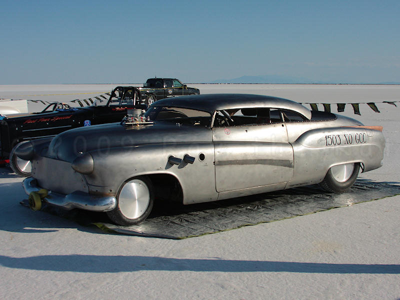

    thank you guys for all the kind words! i am going to get back on this car soon so i can wrap up the bit that is left to finish. thought i would share this with yall...
    so i got a box from Moscow, Russia today! iv been waiting for this box for a couple weeks now and was beginning to think it was never going to get here. even the mail man was excited about delivering Russian mail to my house. inside the box was a typical Post Card and 2 wooden doll key chains, very typical of Russia. however what i wanted to see was that which isnt so common of Russia, a car magazine called... "Ranflas". granted i can not read a damb thing in it other than my name, which some might think that is also Russian.
    so, if any of you are interested in a copy of this magazine that features my 51 Buick B.C. (before chop) and my old 64 Bellflower Ghia; please let me know asap so that i can order extra copies. it will take a few weeks for delivery for obvious reasons so the sooner i have a number the sooner i can place the order.
    1 magazine will cost $10 including shipping, thats from Russia to me, then from me to you.
    thanks!

    sorta getting back into the Buick... worked out both vent / wing windows. trying to get it "back together" so i can circulate it some more while i wrap up the other mods.

    Man, You've got a knack. That window vent chop was made to look easy by you. That's going to be the sweetest buick at TRR. Thanks for the Chevy 51 dash paint help.
