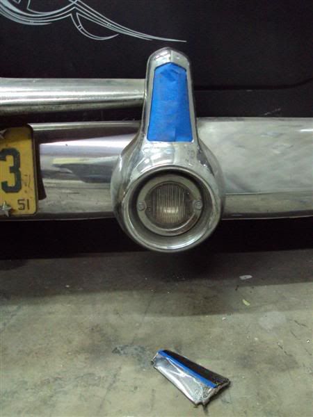

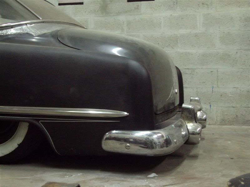

    over the weekend i was able to finish striping the roof to bare metal. also got the front windshield out again for more refining...
    worked on shaving my taillights.
    i worked with the bumperetts until i found a design that best complimented the bumperetts and the car. my original idea was different than what i ended up with but thats how it goes sometimes...
    original idea:
    the design i ended up going with (there is no need for a "frame"):
    drilled the 4 corners, larger at the bottom than the top so they would be radiused, blue tape is just to better see the shape:
    made some inlays to fill the old taillight holes. bent them over a pipe and welded them in:
    a quick skim coat of bondo and some red primer:
    lastly some black from a can for a better visual:
    im very pleased with how the back is looking now, i will not slope the quarters like in my sketch, they finish nicely and follow the trunk slope:
    next ill go hunt some clear red lucite to make my lenses. i want to recess the edges so the lucite is flush with the bumperett.
    till then...

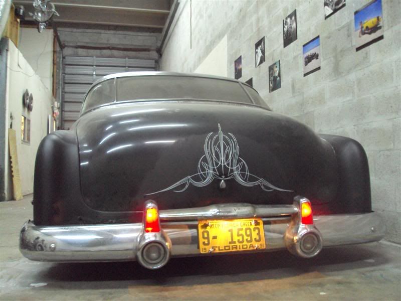

    well, thats it for the taillights. only thing ill do is swap the bulbs for those "LED" style bulbs (suposed less heat i dont want melt the lenses). im very content with the overall look and when i make my final set of lenses they will be even nicer now that i got to practice. yeah these are only "practice" like a sketch.
    its amazing how much work goes into this what in the end appears to be not much. mean i love the look but its very simple yet so much goes to making it look, simple. things are taking shape and the final picture is getting closer. only 1 more body change i want to make, that is fabricate some "flush" skirts, oh and remove that awful trunk key just sitting there by itself, its got to go.
    my ass never looked so good...

    thank you guys. i am going to use kitchen ceiling tile plastic that will distort the LED pattern. going to break a piece off that is over a cabinet so it wont be noticed. haha yeah my kitchen still has those.
    the above pic is with running lights using reg bulbs 2157. im hoping the LED will be brighter and not get hot. the plastic will hopefully make the entire lense glow rather than having a hot / bright spot.
    thanks!
